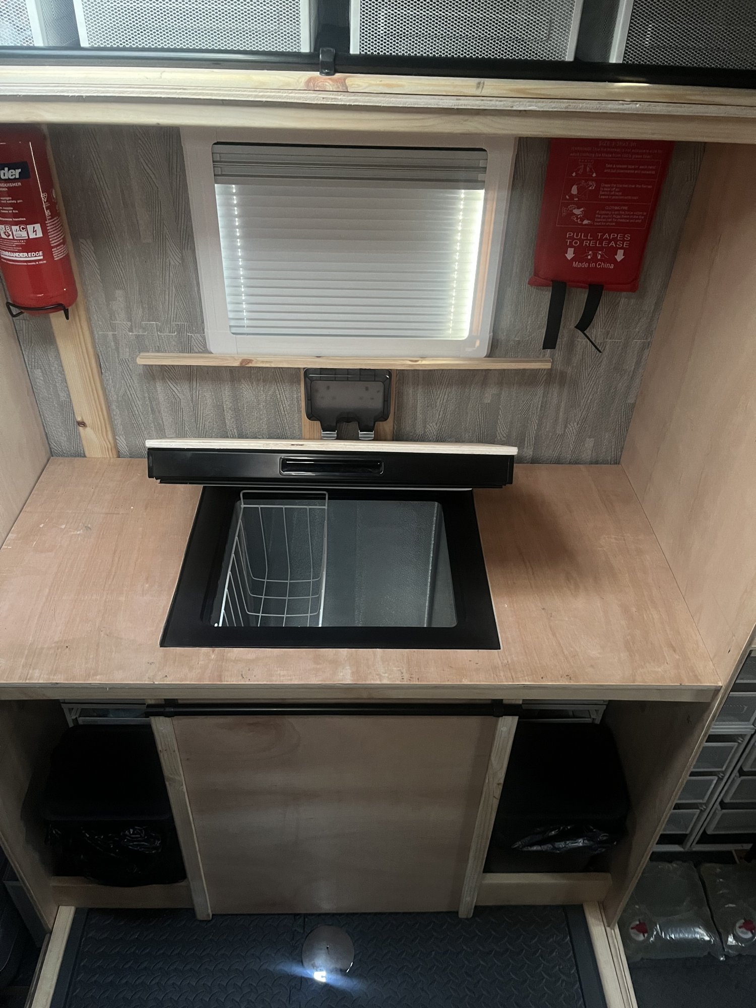

I’ve had 3 way 12v fridges in the past on all my Livaboard vehicles.
THIS time I bought a standard House slim line Chest freezer BUT with a Fridge function dial that I run from the inverter.
Cheaper to buy, Bigger Capacity, ‘I’ find it better to run & being a ‘Chest’ type Much more efficient I feel, as all the cold air you’ve painstakingly harvested the power for to create STAYS in the space when you ope the lid instead of Spilling out.
Works for me.
Works for me.
I can see the logic of the chest type - can't accommodate that though in our van

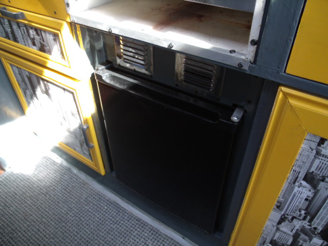

Fwiw, Paul fitted a Adventurer 12v fridge in Demi for me. It was a faff getting the 3 way out . But that was only because of the way Adria fitted it. The Adventurer went in, no problem as it’s virtually the same size as the Dometec it replaced.
Yes I know that I have plenty of power in the van, I’ve not turned the fridge off since it went in. The only downside I’ve found is the freezer only gets down to about-5. There’s a chest freezer in the van, so that’s not a problem.
Strange thing is my small fridge has no open vents and is sealed, but i put 2 vents above to let air around it which may stop mould or damp.
