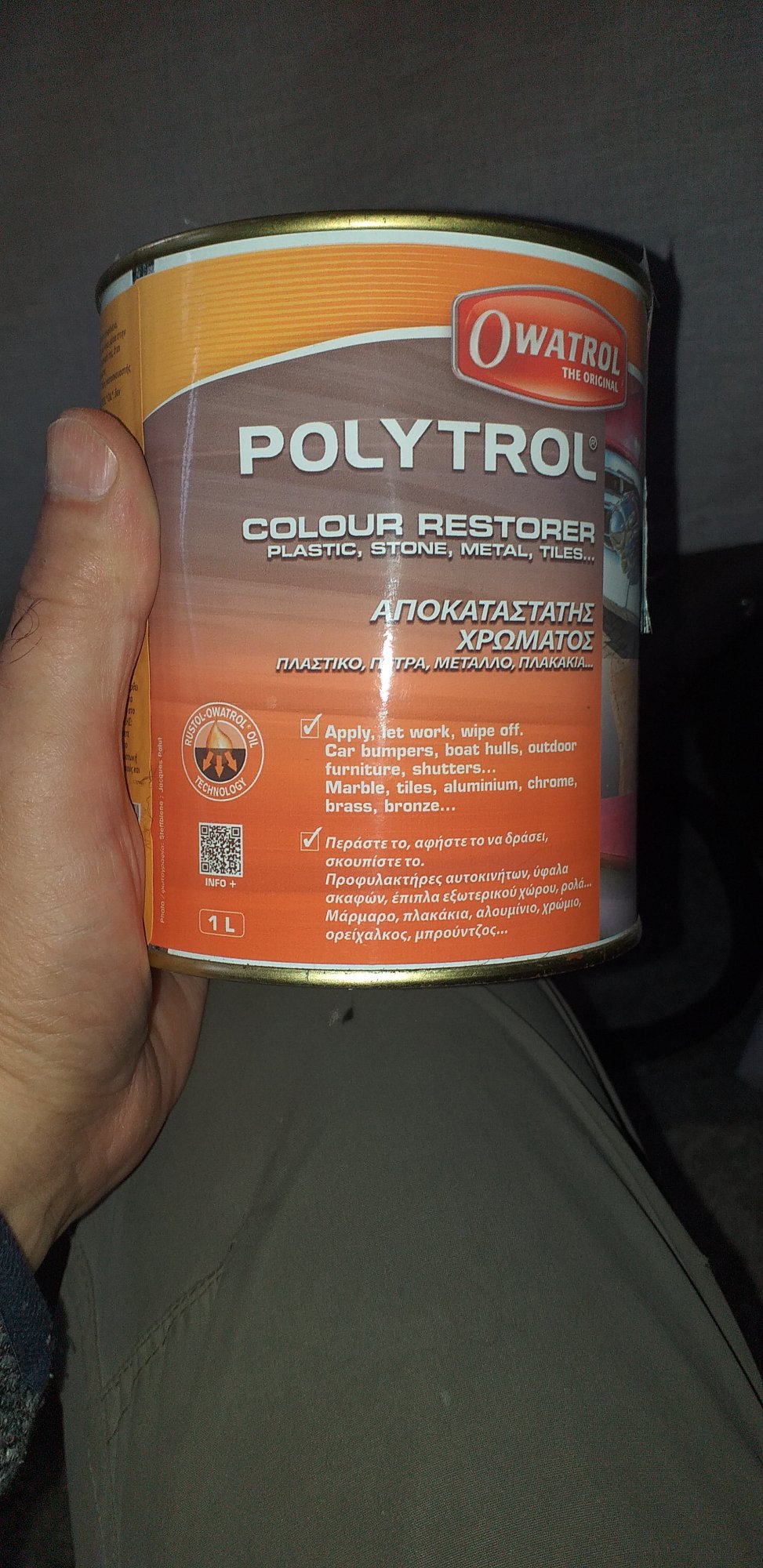

This is what I use, recommend by the late great Wintonian.

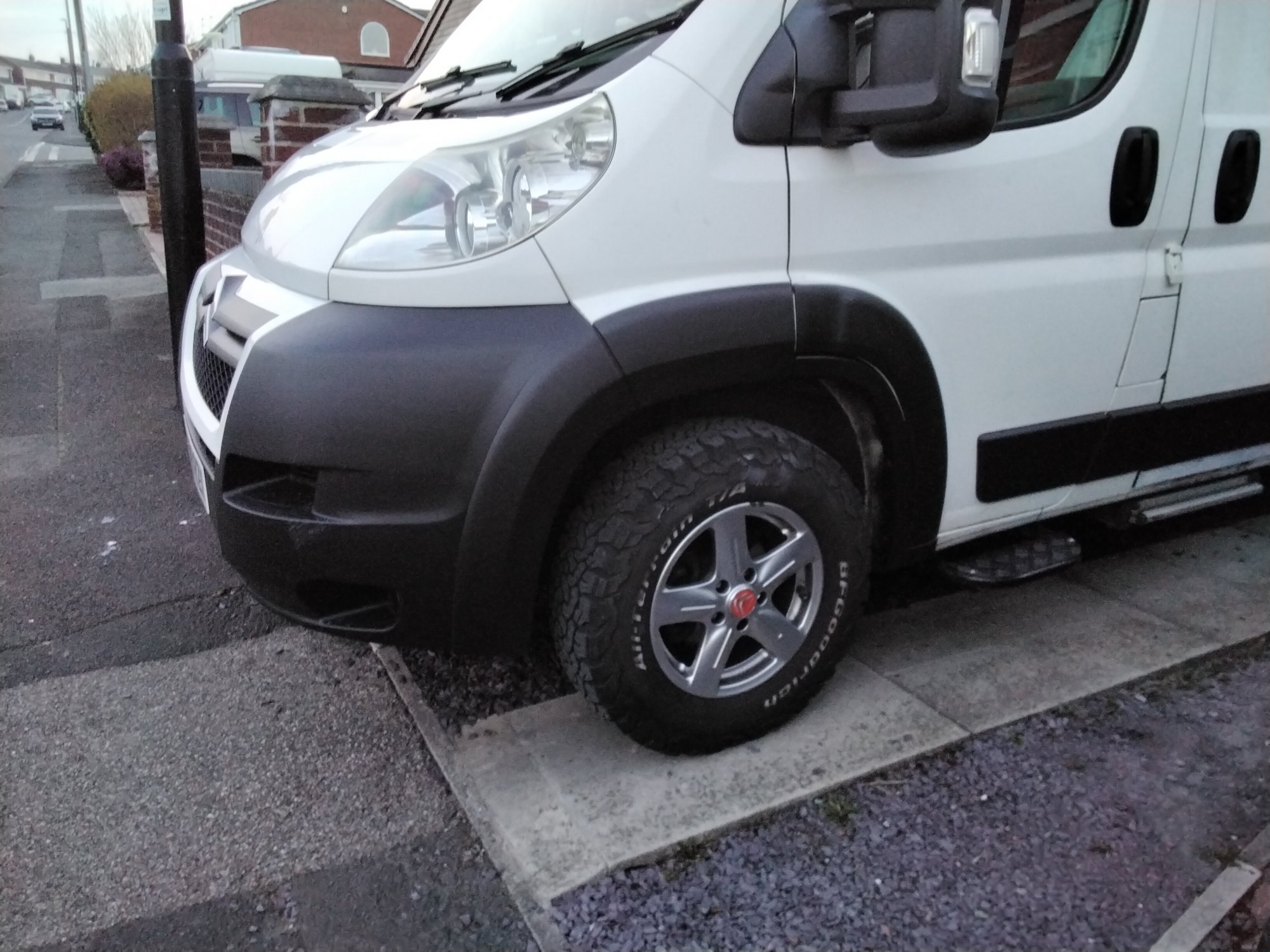

All my plastic was different shade of grey so I had the lot sprayed satin black sorted .
This is the approach I would go for as well (y)
Needs the right products to get right, but once done, pretty well maintenance-free same as the standard paintwork :)
