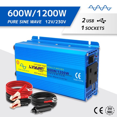

Hi all, I'm in the market for a 5/600 watt PSW Inverter, there's a loads of them on line.
Can anyone suggest a relatively low cost one, for very occasional use.
Chris..

I have experience of this one.
Although rated at 600W continuous it drove a toaster with a genuine 800w load without problems. Standing current was slightly high at around 1A but if you're simply connecting and using it then that's probably not going to be an issue. I wouldn't use the ciggy plug for loads of 60W or more rather connect directly to the battery instead but from what I can remember it did consume a slight current even when switched off (not unusual) so best to not leave it connected if you're laying up the van over winter.
Loads on ebay and temu, what are you wanting to use it for, always go about 20% above the power rating on load.
Must be connected direct to battery, never a ciggy plug.
Many thanks to both of you. merl & trevskoda
I've taken the plunge and bought a
Lvyuan, I'm only using it for a fridge and TV very occasional.
Thanks again same price £60.00..

Hmm, hopefully it'll work for you but compressor fridges pose a very high surge load for a fraction of a second when starting up. Ultimately it'll either work or not but if not then you'll have to send that one back and buy something bigger. Fingers crossed🤞
