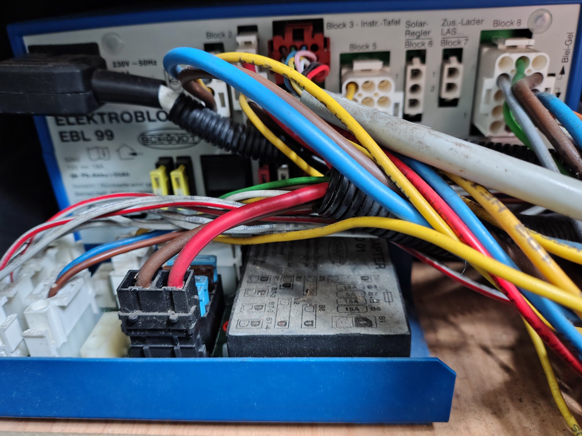

Another great idea, thank you. I've also made up a lead that plugs into my ehu socket on the MH and that I can plug into the DELTA2 to power the 240 volt sockets in the MH. I read somewhere that I need to switch something off on the electro block under the passenger seat, or it would drain the delta by trying to charge itself? I'll go outside later and take a photo of my electro block thingy in the hope that someone may be able to tell me what to switch off or disconnect in this scenario. I'll only be using this set up temporarily and when we're "off grid" for a day or so. 🙂
You need to turn off the mains charger. Assuming it's the 99, pull the fuse labeled Internes Lademodul which according to Chatty Pete is fuse 1 on the left, 20A or you can disconnect the charger by pulling the IEC plug where the charger plugs into the main box.

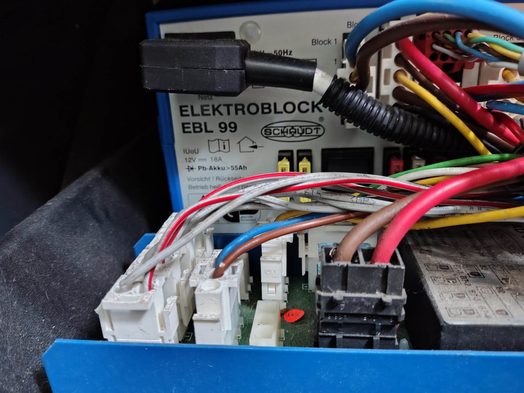

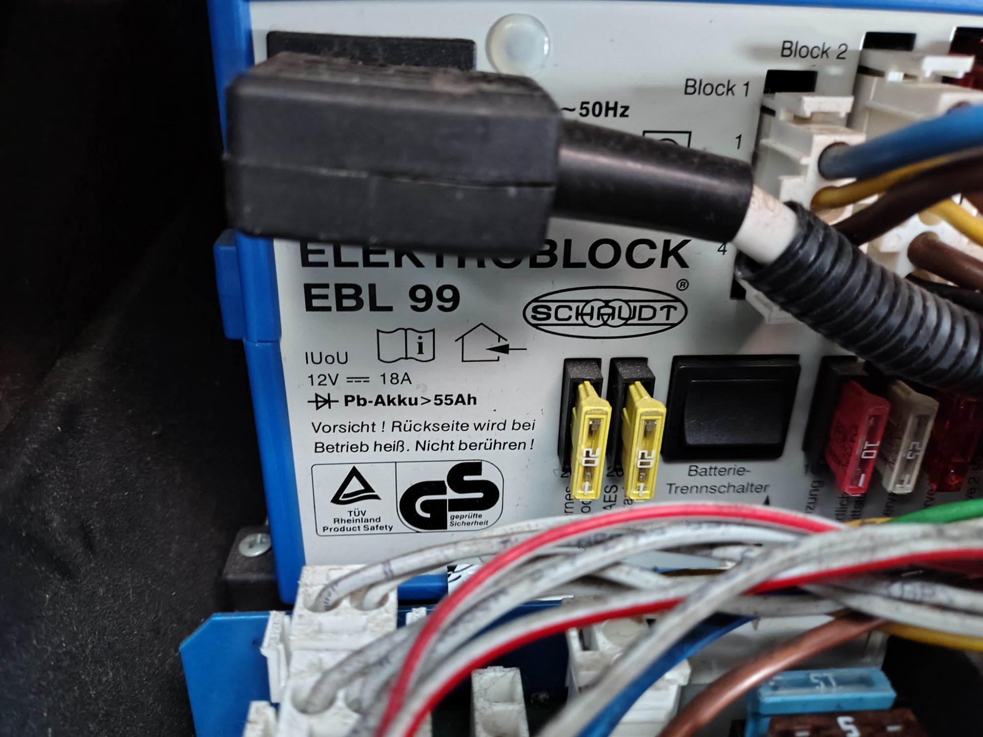

Thanks Merl, this is a photo of what we have:

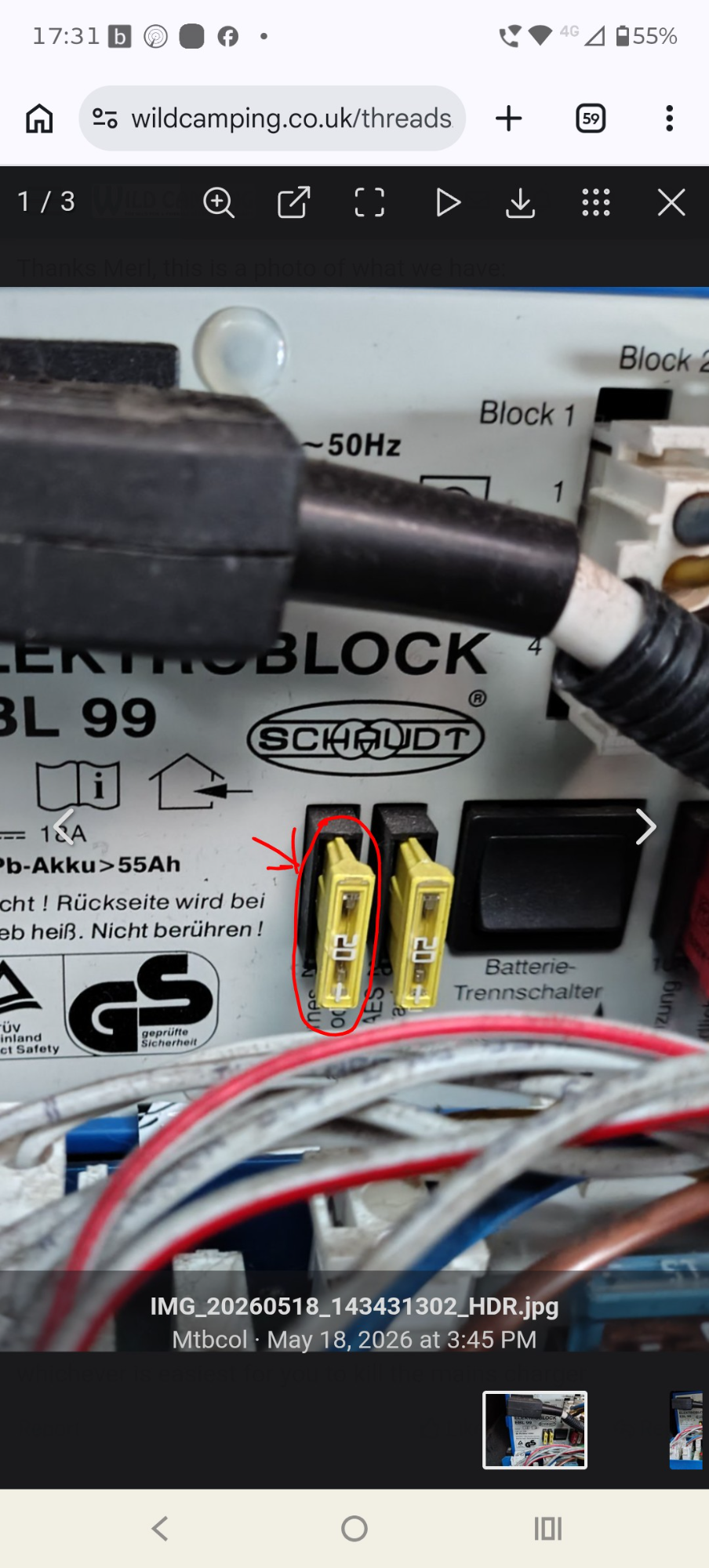

Either pull that left hand yellow fuse or the mains lead whichever is easiest for you to kill the mains charger
Thanks Nabsim...This one?
