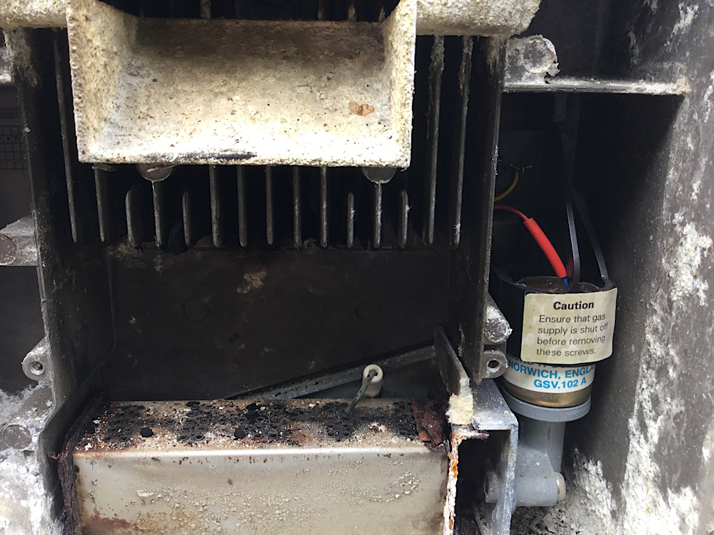

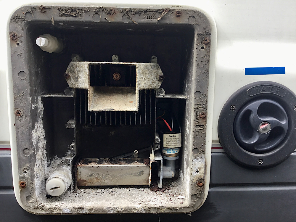

Something tells me the Carver cascade water heater on our recently acquired Autosleeper hasn’t been serviced for a while, if ever.
(Was smoking like a coal fire!)
Wow looks very dirty no wonder it was smoking looks like a good blowout and brush might sort it. The burner looks like its starting to rust quite badly on the left might want to check its not split.
Mike
Cleaned it up & tried it - belching out yellow flame.
In my photo above, to the right of the igniter you'll see some loose bits of rusty burnt away strips of metal - think something needs replacing?

Removed the burner unit & everything inside has just corroded to bits:
Reckon previous owner’s left it on with no water in the tank for rather a long time at some stage?
