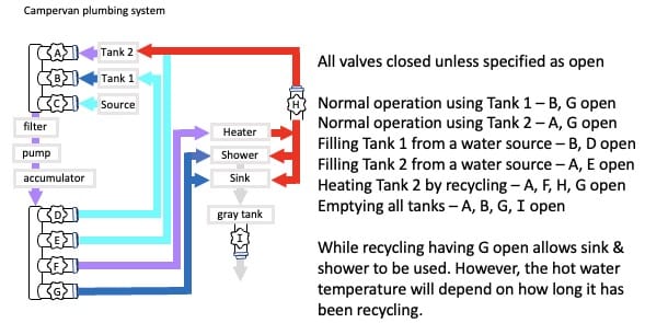

@Squiffy After thinking about it some more, I think I've found a fault with my plan. Although I had not mentioned it, I was assuming that I would still be able to use the shower and sink water as normal while filling the large tank with hot water via recirculation. But when I was describing it to a friend (who is not even a DIY type), we came to the realization that the cold water pipes would become hot water pipes during the recirculation time. That means no cold water at that time -- which would probably be several hours.
So, I'm going to have to modify my plan. I don't blame you for not seeing this because I didn't tell you that I was assuming I would be able to use cold water at that time.

I've come up with a solution: an extra 3-way valve that allows cold water to be drawn from the other tank if needed -- it requires temporary disruption of the recycling mode, but I think it will work for my needs.
I appreciate all the help regarding whether this is feasible. Thanks again.

Thank you @Nabsim and @Sprinter 1 cup for sharing your experience. I definitely agree that dealing with microbes is a priority, and for that you need to either get all surfaces hot enough to kill them or clean regularly using bleach or some disinfectant. Of course, this also applies to cold water tanks if they are in an environment that gets them warm enough (eg, summer heat). As I wrote in my original post, this is not intended for drinking water.

My latest plan keeps the recirculating water pipes separate from the cold water supply lines, and I plan electrical control of the valve associated with recirculating heating (H in the new figure). That way I can introduce a thermostat to shut off recirculation once a set temperature is reached. The Truma heater installation already involves a safety overflow if the temperature gets too high in "normal" (non-recirculating) heating, but this additional thermostat will give the control needed over the recirculating system.
