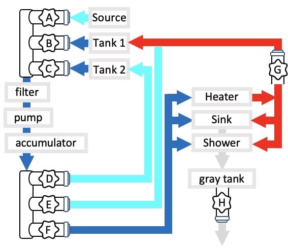

I'm plumbing the water system for my campervan and made the following schematic to show the different modes it can operate. Although I'm an experienced DIYer, I've never tackled a plumbing job this complicated and I'd appreciate any advice before I actually do this.
Producing a large tank of hot water as needed is (perhaps) a unique feature, and using the pump to draw in water from streams, etc... might also be uncommon.
Normal operation using Tank 1 – B, F open
Normal operation using Tank 2 – C, F open
Filling Tank 1 from a water source – A, E open
Filling Tank 2 from a water source – A, D open
Heating Tank 1 by recycling water through heater – B, F, G open
Emptying all tanks – B, C, F, H open
All valves closed unless specified as open
Additional details: Vents, etc... are not included in the diagram. Tanks 1 & 2 are each 100L fresh water tanks located within the van, and the gray water tank is another 100L tank mounted below the van. The heater is a Truma Diesel heater which heats air in the van, but it also heats a 10L water tank within it. Water sources to fill campers typically are pressurized so there's no need to use a pump to fill them. However, I want to be able to draw water from sources like streams as well. By the way, I don't plan to drink any of this water -- it's just for washing and showering -- but instead plan on bottled water for drinking.

That (to me) looks massively over complicated.
I had a fresh tank, outlet to a Shurflo pump, which fed the boiler and all the taps hot and cold, unless you have a special requirement I don't see why the extra complexity
Thanks for your comment @Pudsey Bear -- if you have a way to provide the features I want in a simpler way, I'd be very interested. Those features are implied in my original post, but here's another way of listing them:
1) ability to use, fill 2 tanks (including from streams)
2) ability to fill one of those tanks with hot water
3) ability to empty all tanks
Sorry I misread the OP, but I'm not sure how you would do all of that, it's never cropped up before that I know, I won't ask why as you have made a decision to go that way, as from streams We used to do that, but used a simple watering can, I expect you could utilise a secondary Shurflo pump to do it as well, but seriously good filtration would be needed as I didn't like the taste of dead sheep and cow crap in my water.
Looking at the diagram, it is absolutely a solution. But a solution for a problem that doesn't exist.
BTW ... "Producing a tank of hot water as needed is (perhaps) a unique feature".... why is that unique? seems pretty normal to me or am I missing something?
@wildebus I said "unique" because I am unaware of anyone recirculating water through a small campervan type water heater to heat a large (100L) tank of water. So I added the word "large" to my original post to hopefully help clear up that confusion.
The Truma combi does a good job of producing 10L of water as it also produces warm air to heat a motorhome — and this is fine for most situations. But if you want to produce larger amounts of hot water it becomes more difficult and introduces a lot of problems in terms of cost, weight, expense,… The Truma diesel heaters have a lot more capacity than is needed for a campervan so I woud think it could handle the recycling approach I mentioned. If you’re aware of someone else who had done that, I’d be very interested.
Thanks for your feedback on the diagram, it encourages me to move forward. I know that I can miss simple things, especially when doing something for the first time.
As far as it being a solution for a problem that doesn’t exist, well, all I can say is that it exists for me… unless you have a simpler solution that meets the features I listed in my response to Pudsey Bear
Thanks again

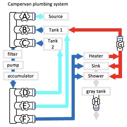

Producing a tank of hot water as needed is (perhaps) a unique feature, and using the pump to draw in water from streams, etc... might also be uncommon.
Hi Tony,
I have to agree with Pudsey and say that to me at least you have greatly over thought out your pluming system. I am not aware of the vehicle you are building but calling it a Campervan suggests its similar to a VW T 5/6, if this is the case two 100L Internal tanks would be taking up one hell of the available volume. Unless you intend to wild camp in outer Mongolia or the wilds of Scotland the second tank for wild water would be superfluous and I personally never drink water from any tank including the main fresh water tank unless the water has been boiled any way plus water is readily available all over the UK and continent. Not sure if you are a seasoned traveller.
My other comment would be because of the complexity of the water system it would also be open to many joints that in turn could be prone to leaks even when the joints were produced correctly. If I would be in favour of simplifying the whole system. Phil 😬

Tony your plan is definitely workable, I've done many a plumbing job on motorhomes and campervans and looking at your plan it is a workable solution to how you require it to work if that's what you require. The comments I've made were meant to be helpful obviously I mis understand your post. Phil
@Squiffy thanks, this is encouraging. I've worked with a lot of valves for house and sprinkler systems, but I've never worked with a system of valves like this that have to work together in different modes, particularly with a pump. Also, the pump recycling part is intriguing to me. Of course, that's why I went to the trouble of drawing the diagram. Thanks again.
