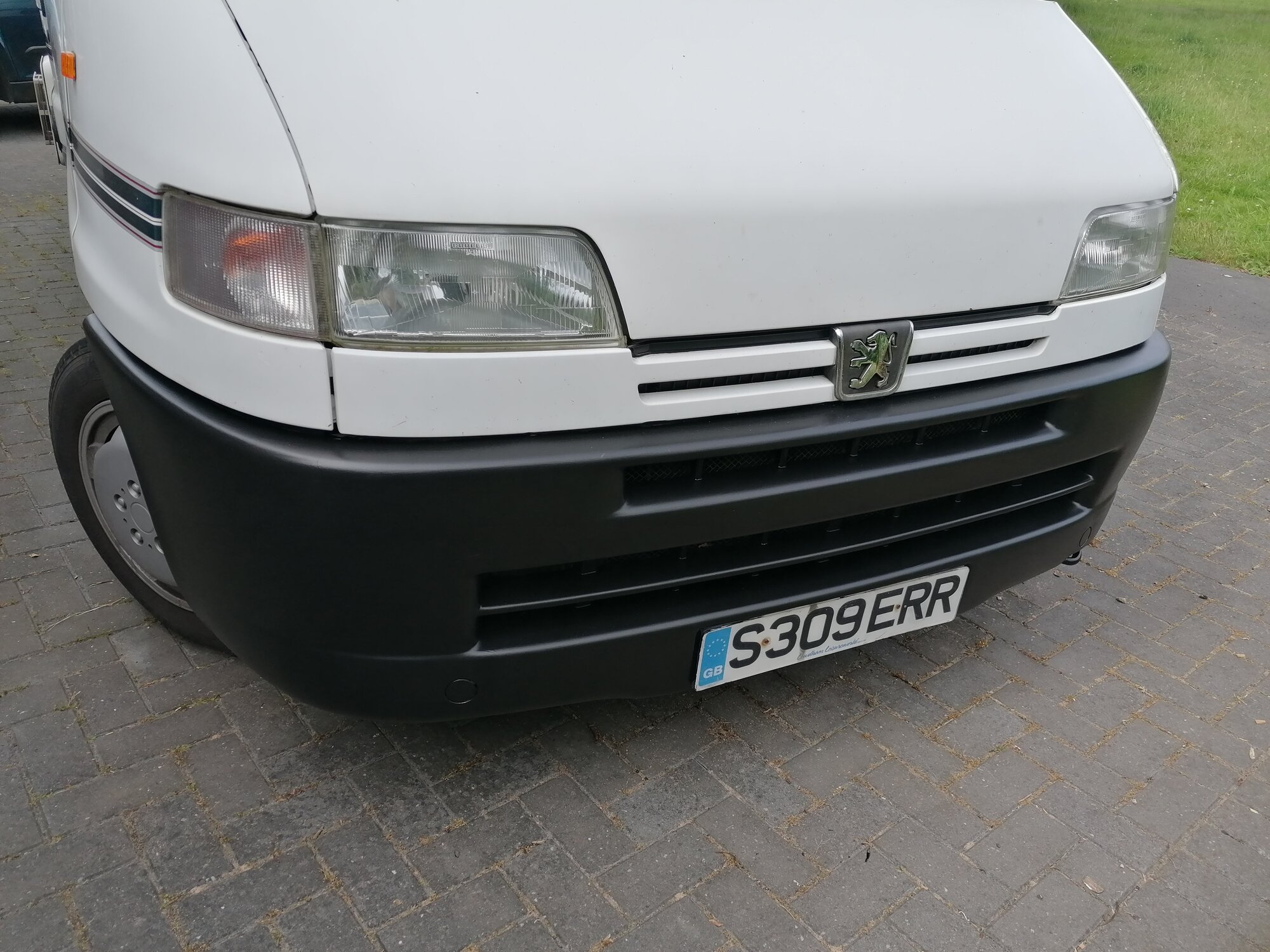

I went over all of the plastic parts with a heat gun and that worked fine for a few years. I've noticed that they are starting to grey again in streaks this time and you can see where and how I've applied the heat gun. I've used various remedies previously that essentially rely on oil Inc peanut butter, olive oil, silicone spray etc but the black doesn't last long so I think I'll try Dave Greengrasse's Cherry Blossom technique.

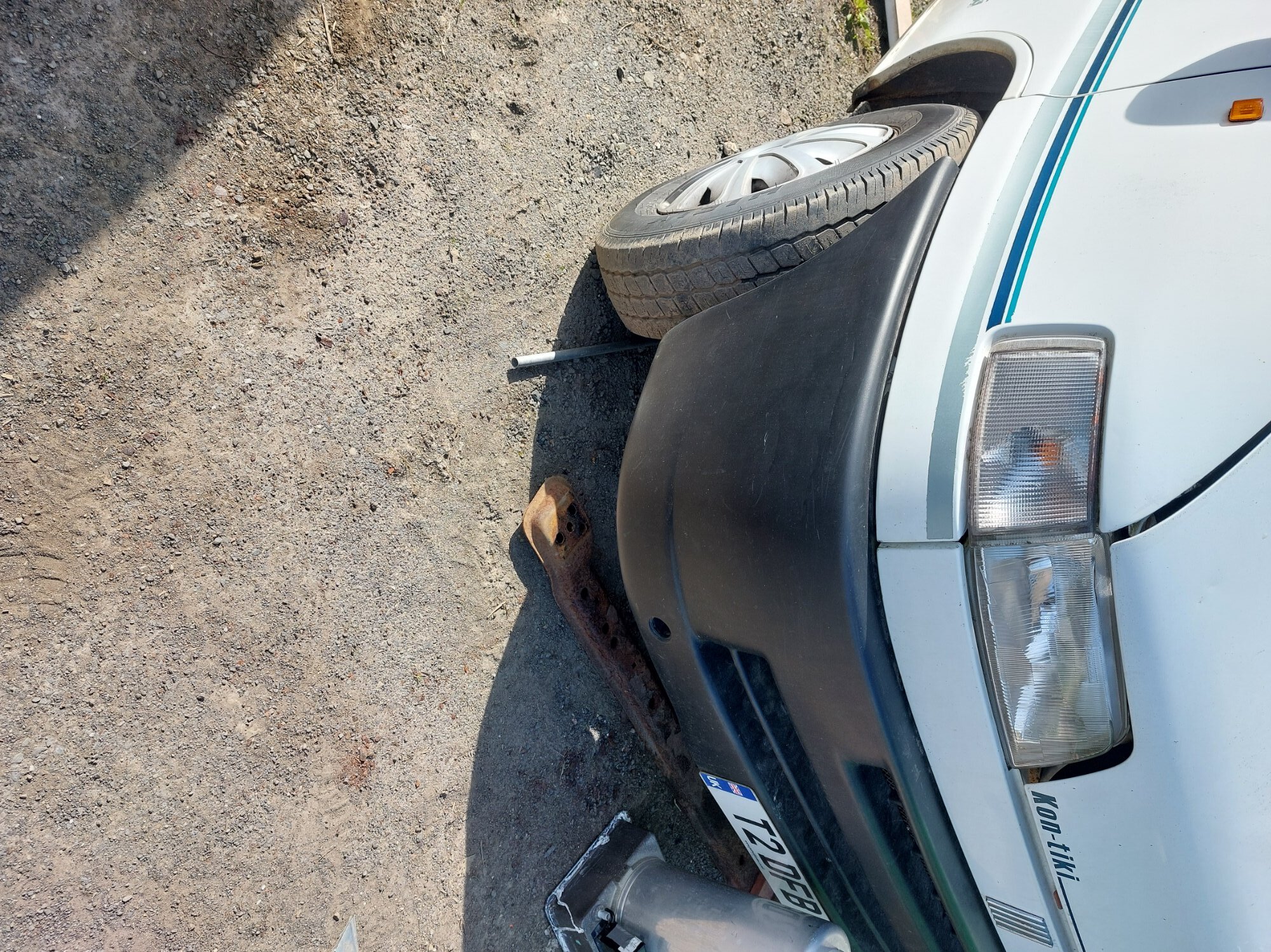

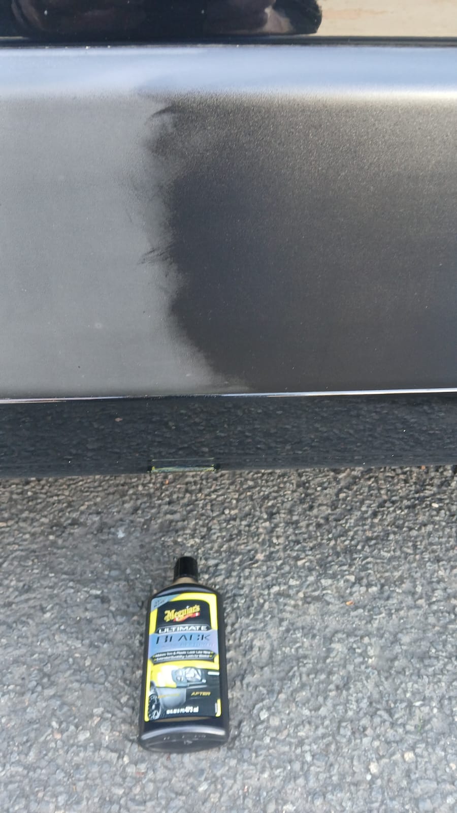

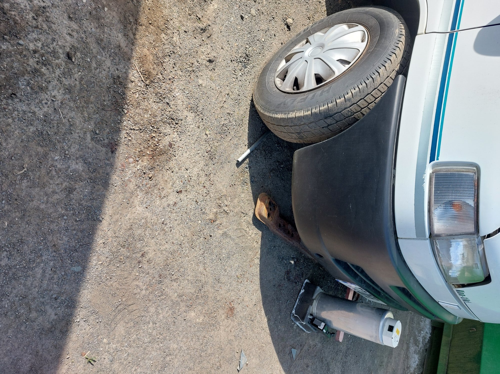

My bumper was a dirty crappy gray that was before covid that I put the polish on photo taken yesterday
As I have the bumper off to do the chassis cross member I will give it a coat or two to brighten it up

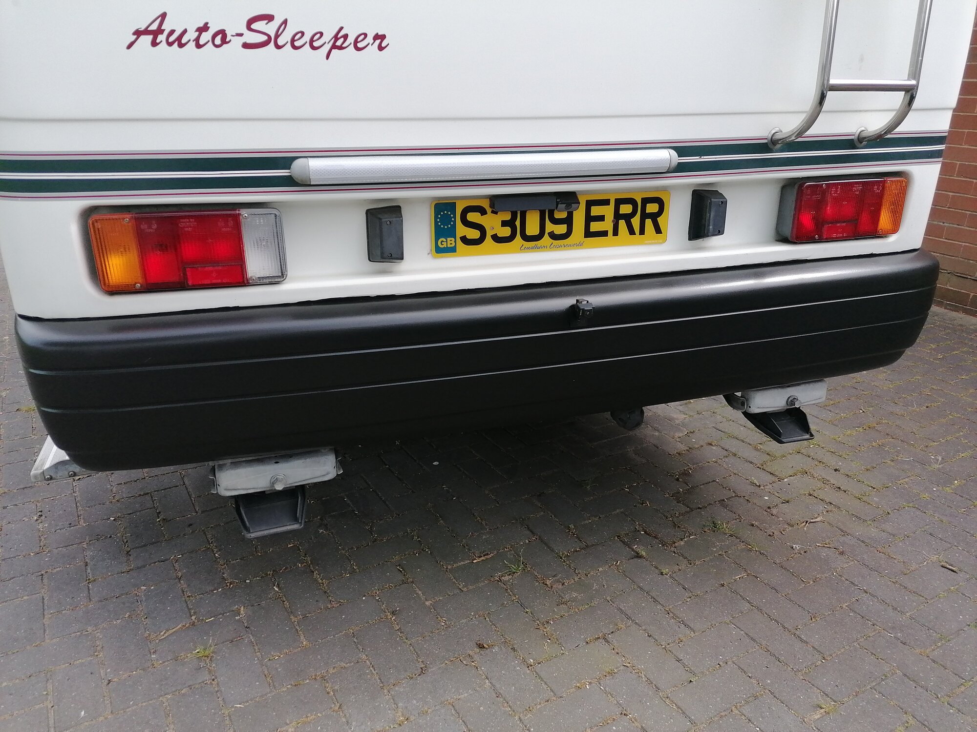

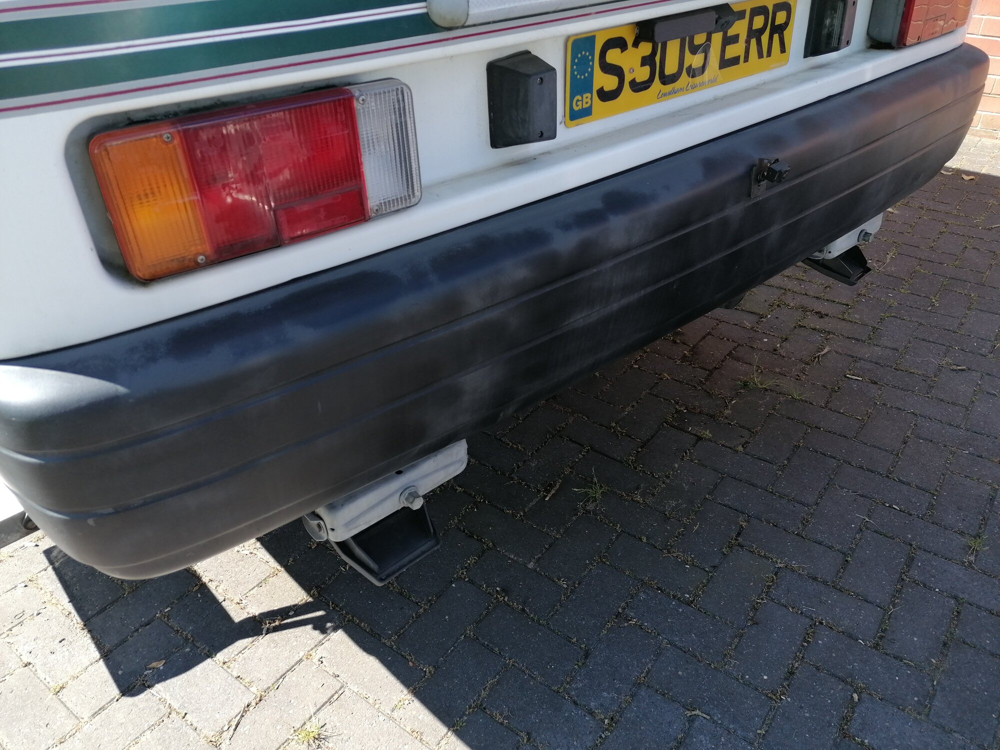

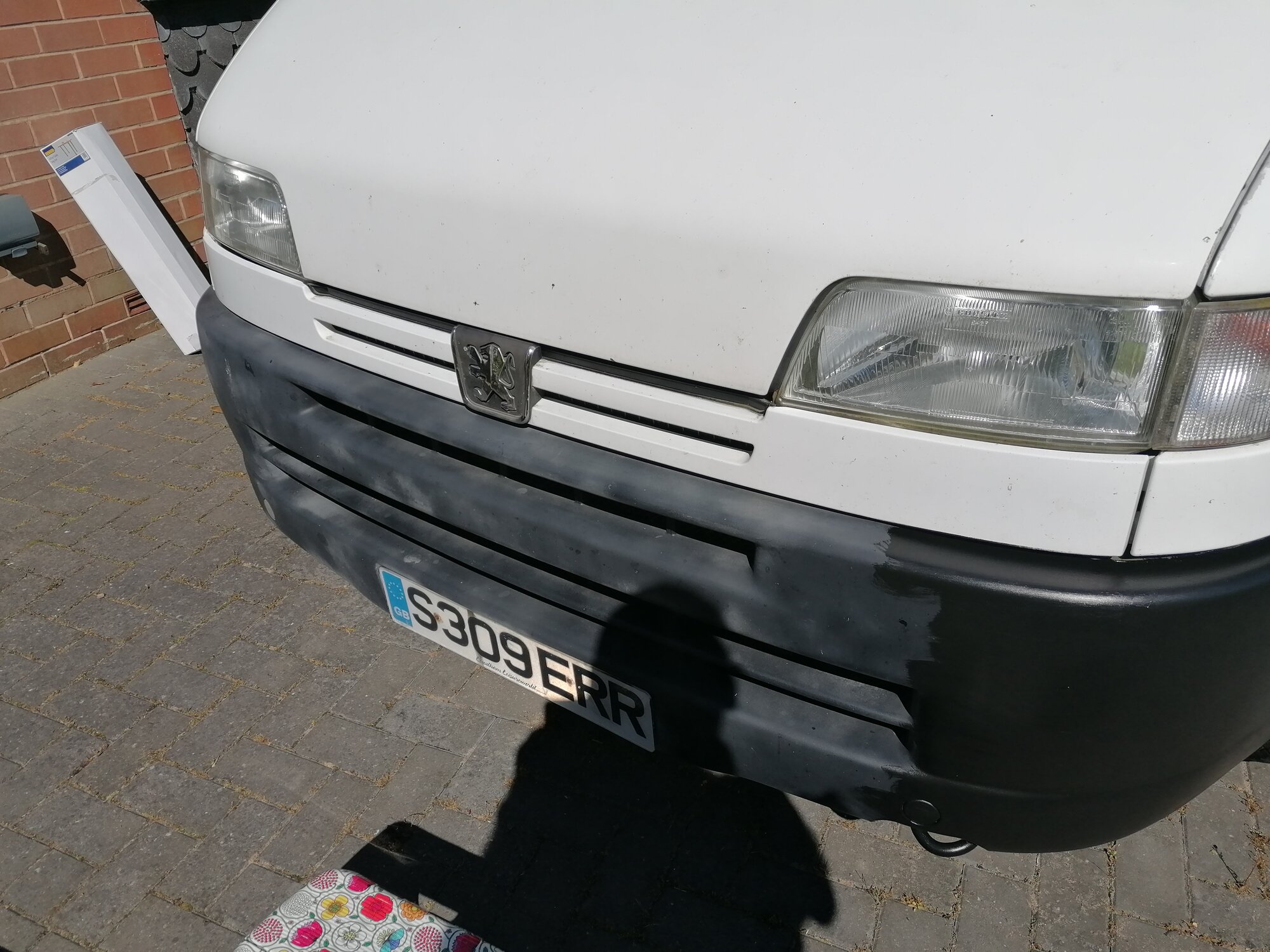

Finally got round to doing the bumpers.
Tried shoe polish and it didn't work to my liking. Decided against spray painting because of the faff of masking tape etc.
Used Zinsser primer and top coat.
Not looking bad at all methinks.
The last two pics are the afters!
Time will tell now. ;)
Indeed it will.
The prep was a wash down, then anti greasing spray, another wash down, sanding, damp rag wipe over, primer, 2x top coats. Time spent = 3 hours-ish.
I used the same method on a white upvc door at our last house, 2x years later it still looked good apart from the odd bit of white showing thru' where a sharpish edge caught the door going in and out.
