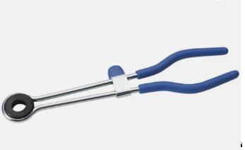

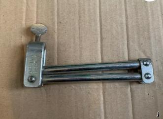

You should carry a brake hose clamp, by the way one set still work as its a duel split sys from the master cyl, hence 2 pistons in it.
Happened to me outside derry city when one rear w cyl burst its seals, home on fronts only.
Happened to me outside derry city when one rear w cyl burst its seals, home on fronts only.View attachment 139191View attachment 139192
