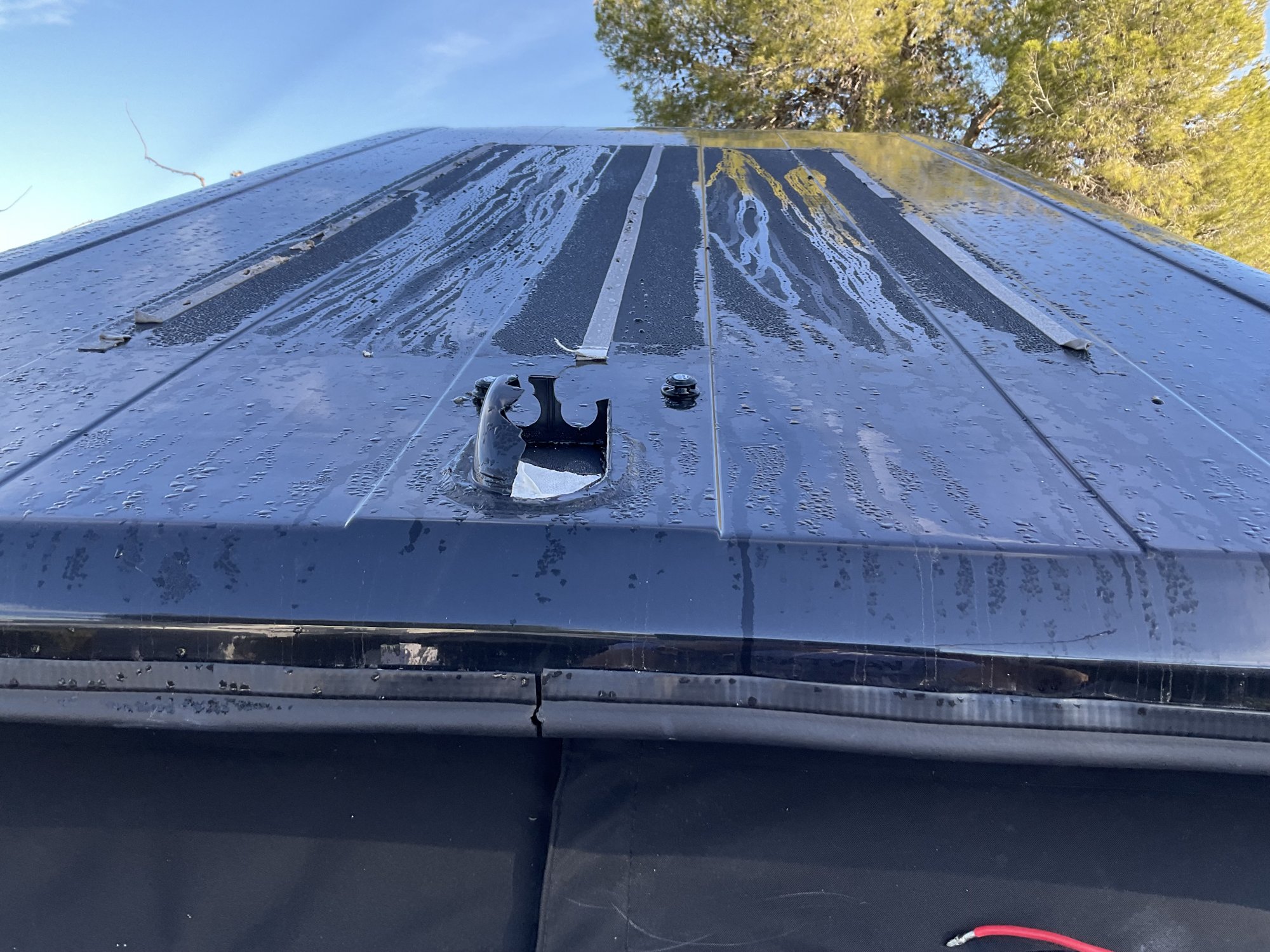

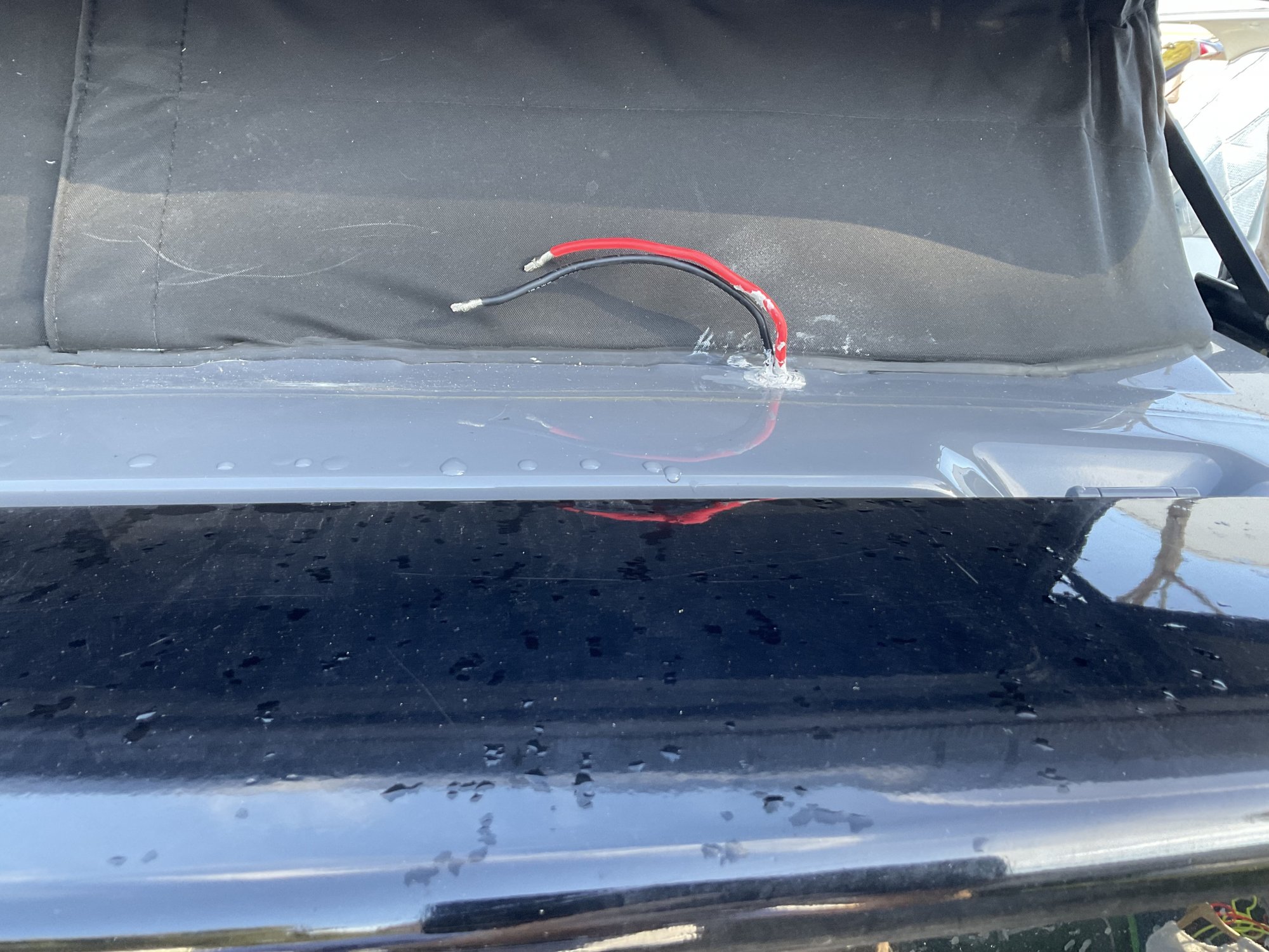

Got in Benidorm 11am this morning fabulous pitch, took notice where the sun was so parked van up lifted pop top. Then inflated awning, set new camp kitchen up, just looked up and 200 watt Renogy solar panel gone, twinwall still on the roof cable gland smashed up.
Heard a terrible noise yesterday sounded just like a puncture pulled over on motorway checked all tyres and wheels for tightness carried on to a motorway services to check van and trailer wheels ,tyres and bearings for overheating.Drove around services a couple of times and noise gone, so set off again got up to 50mph on motorway and noise like puncture again so I stopped again checked under van to see if any panels had dropped down and nothing so I proceed on with the noise and once off motorway was going to call VW assist, all of a sudden the noise stopped and the van drove the next 250 odd miles perfectly, I never thought to look on the roof. What happened the plastic bolts I had sika flexed to the twinwall had pulled out I've now got a real mess on my roof as I've removed the twin wall now.
Good job no other traffic on motorway.

Bloody hell! Never heard of a panel flying off before. That is bad news. I assume you are on hookup though on the site?

£$%^ that's bad news! One of my big fears. We have two wafer thin 350W panels and I do worry about them flying off. Hope it works out for you!

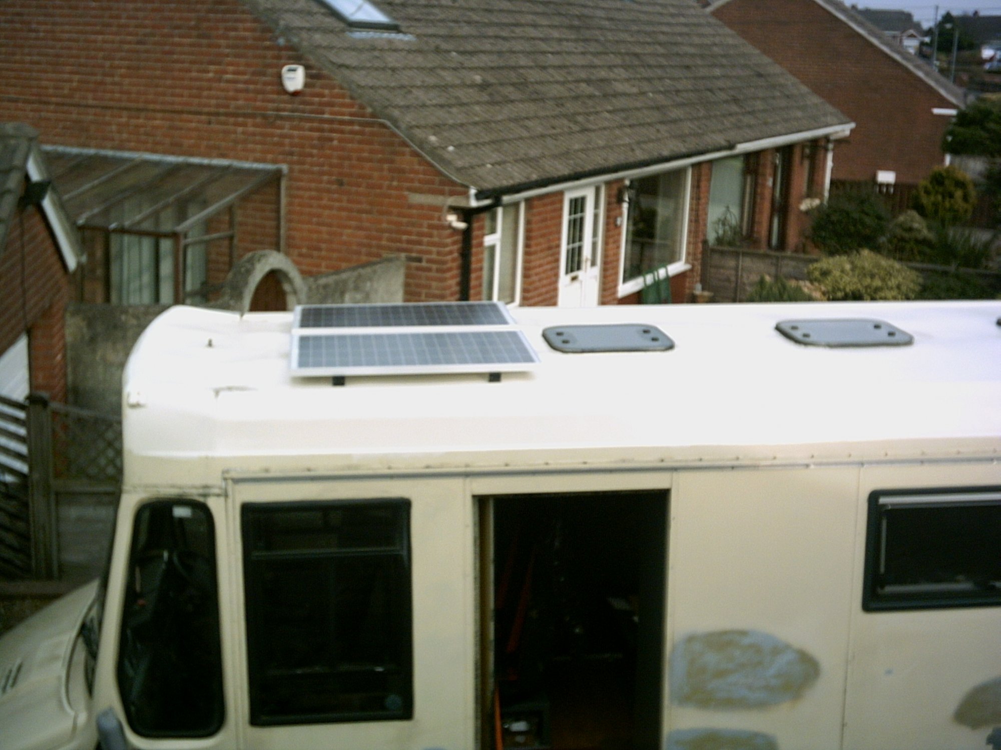

I made my brackets from fence clamps and straightend one side to bolt onto panel holes on the frame.

On the Ferry to Santander, we were parked tight against the rails overlooking the down ramp to the exit doors, so had a good view of polished M/Home bodies and lime green roofs etc ...
However, I saw at least 2 VW California Vans with front to back factory fitted roof bars, and the owners had merely used the standard roof rail bars to mount the solar panels - very simple and effective! The 2nd Van had 4 panels squeezed on flat and had managed to prop up a 5th Panel - no time to see what it was attached to, since the vehicles were in motion on the ramp ...
