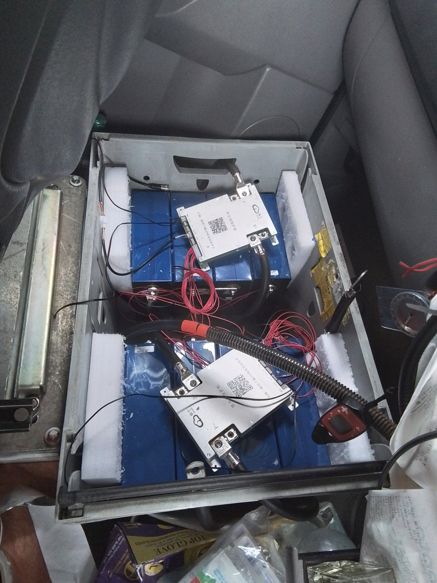

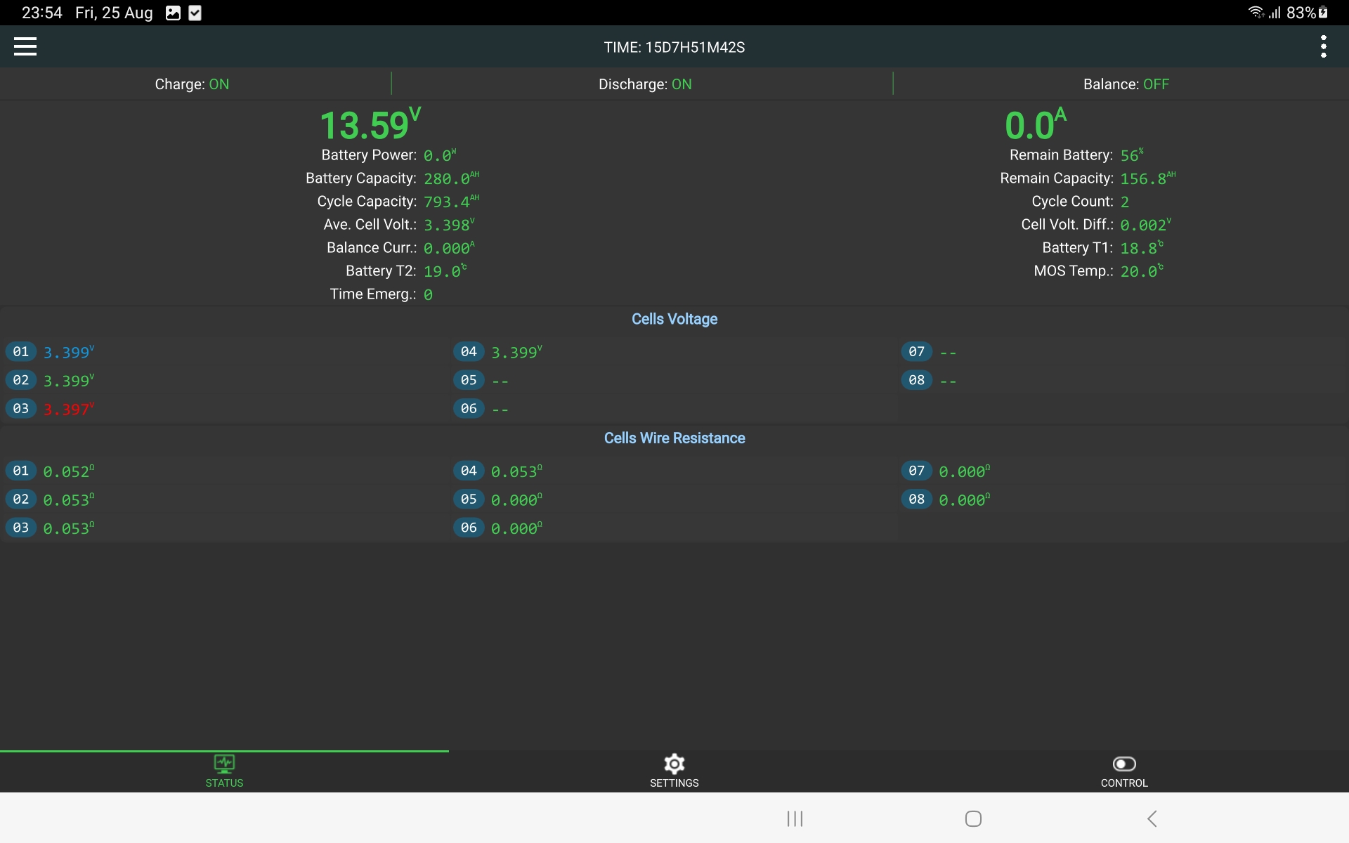

Just get a lithium bms and wire it to all battery and your see all cell / battery voltage by Bluetooth. Pics of 12v but if you power by 24 volts the other four work
!this one has a 2amp balancer built in and 24v is just to power the unit not the output of battery pack. ,.

Think of it as a simple upgrade to find a poor or unhealthy battery in your 6v pack at a glance.
