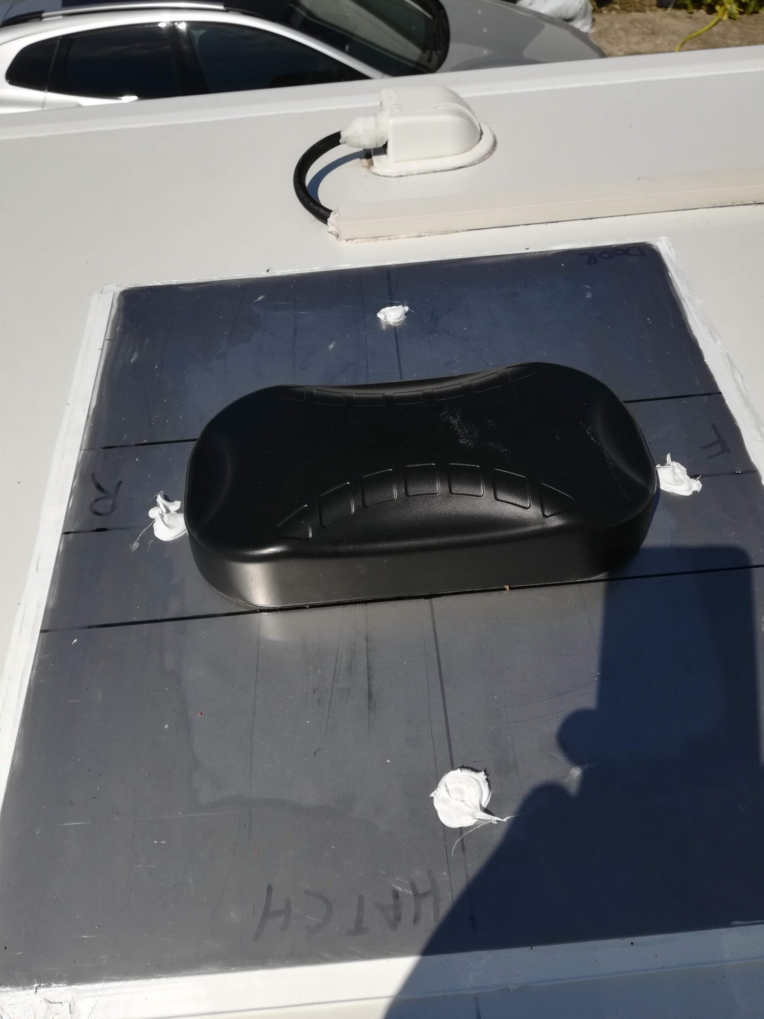

I set up a RUT240 (MaxView) for another member just the other day here in Spain. He wanted to connect to the campsite WiFi but found the RUT240 down on sensitivity where as my 955 with external WiFi aerial could achieve a reliable connection.
What aerial do you have?
I believe it is this one LINK
The aerial and 955 give a stable setup which runs for months. Our van has a fibreglass roof, it is recommended to use a ground-plane, this is just a piece of stainless sheet with a hole in the middle for the aerial to bolt to and stuck to the vans roof. I think I have a picture somewhere.
