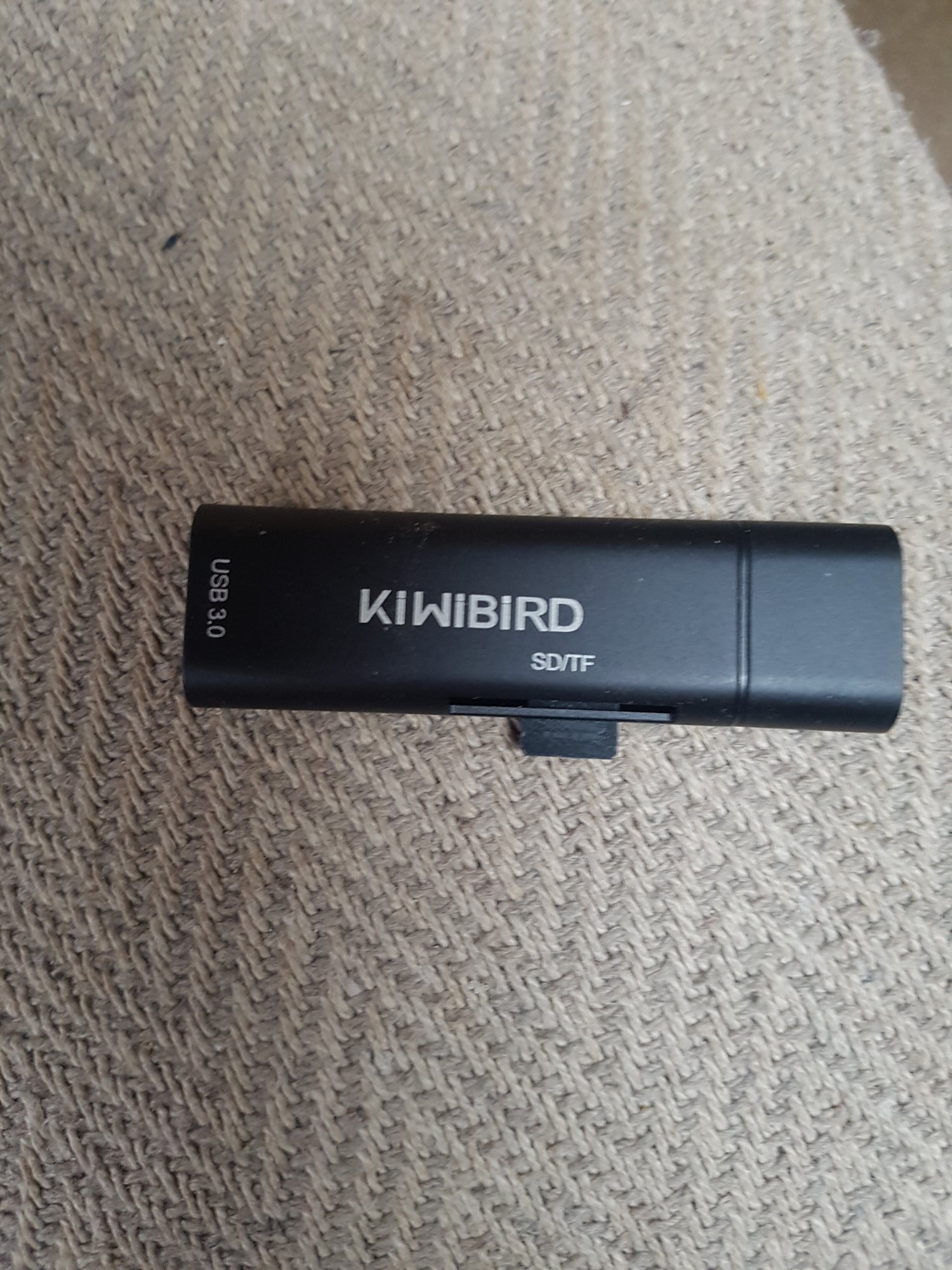

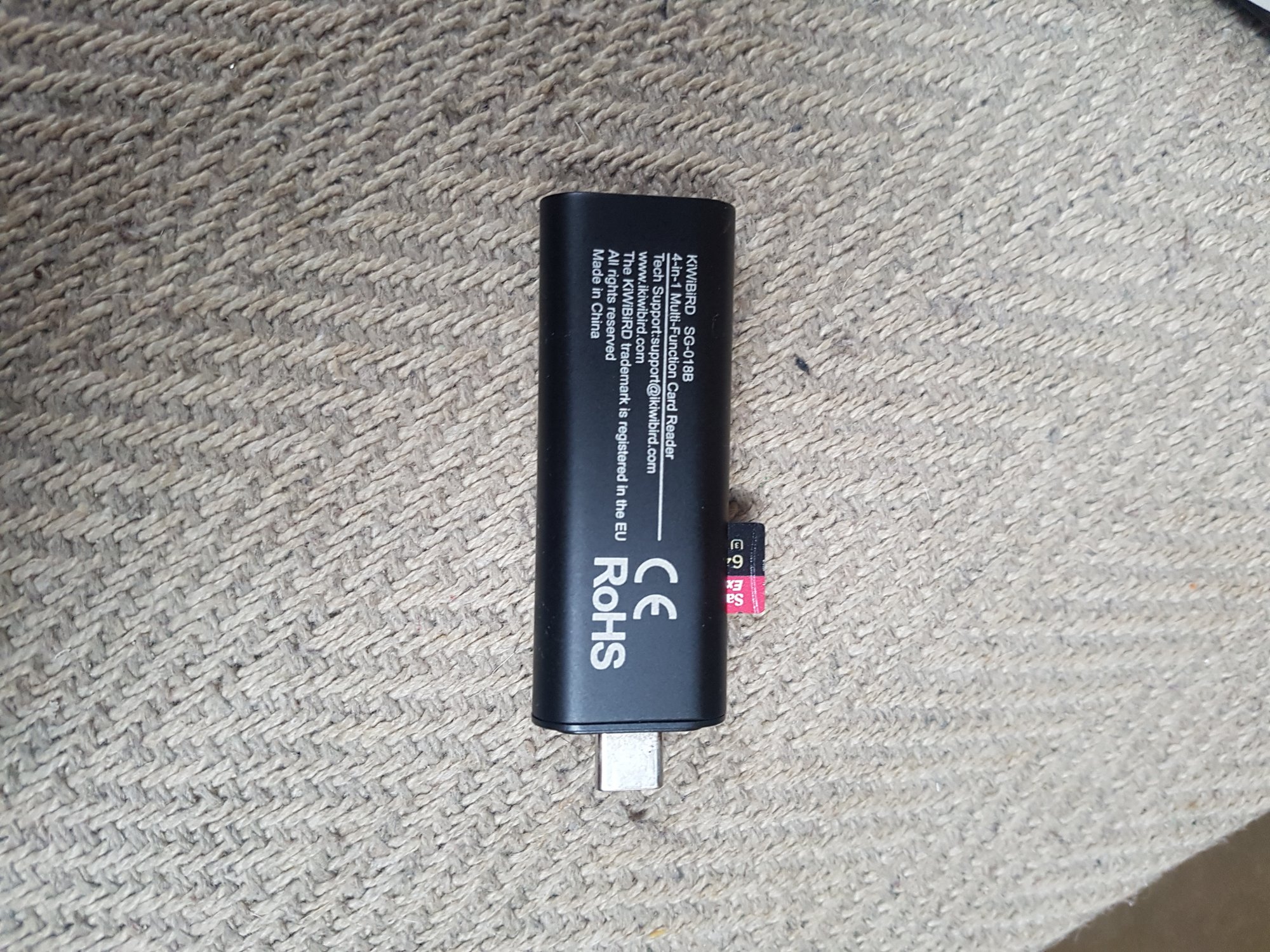

You definitely can connect an external drive to an Android device.
I do it frequently.
Purchase an USB device with SD card slot.
This is what I use:
I found that the double ended pen drive works. Well, it does on my phone which uses the old style micro USB socket. Presumably similar drives are available for the current USB-c style too
I do it frequently.
This is what I use:
View attachment 106637View attachment 106638
I meant a hard drive. I think your picture is of a flash drive or an sd card reader. My wife has a library of sd cards getting bigger over time. Perhaps I should have said videos and photos. This topic has arisen again as we seem to have an sd card that corrupted and as the videos move from a go pro sd card to a phone sd card then to a storage sd card as the phone storage gets full and then back again when editing, a better solution would be great.
