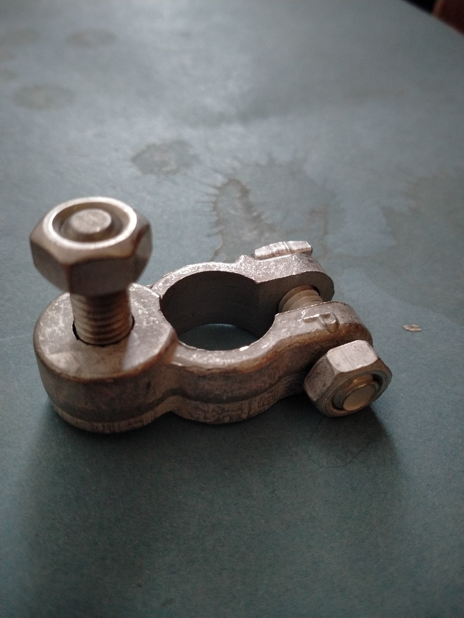

Hope your still happy to do this for me, and more than happy to send you payment upfront for cables, fuses, fuse holders, labour etc. just let me know. If you need anymore info just let me know. I've attached photos of the battery terminals if this helps.

Here's the photos of the battery terminals.
I've got some post connectors with the longer cable attachments as shown as I may need to use them once if got extra cables attached. Any other advice or recommendations gratefully received 🙂

Ref the terminals, looks like a mix of 5mm and 6mm bolts there with possibly an 8mm on the last one? If you can confirm the sizes needed at each battery ends, that would be good. Not the biggest fan of stacking lots of cables on a battery terminal, but if supported well, it is ok.
The +ve leads at the battery ends will have a short lead from Battery +ve to Fuse, so if you are switching in the future to Lithium, that will almost certainly need 8mm rings - I could send a couple of loose 8mm lugs to swap over when the time comes. You could potentially have 8mm to start with if you can arrange the connections so they are securely clamped down and making a good connection.
