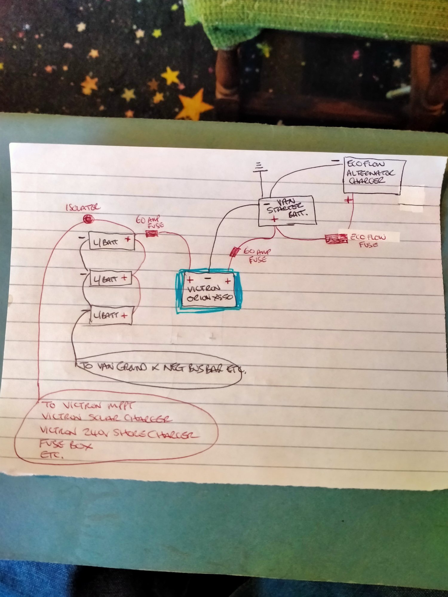

Good afternoon all. I've now received our Victron Orion XS50A! Just need to sort the cable out now. I'm still a little confused re this. Basically the Orion unit will be approx 1-1.5 meters from the vehicle starter battery and probably a maximum of 1 meter from the connection of our battery bank. I assume the negative cable can either be connected (from the Orion) to the starter battery or a convenient ground? So in total I've probably got a maximum of 2.5 meters of live cable and 1.5 of negative cable required. So would I be ok with 16mm2 for these cables? Obviously with a 60 amp fuse on each of the live ends, or are breakers preferable? I just want to get it right before I make a start on the install. I'll probably have so more questions, but that's it for now🙂👍

Hi Phil. I was working yesterday but have a couple of days off now so hopefully can look into getting my cables etc. ordered. Thank you for the cable size confirmation. What's is CSA? Also, can you confirm it's ok to connect the Orion negative directly to the negative terminal of the vehicle starter battery (it's a transit and it has a starter and aux battery under the driver seat) I've attached a quick wiring diagram ( sorry it's not very professional 😁) just to show what I've currently got and what I will have once I've wired in the Victron Orion. I'd be grateful if you would point out any mistakes or add any recommendations if you wouldn't mind. Thank you.🙂👍

I went with 25mm 4 awg as its close to 6m from starter battery to Victron b2b
Possibly overkill BUT seems to work well

Thank you. The distance from my starter battery to my B2B is only about 1-1.5m and about 1m to my leisure batts. So I thinks Phil's recommendation of 16mm will be ok

I went up a size (and cost) due to the distances involved and potential voltage drop .....
So far performance b2b wise seems to have improved over the previous incarnation of Ring rscdc30 and smaller cabling
