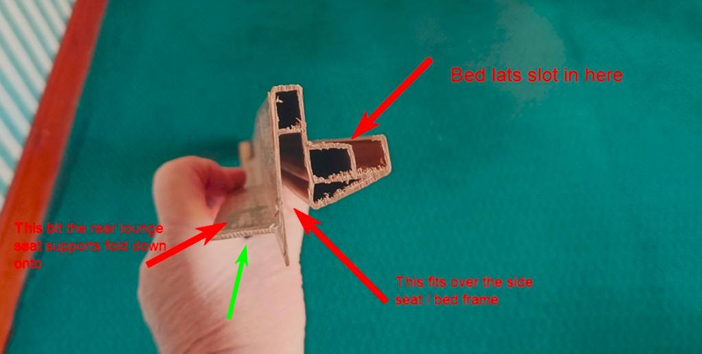

Hmm, seeing that helps so essentially 2 L shapes at different heights very doable then, but you need a bloke who knows how to use a press brake, or maybe welding two lengths together might be more easier.
I assume Tim would have a pukka press brake, I'd have happily had a go with a 6 inch bit to test the fitting but I don't have the gear nowadays, but it is simple engineering.
Tim would no doubt be the man but I don't really want to hassle him with the job as it will be more work than you imagine and he's a long way away. I put out a post on the local fb groups for Richmond and Barnard Castle though and got a fair few replies. These people are quite near to me and they do a lot of work for an old client of mine by the sound of it. They are not actually in Darlington. Just about 8 miles down the road from here.
Will sound them out. Of course at the moment I have two full sets of brand new supports which Swift sent me as the last lot broke so it could be I just got a bad set but I dont think so. They would do this year though if I cant get anything better done straight away.

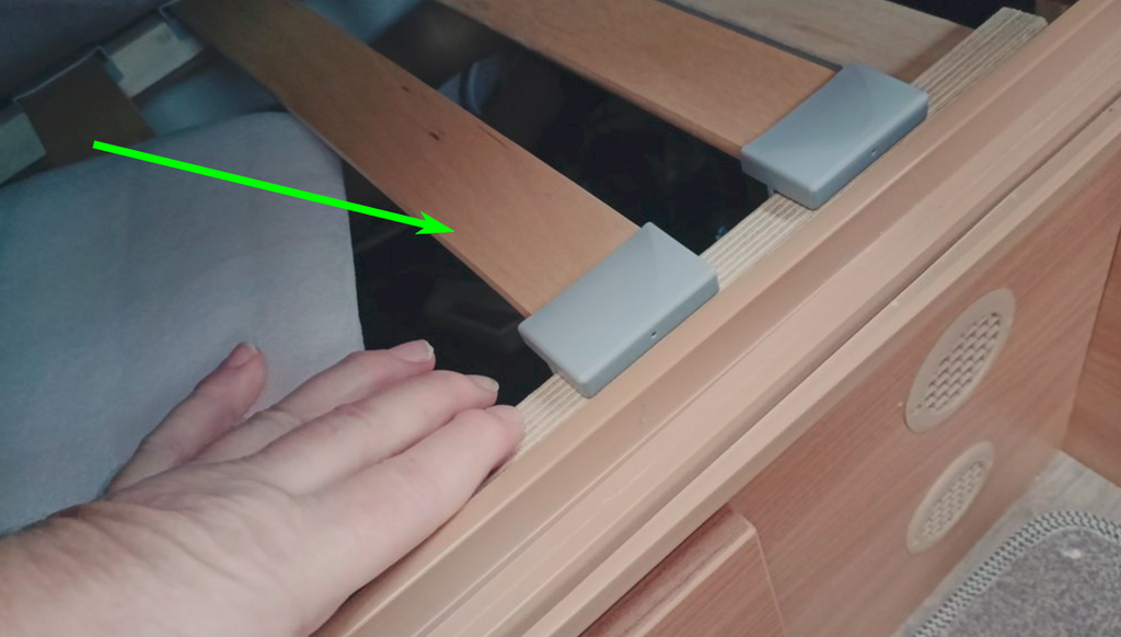

So the new supports are in but the question is how best to support them from the back? There isn't much I can do about the slats support for now where the bed slides out, we will have to see how they go but underneath the seat at the back of the support the bench seat just rests on a right angled thin bit of plastic which is the back end of the bed supports and that broke as well at the end of last years trip. As its out of sight could I just glue some timber the full lengthy underneath it? Ideas please.
The bit that needs supporting is marked with the green arrow below. Trouble might be that there is some plastic that comes down from it as well so any wood might not fit flush. What I might be able to do is get some bits to run from the floor to the support but there is a locker draw in the middle also.

Another idea I thought of just now while eating chips in Barney was quite a simple one. Just find a similar piece of timber to the drop down bench seat pictured below and screw it perpendicular under the slat marked with the greed arrow to the floor. Like a prop if you like. It would have to be an exact length and its possible it might restrict opening the locker from above but there is a locker anyway. The only other issue is the batteries are under there in a sucken batter box so I would have to check there is space.

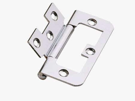

Or. I could mount the internal locker supports on flat hinges like these. That way if I ever need to lift the locker from the top they will swing inwards. :D
Mine looks to be the same as yours. Under the seats, I think some 2x1 would work well, on mine it wouldn't foul anything, as the bed slats, you are both aware that for some reason you manage to break them, so just be careful
