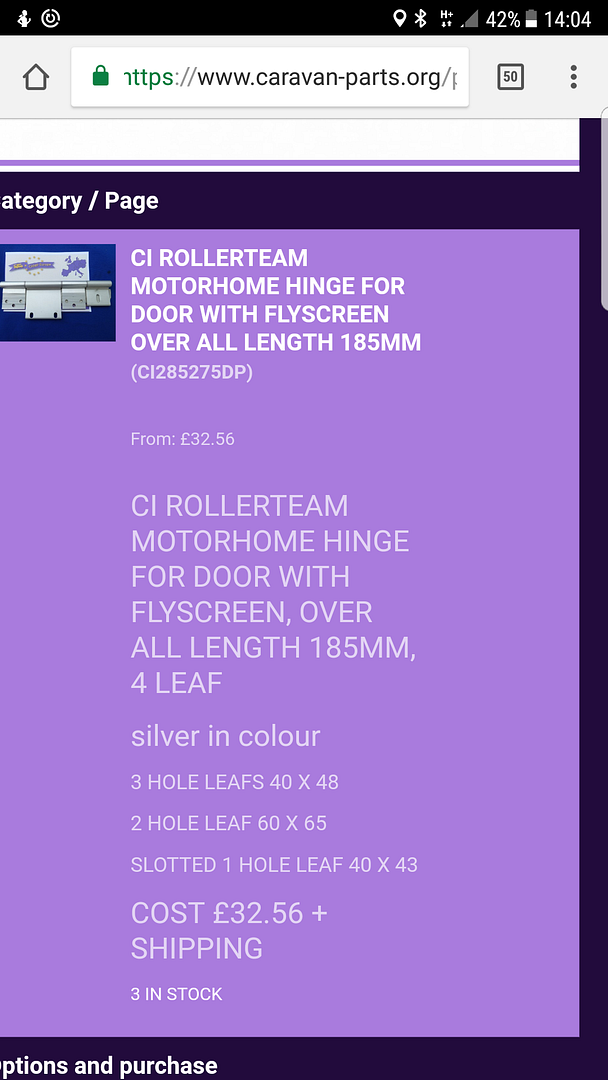

Do you remember who that supplier was by any chance
Yes it was O'Leary's and they still have them in stock ( they certainly didnt sell them to me!)
Nearly
Thanks for your help. I have revisited OLeary's and gone through there hinges but can only see three leaf hinges which look very close but not quiet close enough.
