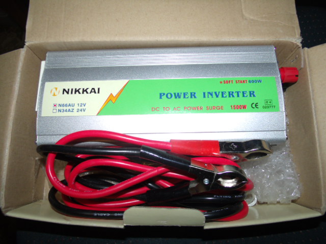

I thought the op made it clear that shortage of gas was the main issue and the reason for exploring electrical alternatives? I totally get this and although we have a 200ah lifepo4 leisure battery onboard it can run short during the poor solar months! I put together a 200ah lifepo4 battery connected to a 1500w pure sine wave inverter with a short hook up lead. All we use it for in winter is to hook up and run the onboard 40ah lithium charger to replenish the onboard leisure battery as we don’t travel far enough in winter for the b to b to earn its keep. Efficiency isn’t an issue because of it’s available cycles, so we use a low watt kettle, toaster and microwave routinely, then top up before going home.

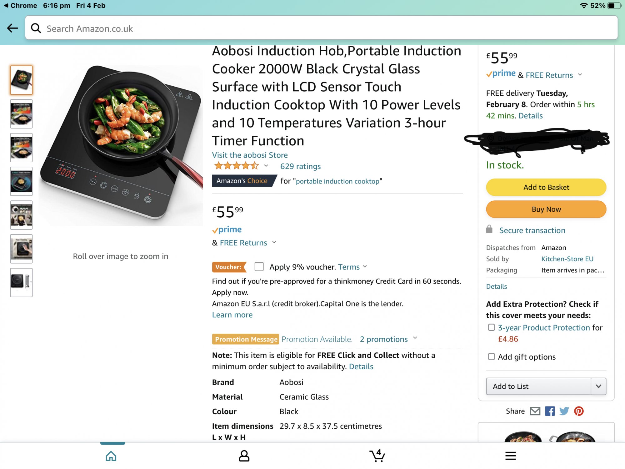

During the ‘solar months’ we can use the ‘home made’ for other gas saving things like cooking as well as the usual stuff. This induction hob below doesn’t cycle through it’s maximum power setting and can be started off on the lowest setting, we can’t use its maximum power setting with the ‘home made’ and 1500w but we don’t ever need to. It’s great for outside cooking.
I get that lpg is becoming scarce but other countries can be more tricky, try getting it in Finland!
