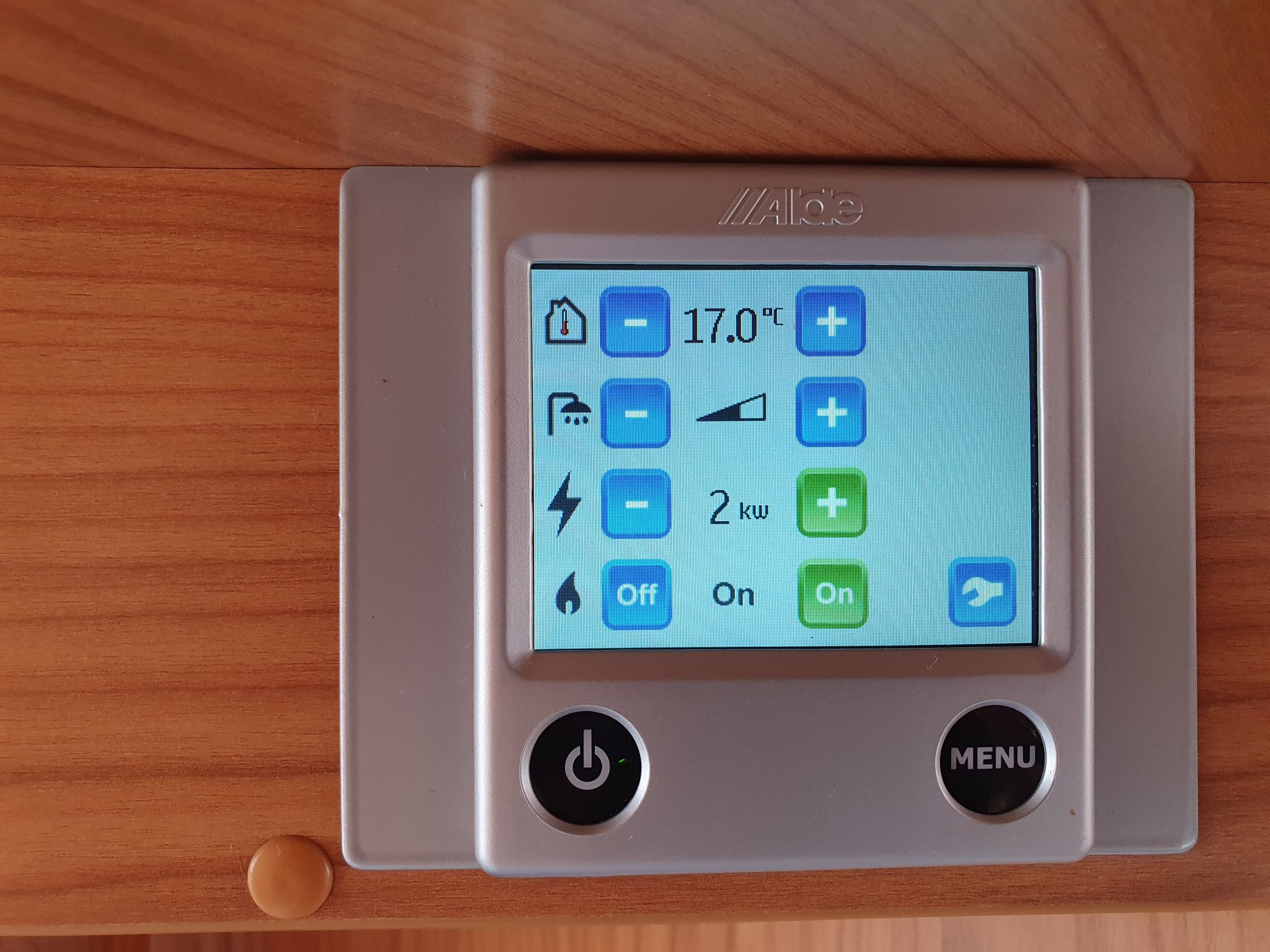

I have Alde, it is great.
Never needed to top up the cooling system (since 2015), but have had it changed a couple of times as part of hab service.
Seem to be three common problems reported.
1) Heating not functioning because it is set on night mode during the day (operator error)
2) Automatically switching off before temp reached. There is an adjustment to correct sensor but people don't read the manual
3) No heat on EHU because the breaker on PDU has tripped.
Despite it being against WC rules I recommend reading the manual!

We've Alde heating inner current van and can't fault it, very quiet on electric EHU but you need to adjust the power setting to suit the power supply your connected to .. 6amp = 1kwh 10amp 2kwt and 16amp 3kwt. Its possible to use on a 6amp EHU supply but will take quite a long time to heat. When on gas its very good, but I've ben told it uses more gas than other systems but I've never seen any statistics on that. I did read something recently saying they were changing to diesel from gas to help future proof the system..
Had it on both vans ... agree with above.
Only thing to add is that if cold, it will need to use gas to boost it to fire up.
