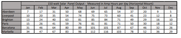

If you've got a couple of hundred watts of solar or more then you'll probably be able to keep both batteries topped up over winter without using the EHU. Y
Depends on where you are (see table below) and what devices are on.
e.g. in Aberdeen you will get about 10ah per day which will support an average draw of less than 0.5 amp.
whereas those overwintering in Marbella will be getting over 4 times this.
doesn't apply.
Also, solar doesn't work well if you park upside down.
However, if you park sensibly then geographic location does impact solar output.
