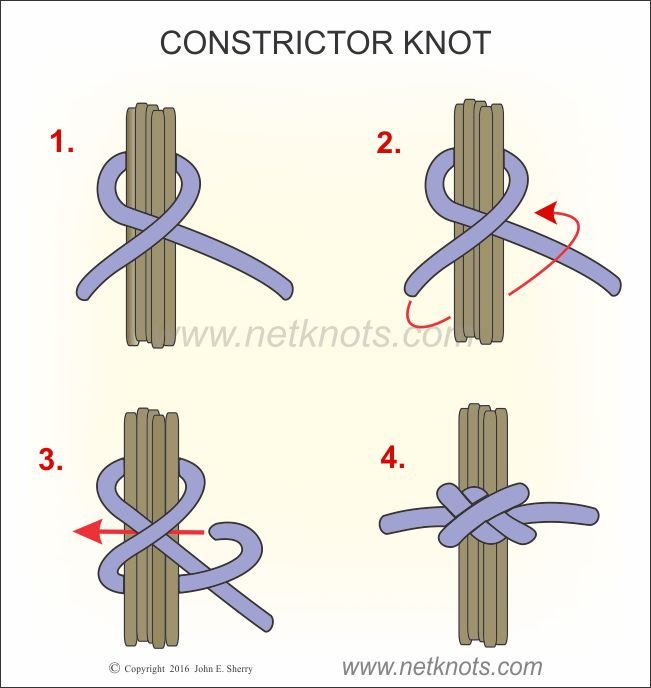

for the survivalists
i have used this knot constrictor-knot.jpgon warmed up plastic pipe, in case your last jubilee strips its little gearbox. with a decent cord, like paracord, it will do the job.
do not try this on chickens !

i have used this knot View attachment 51377on warmed up plastic pipe, in case your last jubilee strips its little gearbox. with a decent cord, like paracord, it will do the job.
