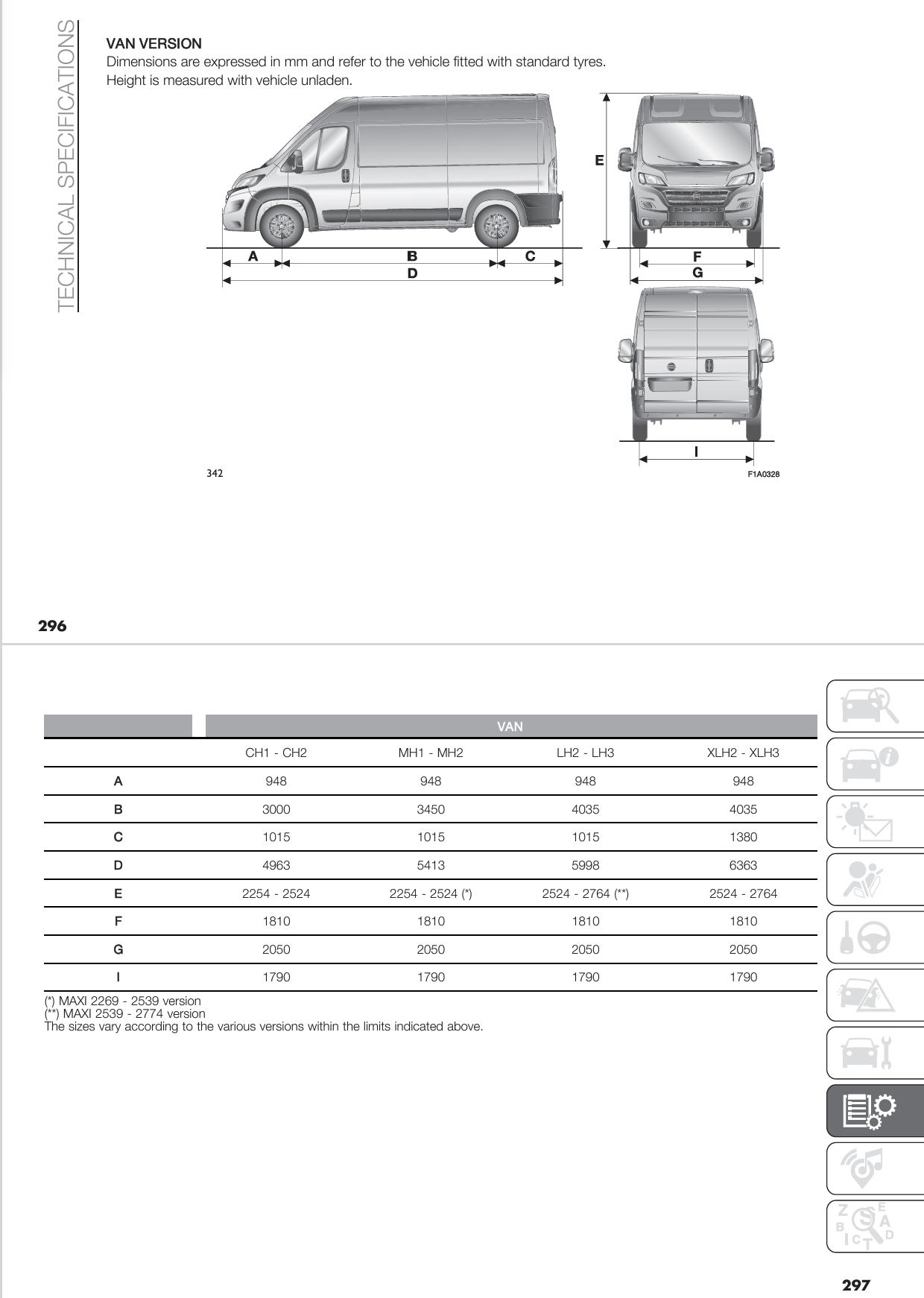

Which takes me back to my original question (which might have been more useful without my cockup with the height dimensions) What's the actual height of yer standard PV (Ducato/Boxer/Relay) used for run of the mill conversions?
To be sure you are probably best off measuring it yourself to remove any doubt.
