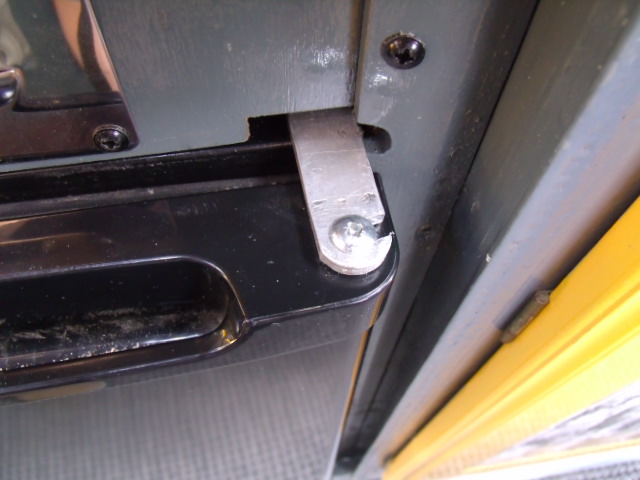

Why do folk try to make things harder than they need be. I have a household fridge with separate freezer compartment, cost about £100. Held in place with a simple bracket fitted to the alternative door position threaded hole on top of the fridge. Cheap adhesive child proof catches on both doors. It never gets turned off and is sometimes used as an overflow fridge when our house fridge is full or just to keep the beer cool.
If you have sufficient battery/charging then to me it’s the obvious choice.
