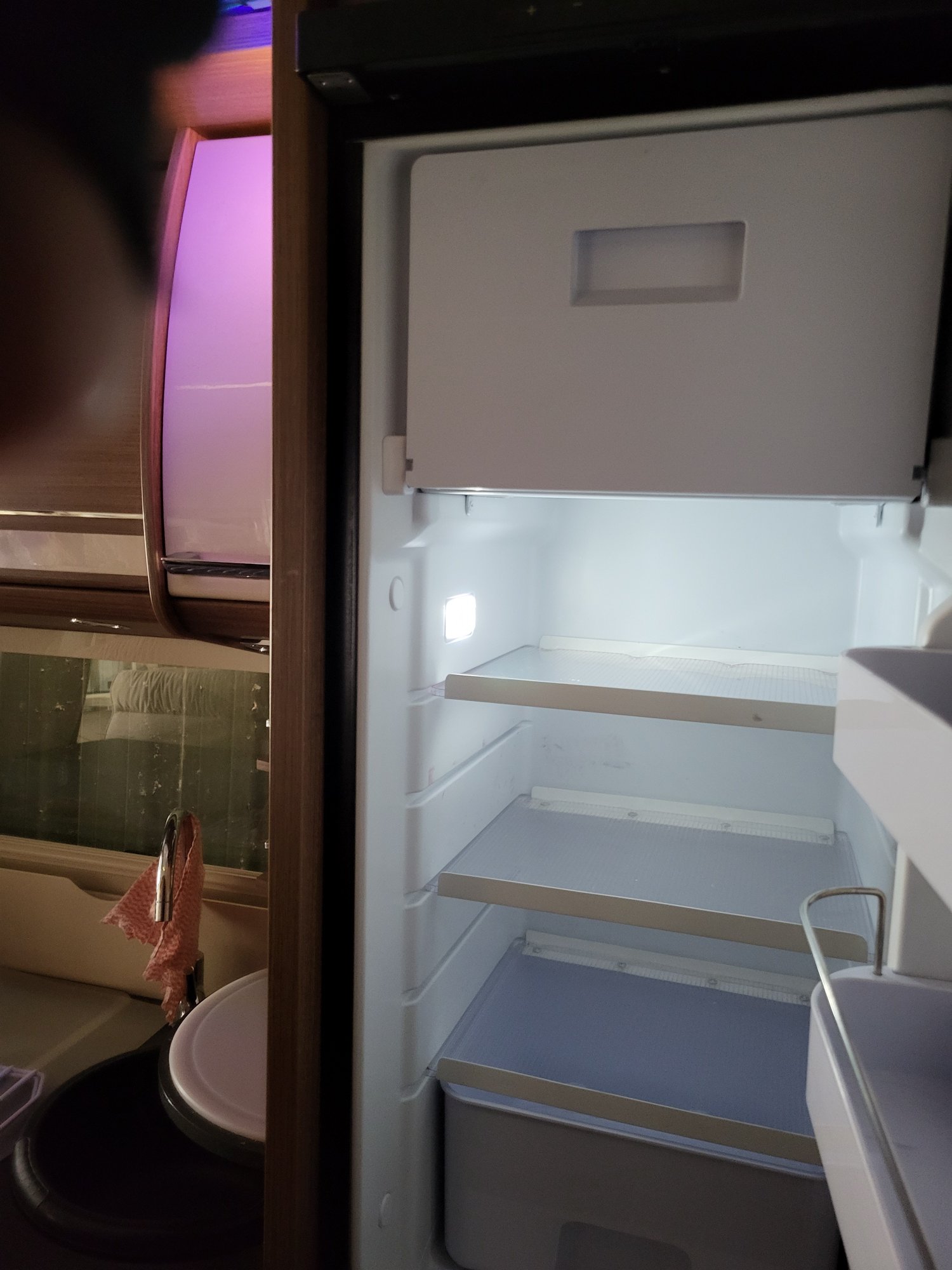

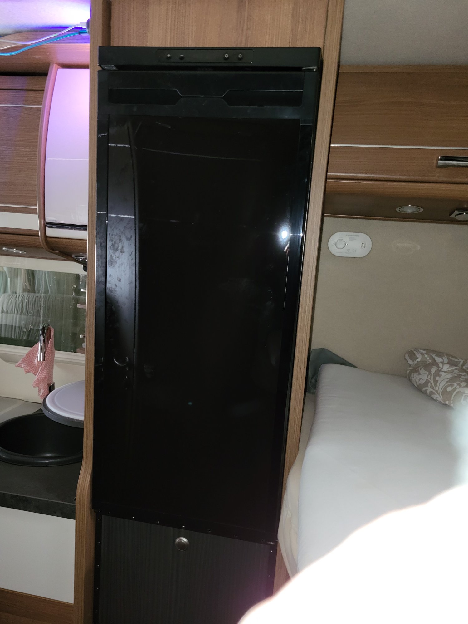

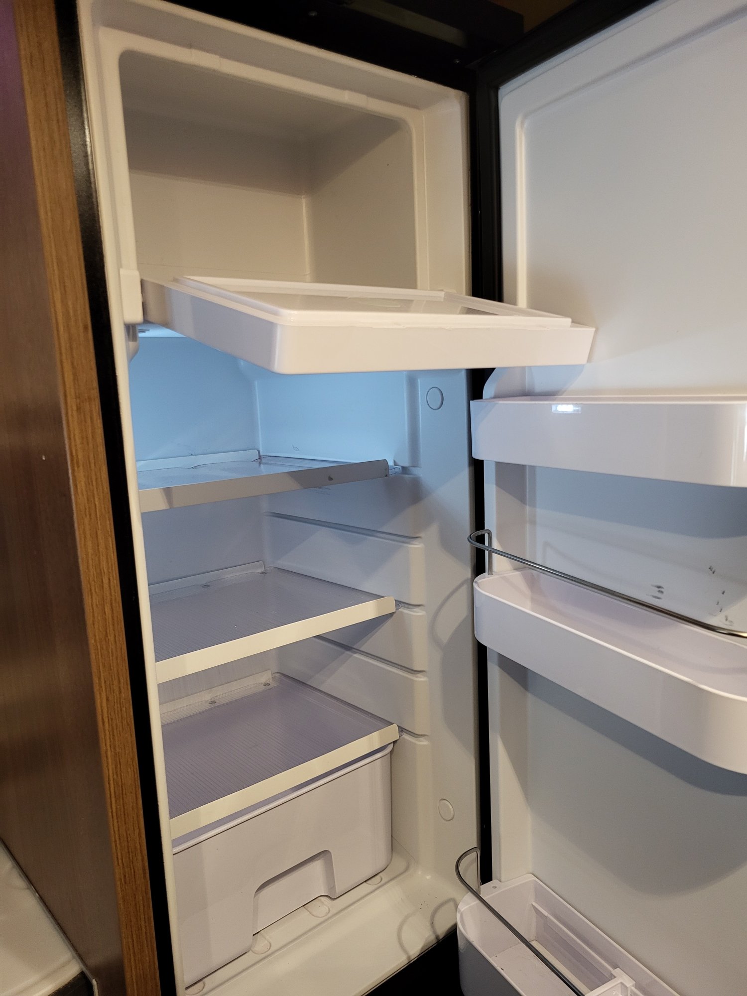

Here are some photos. The only non-standard items are the shelves. I changed the plastic coated wire shelves with 6mm twin wall polycarbonate sheet with white 20mm plastic angle front and back. As well as stopping items falling out the angle stiffens the polycarbonate. My reason for doing that is that the wire spacing was sufficient to allow narrow tall items like yoghurt pots to topple over. No problem with that using a smooth flat surface.

That looks great, and what we would be looking for in the future (still looking for a suitable motorhome). Thank you for your help🙂👍
No problem. If you need any more detail when you get to installing let me know.
