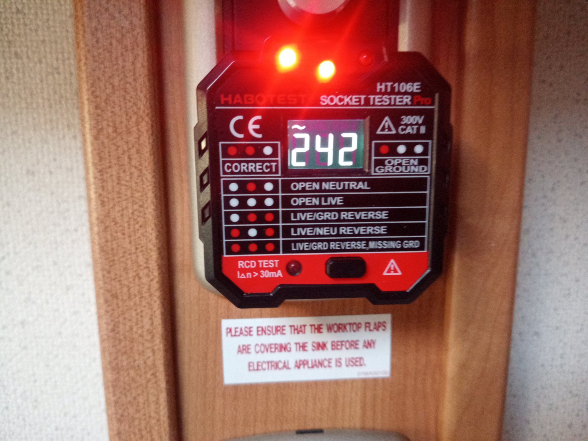

This is pretty typical where I am. It very rarely ever drops below 240V and if it does only to 239V.
