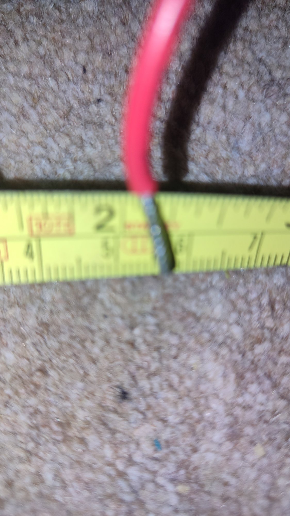

I've read on here about issues being encountered with startup of compressor fridges, and the advice seems to add up to fitting 6mm sq wire. However, in the instruction manual it specifies 14AWG for a run of up to 6m (about 2mm sq). For a run of up to 11m it says 12AWG (3.3mm sq). I am all prepared to ignore this and follow the advice for 6mm sq, but I am puzzled by the small size of the wires fitted to the fridge that I would have to join the wires to - I don't have the equipment to find the size, I'll try to add a pic to show it.
My questions are, firstly is that small diameter going to create a bottleneck making it pointless using 6mm sq wire, and secondly how would I join two wires of such unequal diameters?
Using oversize cable will minimise total voltage drop. In any situation where voltage drop might be an issue choosing a size or two bigger than that specified will help. Sometimes electrical devices share a feed from the fuse/ circuit breaker panel and having a second device turned on will add to the load increasing overall voltage drop on that feed.
The only down side is added weight and wire flexibility, neither of which is relevent in your case.
To join wires of differing diameter there are many options. You can use a terminal block. I would solder and heatshrink for a neater and more permanent result.
Thanks for the reply. I think I'll go ahead with the 6mm sq. I guess the relatively short length fitted to the fridge will be less of an issue with voltage drop, but it seems to me that it's longer than it needs to be
