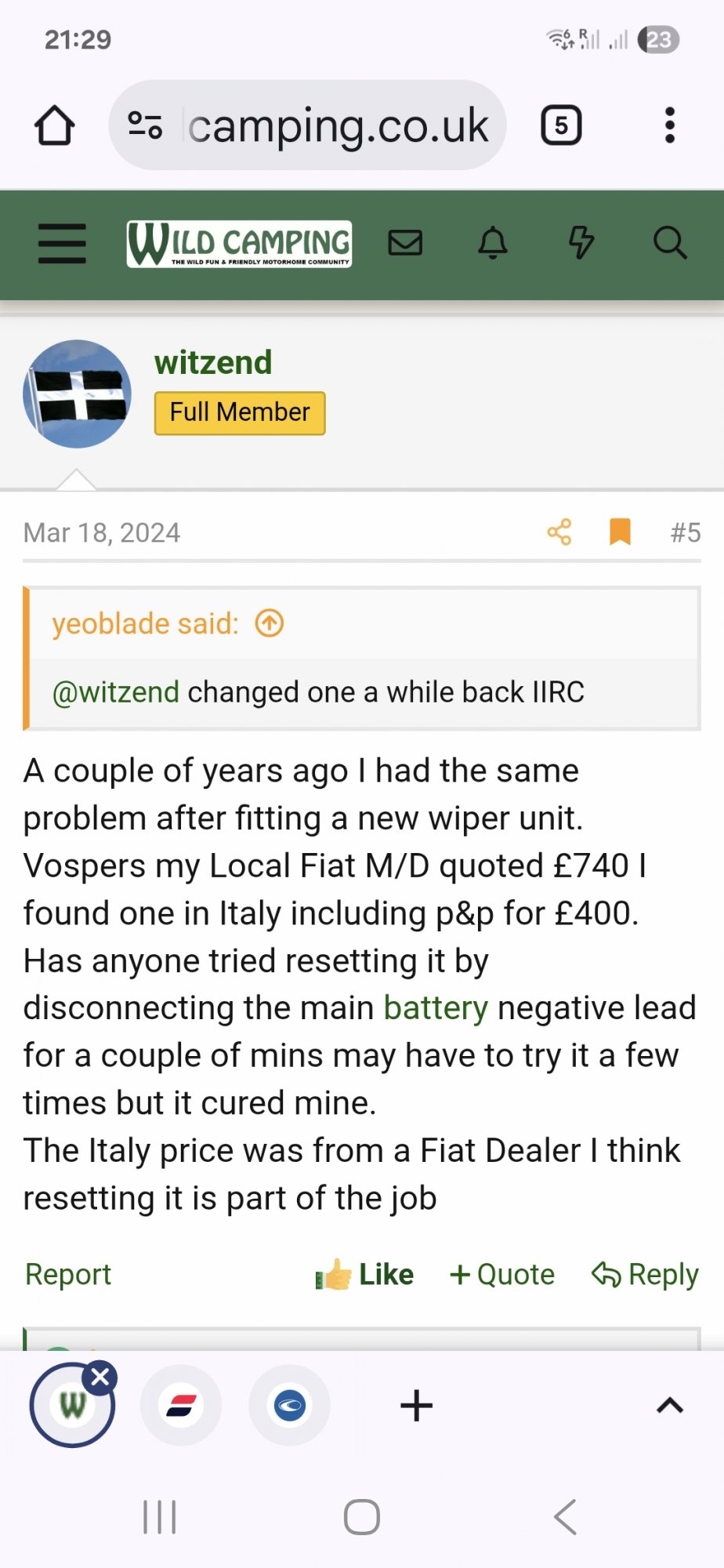

Son in law had same on his VW T5 a couple of years back . I spent an hour trying all sorts in the cold and wet . Last resort disconnected the battery ( as others have said) , had a beer and warmed up, reconnected battery and hey presto working 👍
