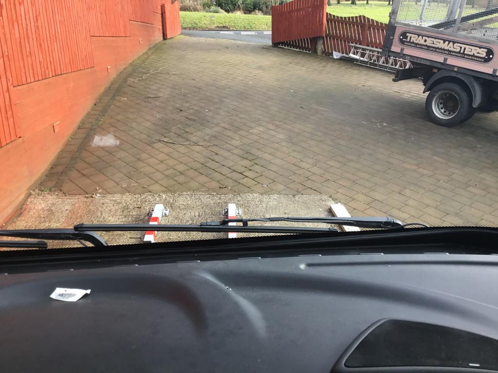

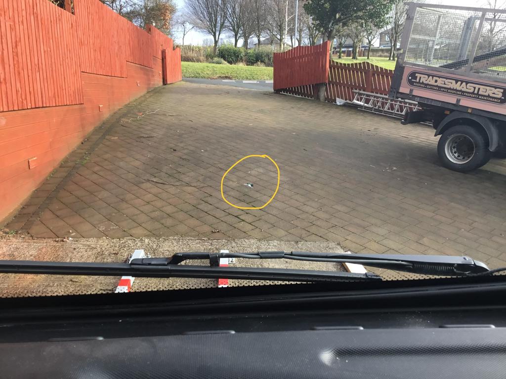

6E0FC4B9-B9DE-426F-B965-C804FC399A10.jpgOn my way home yesterday picked up a nasty chip on windscreen right in front of driver seat about 7 inches from bottom I’ve never had a windscreen repair done or dose this screen need replaced seen all these adverts about repairs but not sure anybody had this type of repair doneC6D3C6C9-91A4-4050-8F57-3549B309F99C.jpg
Yep, had repairs done on several vehicles including Motorhome, usually through insurance, repairs don't cost but windscreens do. :wave:
Wouldn’t wait too long incase the chip becomes a crack then it’s window replacement
Had two done, both almost invisible repairs and no further issues and the insurers covered the cost. I would get any chip done asap, particularly in winter.
Had 2 repairs and a new windscreen fitted in the last 3 years, all through insurance. The repairs were free but I had to pay £100.00 excess for the replacement screen.
As others have mentioned get the repair done ASAP. Last year at Applecross I had a chipped screen which developed into a crack the following day. The crack extended by at least 10mm daily but I decided to just wait till I got home for the repair.
Get it done asap before grit gets in. Many insurers will allow you to get repairs done foc through the appropriate Winscreen company. If not, you can buy chip repair kits from Autofactors for about £15. I used one on My Alfa for a chip like yours (the car didn't have windscreen cover) and it lasted while we had the car (5 years). I thaw out my screens on frost mornings with hot water so the repair kits certainly work well.

Had a chip last year a week before going to France for a month. It was in the same place as the OP photo shows. It was a Hymer a class. I checked with an mot station and they said they would pass a repaired chip in that area. I phoned insurance and there was no talk of repair, they immediately booked a replacement. The screen had to come from Belgium. Auto glass replaced it with no problems, needed 2 people to do it so needed a little more organising than usual but they did it two days before we went away. A good clean and tidy replacement, £70 cost to me
Just checked insurance i pay First £70 in the case of repair. £100 excess in the case of replacement and no limit to the cost of new one checked my old policy with my last van and it had a 2k limit. They say doesn’t effect NC discount and will not effect future premiums. I’ll hold my breath on that one. Got someone from auto glass coming out to have a look tomorrow.
I've had my Hymer windscreen repaired twice now by Autoglass.Contrary to what has been said a repair does not count as a claim on the insurance,you also don't have to pay any excess(I didn't).There are strict criteria about whether the chip can be repaired or not,it depends where the damage is and how big it is.Have a look at this short video..................Windscreen Repair - Vehicle Windshield Repairs | Autoglass(R) UK

Cheers Gordon insurance company sending guy from auto glass tomorrow. Reading the posts back repair doesn’t seem so bad and on some of the videos actually looks great. See what he says tomorrow think the glass company would prefer to replace more dosh for them insurance would rather repair cheaper for them
But I don’t give a toss about them if repair can be done and not noticed I’d prefer that too them ripping screen out don’t know what else gets damaged or disturbed in The proses so gona push him to repair it first if not pleased it could always pick another chip up somewhere. Thanks for all the advice guys it was all good and positive stuff cheers wully
Your quite right as it’s a bonded screen and has to be cut out with like cheese wire then glued back in. Had two in trucks had to get taken back out as they had left some gaps and the wind noise was unbearable
