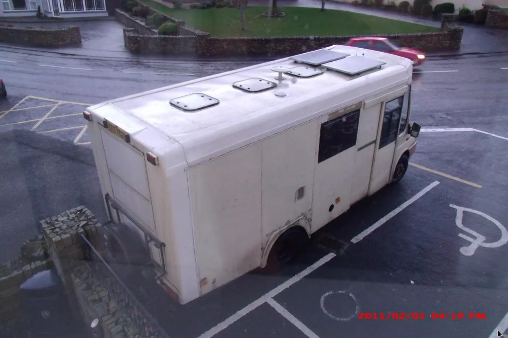

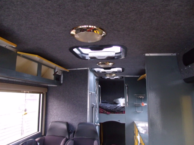

The roof lights in factory vans is pure sh one t, if you could get your hands on a bus type and cut the roof to fit it will be a better job by miles, they can open any end up or both up same time, they are bomb proof.

The roof lights in factory vans is pure sh one t, if you could get your hands on a bus type and cut the roof to fit it will be a better job by miles, they can open any end up or both up same time, they are bomb proof.View attachment 138929View attachment 138930
Quite so. Our 73 VW 1.7L Devon had a push up from any direction square vent on a sturdy spring loaded mechanism, and could be left open rear up front down whilst on the rd no issues. Try that with Remis!
