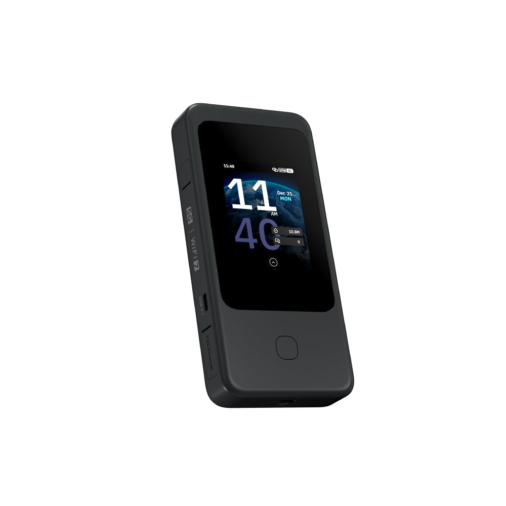

If buying now, I would certainly look to a 5G unit for futureproofing. The last time that I looked for a Teltonika 5G unit, they were very expensive. 5G MiFi units vary in price and many of the cheaper units that claim to be 5G are in fact not 5G mobile data but 5GHz WiFi signal. I am currently using a ZTE U30Air (5G/4G/3G) and finding it generally very good. There have been a couple of places where I have had to specify the generation of signal that I wish to use for stability of connection, which I put down to (SFR) network coverage.

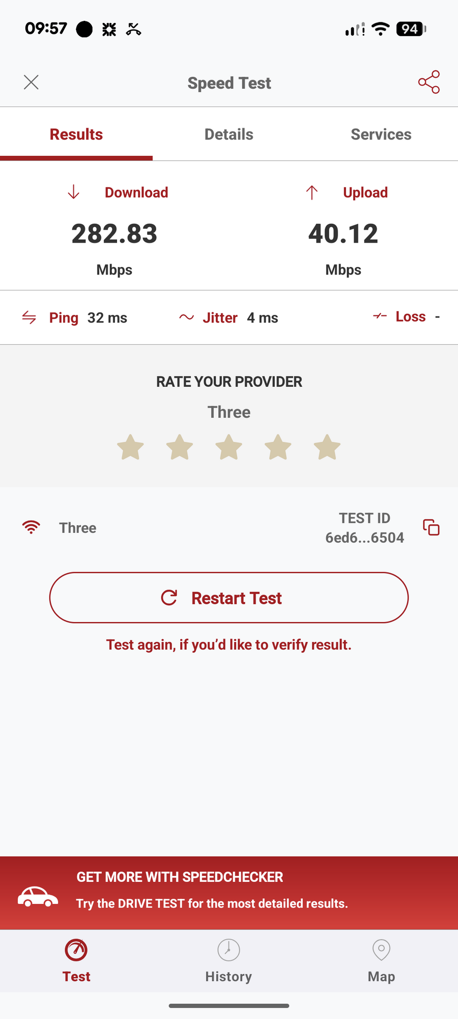

We've just ditched our broadband supplier and bought a cheap £50 ZTE 4g router and a 3 unlimited data SIM for £15 a month, pretty decent speeds with the built in antennas on the router because we're only about 300m from a mast. I took the router out of the house and put it into the van (it's 12v too) and connected it to the 4g antenna which I have on the van roof.
Decent speeds for a camper!
