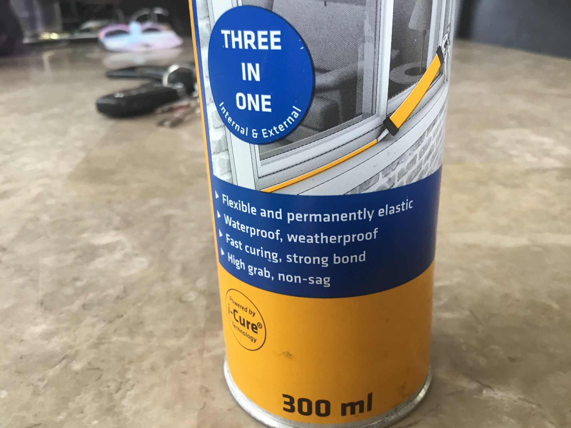

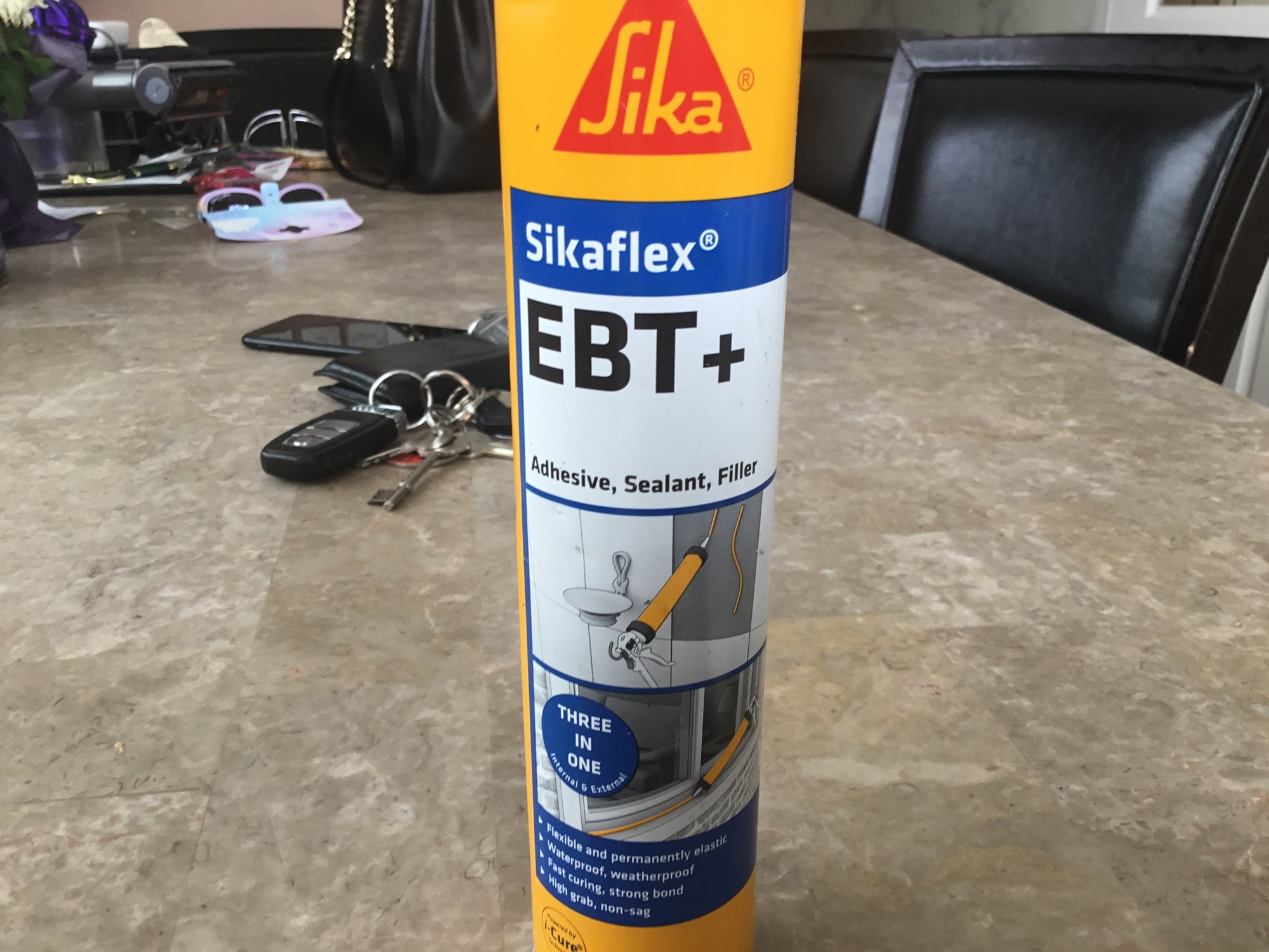

My concerns with sikaflex is it's adhesive properties as the trim I have removed may need to
