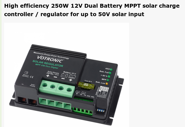

I would suggest an MPPT controller would be your best option. Quite a few brands around to select from.

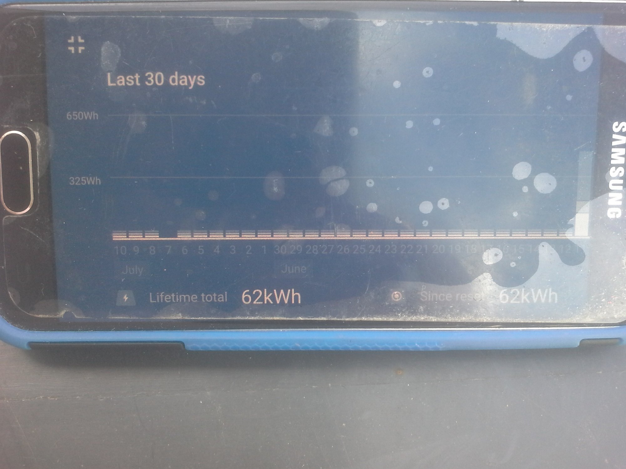

Are you running different size solar panels ? . As that is a good reason for 2 controller's . but if you're not , go big 30amps ! On both . But Panle Space on roof makes, the price you pay ££££££. I found my 2 x 100 watt panels next to each other system with victron 100/30 sc plenty if running gas. Pannal van roof Size is 140 x 100 cm across van so no over hang. Other go for 1 big panel to extremes and over hang both sides. But they mite have tv and no led lights or best price they found for space ! mines what I already had from old van. With the victron controller as upgrade.
