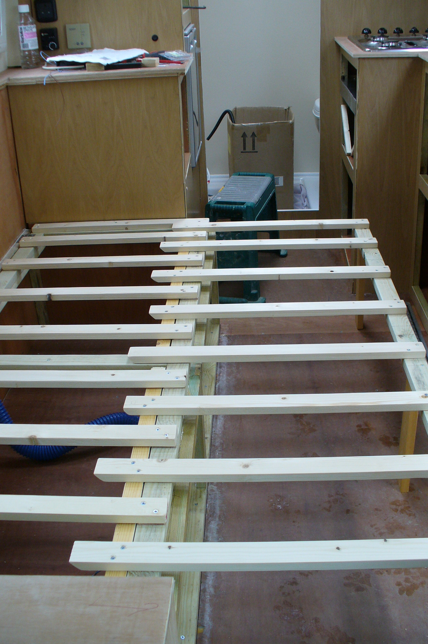

As for your height and bed requirements, I hope you aren't one of these people who have to have a space wasting fixed bed when a properly designed and constructed folding bed can give you almost any length of bed whilst at the same time doubling as a large, comfortable and oh so useful day time sofa, and as for some people complaining they take too long to make up/convert, our sofa/bed takes little more than a minute to either make up or down.

And that bed looks too small to me, two singles are easier to make, provide 2 x the storage and much more easy to build just a box with a lid.

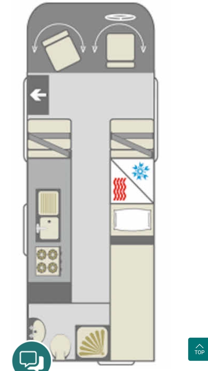

Thanks Phil, some useful info on van pros and cons. In my previous sprinter, I built a bed like yours opposite the opening door, this time thinking of a shorter seat in this position, 2 bunk beds along the same side but one above the other coming back from the rear doors. I'm too tall to sleep across the van without the cutout - pod/bulges on either side. Have you come across anyone on this site who has done a similar design?

Thanks Phil, Have you come across anyone on this site who has done a similar design?
Have a look out for @Squiffy or yet another Phil, he has built 2 x L4 Sevel vans, but I don't think he has bunks.
Are you going to be fitting a shower/loo as well in your build?
