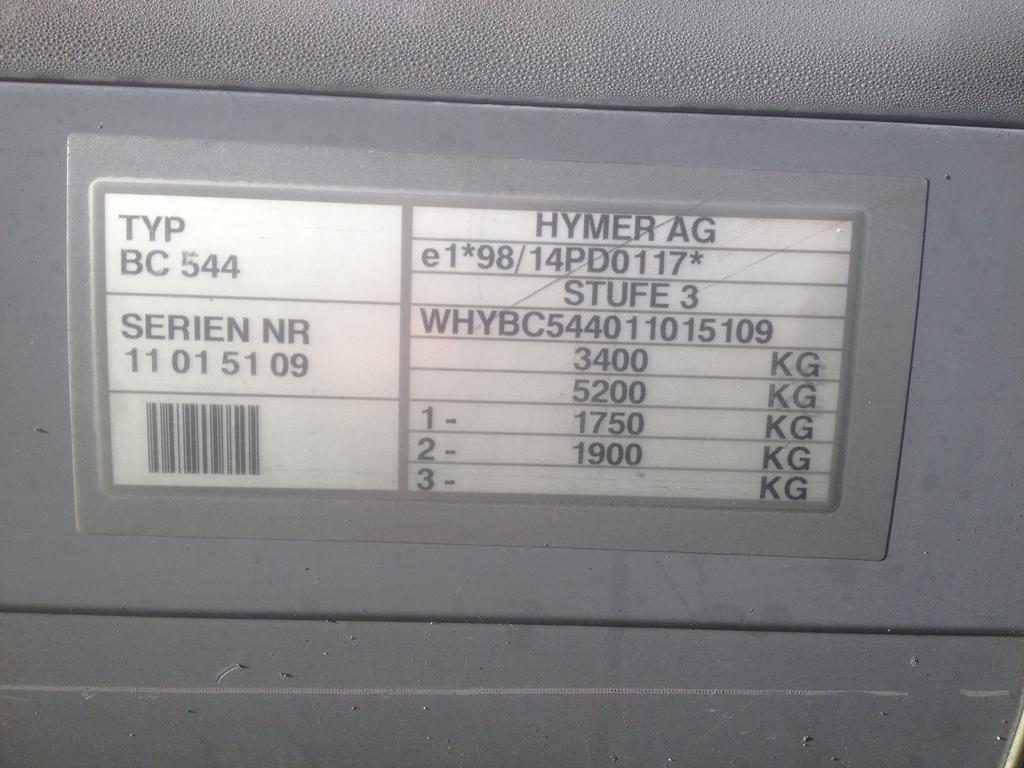

As I approach the 70 years threshold, I am showing an interest in the weight of our Hymer. Can anybody tell me what information this plate is supposed to convey to me?

Yes Channa, I agree about the 3500kg restriction for the prime mover but this can be exceeded with the trailer! (for pre 1997 licences) BE
from link
For those drivers who passed their category B+E Practical Test on or after 19th January 2013 there is an upper trailer weight limit of 3500kgs MAM. For those drivers who passed their B+E Practical Test prior to this date there is no defined trailer weight under category B+E except that which is governed by the towing capacity of the towing vehicle. For all category B+E licence-holders there is a maximum trailer length of 7.0 metres and a maximum trailer width of 2.55 metres.
Drivers who passed their car test before 1 January 1997 normally will also have category B+E entitlement.
Not without an eyetest it can't...A licence will be reissued but with post 97 conditions
lifted from the NCC website
To check the licence you need to drive various types of motorhome, and any age restrictions, see the official Goverment website advice.
•Drivers who passed their test before 1st January 1997, can drive a motorhome weighing up to 7,500 kg MTPLM/MAM (Maximum Technically Permissable Laden Mass/ maximum authorised mass) on their B licence.
•When that driver achieves the age of 70, they can retain the right to drive a vehicle of up to 3,500 kg MTPLM on the same basis as for a car i.e. three year renewal (see also note below).
•If the driver wishes to continue to drive a vehicle over 3500kg at 70+, they must pass an eye test and submit the medical form D4, completed by their doctor, with their renewal application
•If a driver passed their test after 1st January 1997, they can drive a motorhome of up to 3500kg on a B licence
•If the driver wishes to drive a motorhome of 3.501 kg MTPLM - 7500kg MTPLM, they must take an additional test to obtain a C1 licence.
•For all drivers: Over 7,500 kg MTPLM a full C driving licence is required, which in turn means passing the relevant C test.
Licence Definitions
Category B
With this category on your driving licence you can drive vehicles with a maximum authorised mass (MAM) of up to 3500 kilograms (kg), with eight passenger seats, and with a trailer no heavier than 750kg.
It's also possible to tow a trailer heavier than 750kg if the MAM of the vehicle and trailer together is no more than 3500kg. The trailer must also be lighter than the vehicle towing it.
To tow a heavier trailer than mentioned above you'll need category B+E.
Category C1
With this category you can drive vehicles with a MAM over 3500kg but less than 7500kg with a trailer no heavier than 750kg. To tow a heavier trailer you'll need category C1+E. Note: A recent European Directive allowed for relaxation of the complexity of this C1 test for motorhomers, in recognition of the fact theirs is a private vehicle for leisure use. This 'Code 97' change has, however, not yet been implemented in the UK.
Category C
With this category you can drive vehicles with a MAM over 3500kg with a trailer no heavier than 750kg. To tow a trailer that weighs more than 750kg you'll need category C+E.
All as clear has mud !!!
Channa
