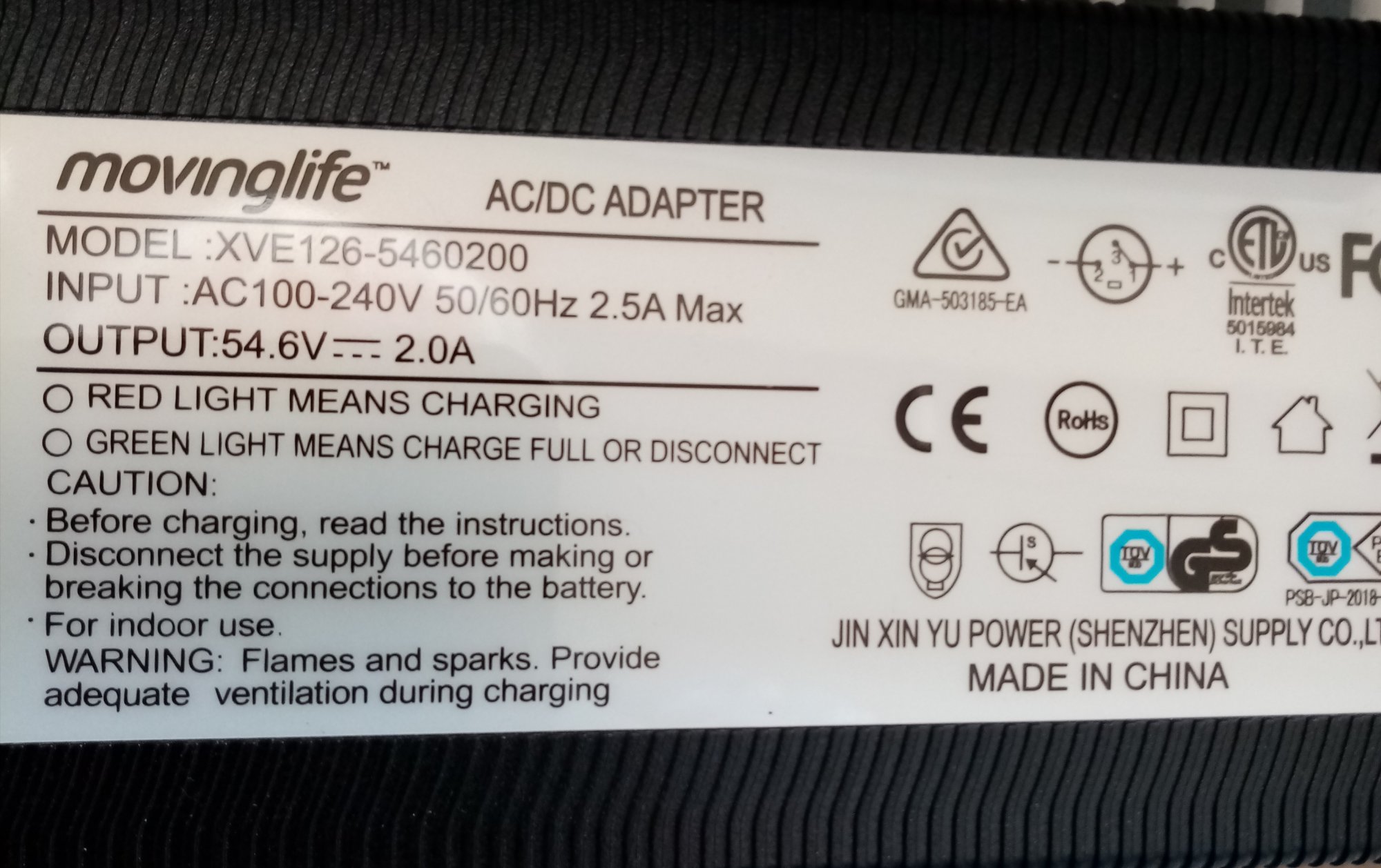

This is a pic showing my scooter charger. We aren't considering long trips so charging the power bank will mainly be done before leaving home.

The charger plate shows 230v & 2.5a (600w.)
The inverter (built in or external) needs to at least 600w and preferably 1200w.
Therefore, in my opinion, in the Jackery range only the 1000 will suffice and will not need a separate inverter.
r4dent, I'm afraid you are incorrect, the charger plate shows a max of approx 250watts max, not 600watts as stated by you.
The 2.5a max would apply at 100vac input.. Hope this helps..
With respect I think it is you that is wrong.
There is no mention of watts on the charger plate just volts (100 - 240) and amps (max 25).

The higher the input voltage the higher the current (as per Ohms Law) so the 2.5 amp will be when the input voltage is 240v.
Using the Electrical Power law, the power is 2.5 a x 240v = 600w
If the input voltage is reduced to 100v
The current will be reduced (Ohms law) the power produced (Electrical Power law) will be reduced and thus the scooter battery will take longer to charge.
This is illustrated by people using an air dryer in countries using 110v mains, when the operation takes longer.
The output of the charger is 54.6vdc at 2A which = 109.2watts. The electronics converts the AC input voltage range of 100 to 240ac down to this, the highest current draw from the AC input will be at 100vac. The 2.5A max is allowing for surge current at switch on.

I think you will find you are wrong, the amps will be at 100v, at 230v the amps will be less, I've measured this on several chargers in the past.
I've posted this before, the best indication of power required is 'output + a little', so 109.2+, in which case 150w will be enough, but 300w is a common low powered invertor and be well up to job.
True.
The inverter needs to support the input power for the charger not the output power.
The input power will always be greater than the output power.
Some input power will be "lost" as heat / sound. No charger is 100% efficient
The only time output exceeds input is nuclear, where the output power is derived from the conversion of matter to energy (e=mc^2 and all that)
When the Battery charges the current drawn will taper off it depends how good the chargers BMS is..
Yes, but any inverter needs to deal with the surge.
I believe this means that the inverter should be be capable of providing 600w.
The OPs question "was what size inverter is required?"
My answer is 1200w, because this is the smallest commonly available size over 600w. A 500w may be up to it, but I would not recommend this option.
