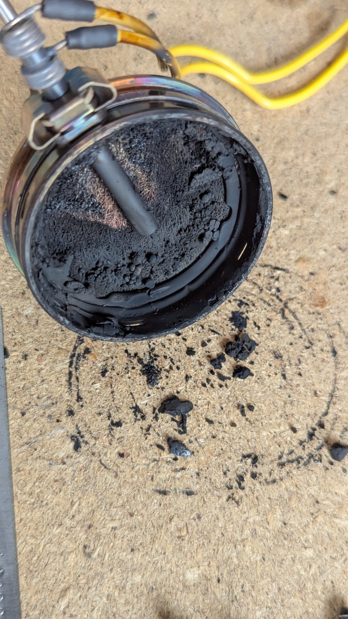

Just got back from our five day east coast heatwave escaping excursion during which we discovered the webasto heating/water unit won't fire up, the unit throws a 'failed ignition' fault, while it was trying to ignite I noticed and smelled black smoke coming from the exhaust.
Took a look on the internet last night and frightened myself with the cost of replacement and or spare parts so today I've decided to try and remove the thing (it's underslung at the rear of our Tribute PVC), take it to bits and see what's occurring.

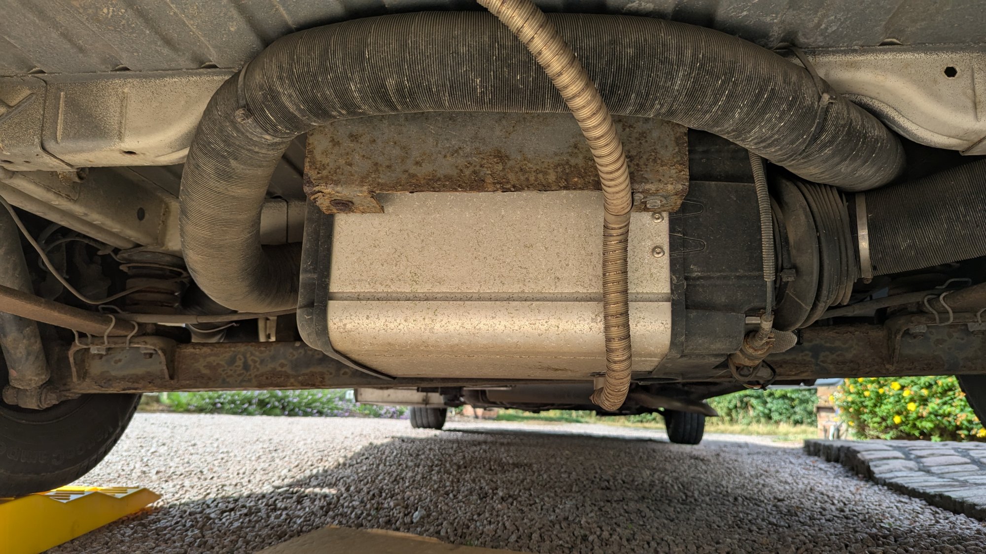

Is that exhaust running uphill ?
They should usually have a fall to prevent build up of condensation from combustion gasses ..
Unless it's got a weep hole at the lowest point
Pretty sure it was, thanks.👍

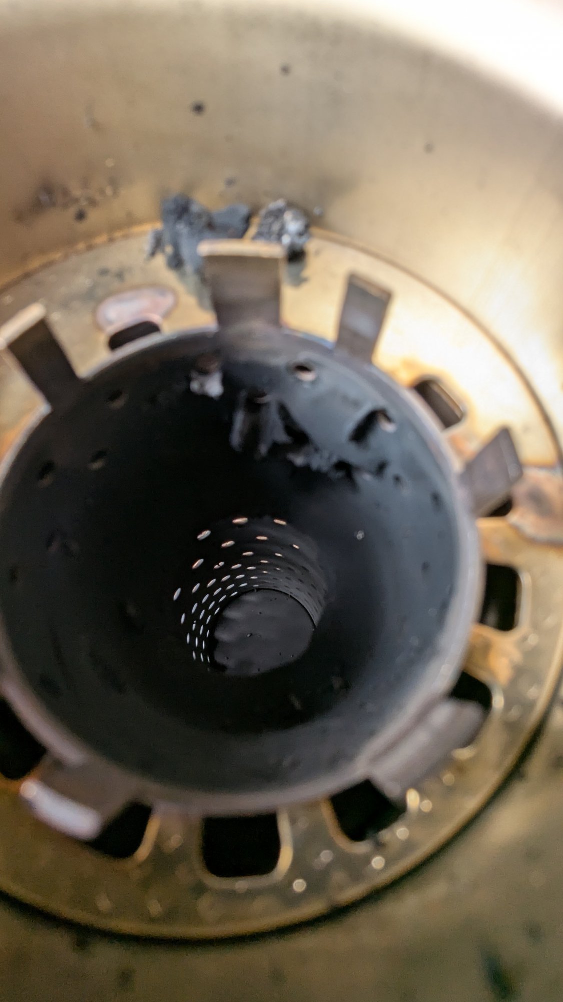

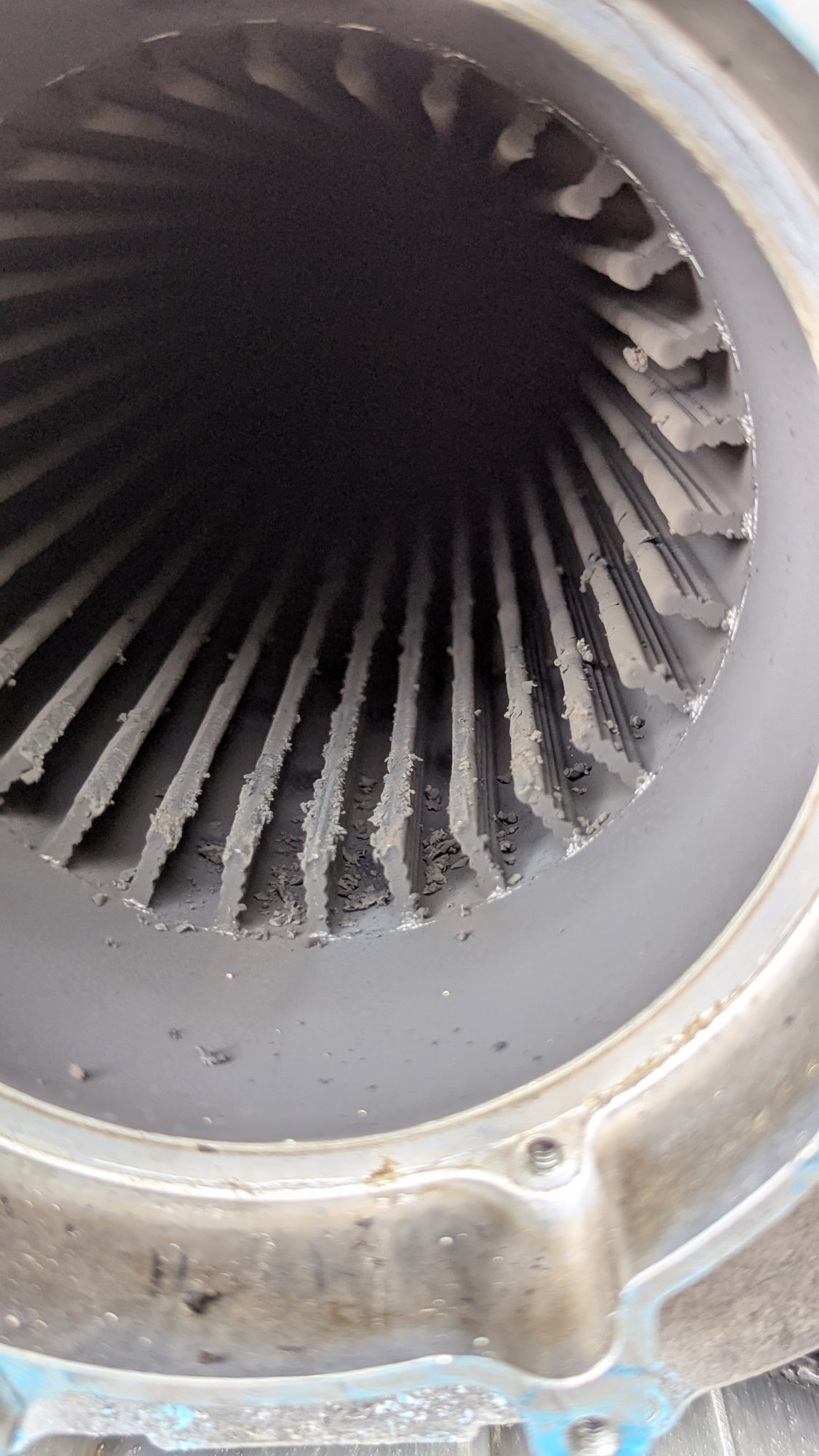

It hasn't been too bad TBF. Looks like a build up of crud and soot in and around the burner.
Going to give it a damn good clean up and if that doesn't work then it'll be a damn good thrashing Basil Faulty style.

Takes a surprisingly small amount of carbon build up to stop the fuel vapourising correctly and the glow pin to fail to ignite it (usually with associated coughing and white smoke)
The carbon is usually the result of the additives in modern fuels....
It's why kerosene/parrafin/jetA
Results in a usually spotless burn chamber.

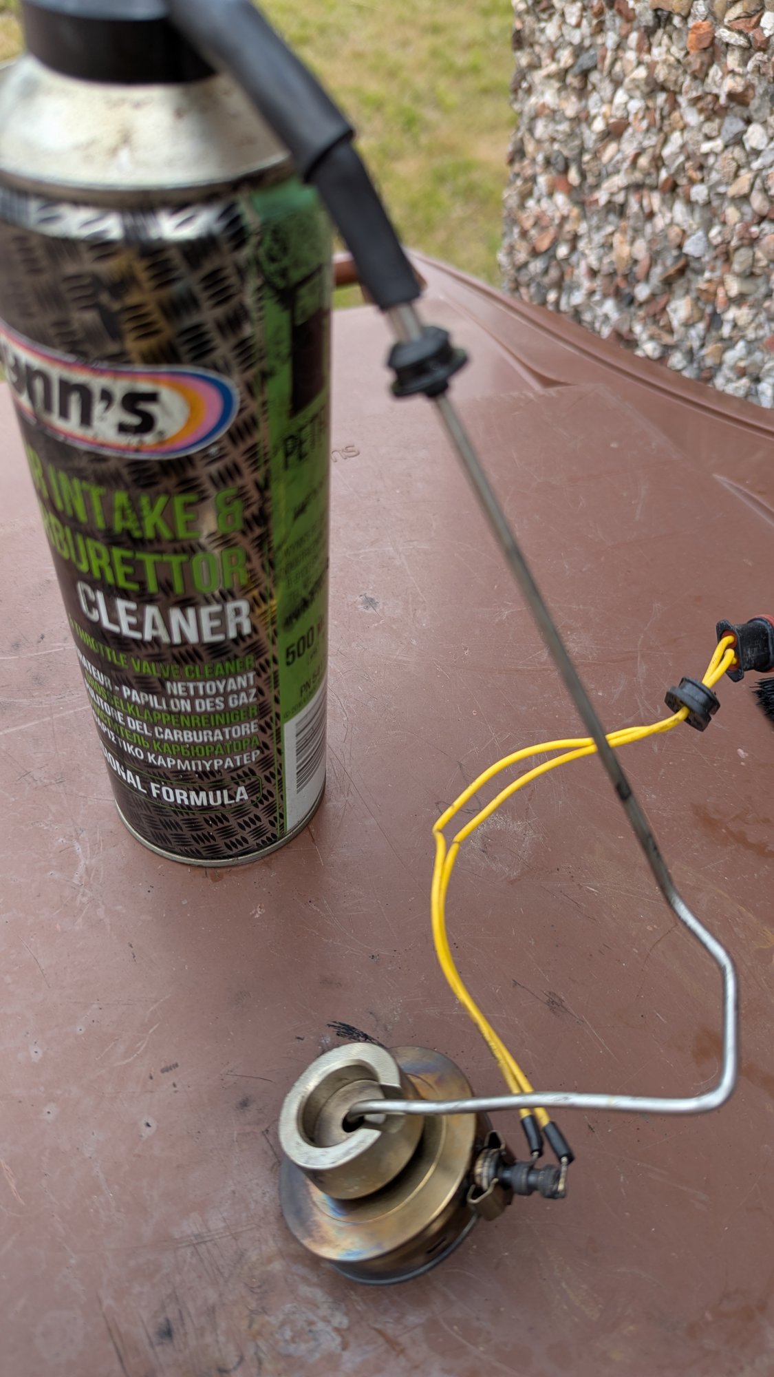

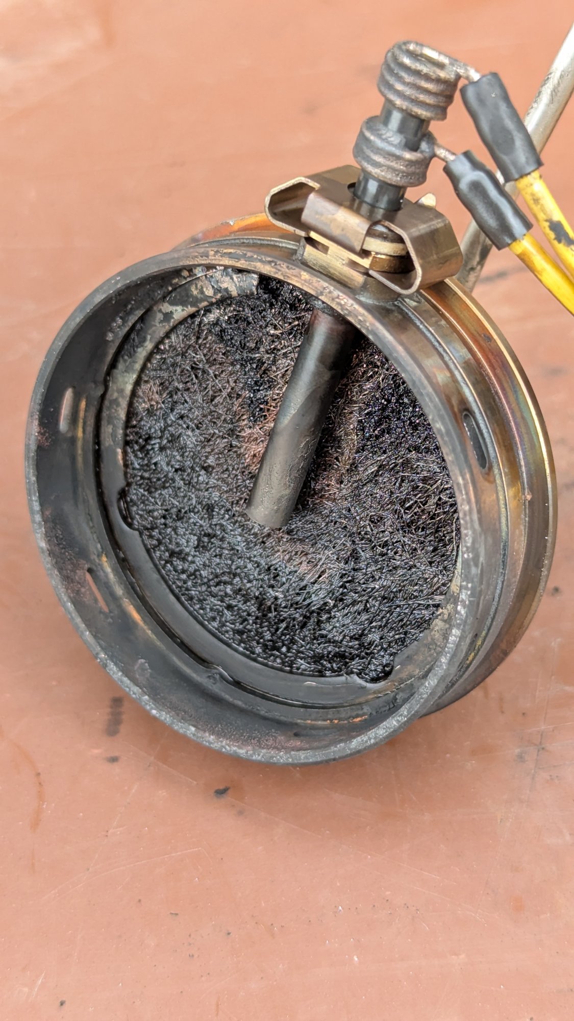

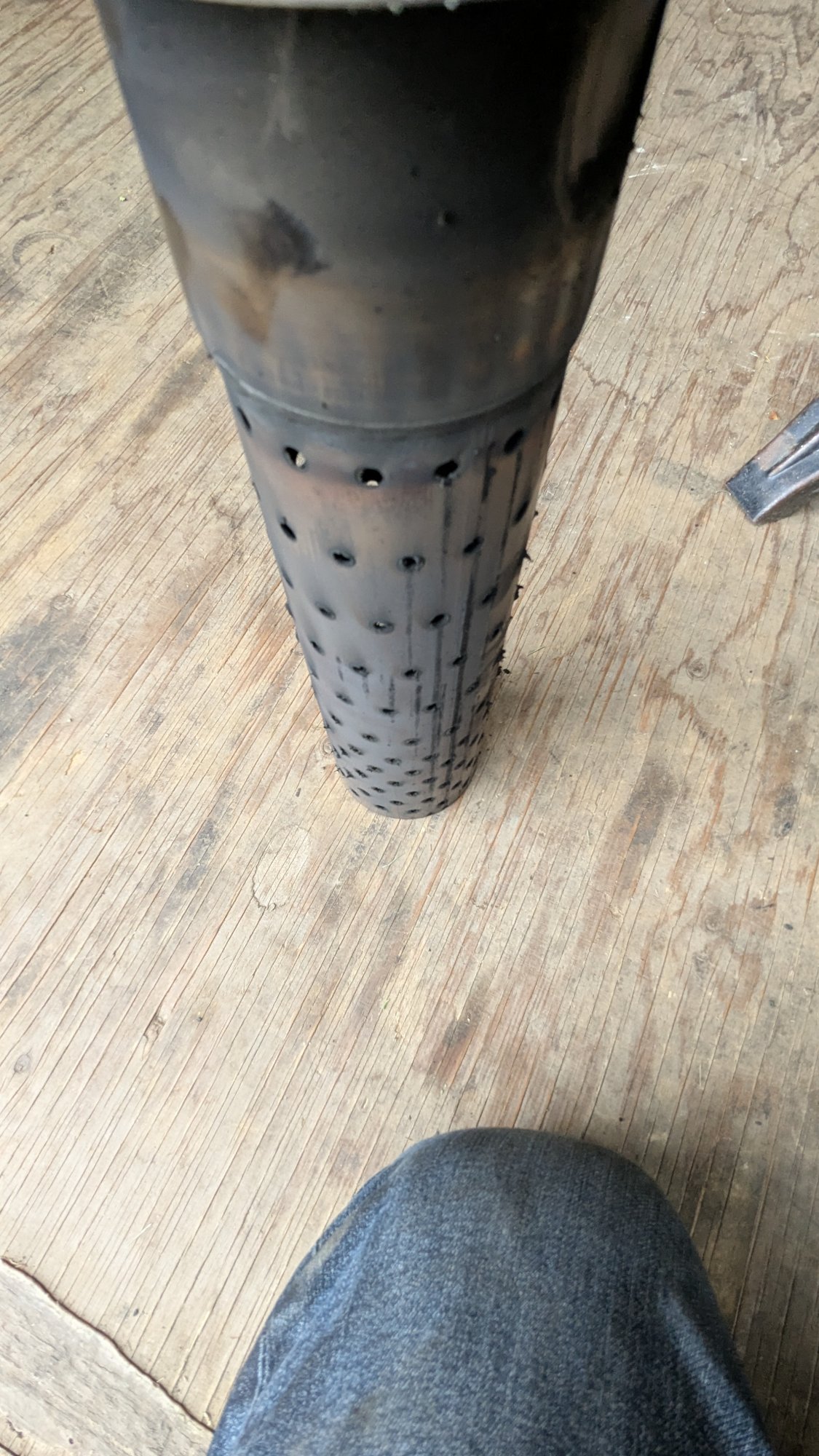

So gave everything a good clean up with brushes and an airline, now I'm covered in crap.
Gauze and glowplug was by far the worst area, scraped the thick off then soaked it in petrol for an hour then a gentle scrub with a stout brush and then blasted a whole can of brake cleaner through the gauze in the right direction via the fuel line. Took quite some time before the cleaner ran clear so hopefully the gauze is clean enough to last a few more years?
Yes, it's running uphill and you're correct, according to the installation instructions the exhaust should fall continually to prevent condensate being trapped. There's not a lot I can do about it because the exhaust exits the heater at the very bottom and is already very low and the lowest thing on the van (apart from the tires!). I'm wondering that maybe because the exhaust, which is quite long, actually falls all the way back to where the hot exhaust leaves the heater that it's impossible for condensate to gather at that point because its simply too hot and gets boiled away? I dunno but it's been like that for 12 years and doesn't seem to have caused an issue so Im inclined to leave it alone, not sure I want to start making a hole in it??
The instructions also say the exhaust has been terminated on the wrong side of the van too, should be on the offside opposite the hab door which makes sense, I'll probably move that over because it would be far less smelly on the opposite side to the woosh bang and the awning, if we use the privacy room sides the exhaust is currently actually INSIDE the 'tent'! Not Good:eek:
So everything cleaned up, reassembled, back on the van and now working spot on. A little stinky and smokey at first and began to regret not replacing the burner rather than attempting the clean up but after a few mins at full chat the smoke cleared and now it's burning beautifully clean and odour free, I'm now glad I saved myself the £280😱.
While I had it apart I investigated the problem with it not draining which I posted about years ago on here, that turned out to be a seized plunger on the solenoid valve, freed that off, cleaned it, lubricated it, re- fitted it and saved another £160.😱😱.
The two fans need special attention WRT keeping them free to turn, the two yellow cables to the glow plug need to be kept tight back towards the housing prior to fitting the burner fan, also there's adjustment slot mounts on the blower fan and the bezel around the fan on the end cover with two screws that allow the bezel to be adjusted, make sure both fans are free to turn.
