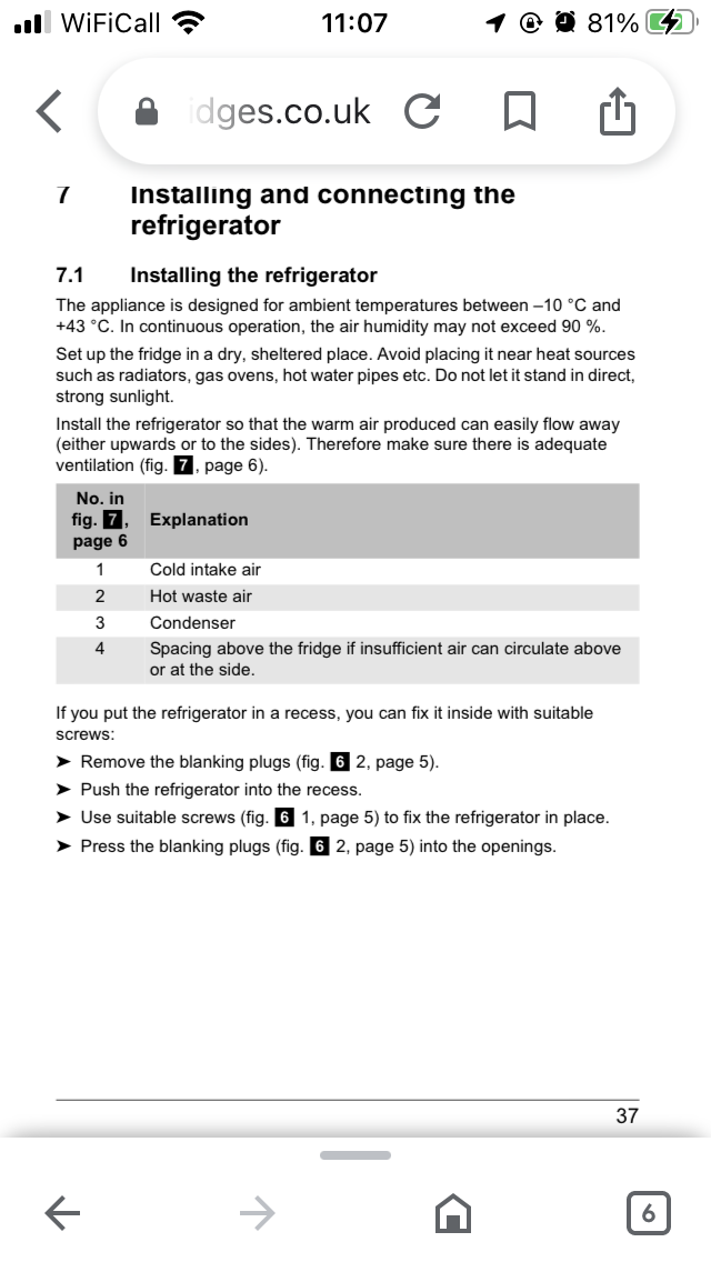

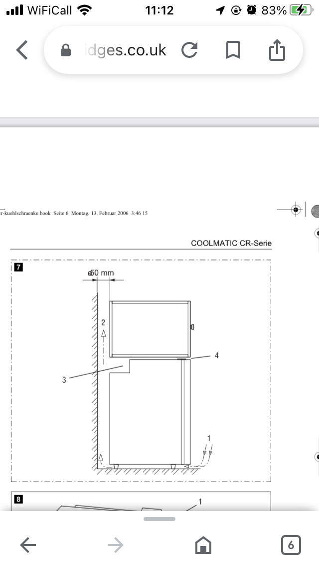

Waeco fridges do need cold air (ambient) and hot air (escape) ventilation access points. See att.

Airflow is always good :) When people say "Venting" in motorhome land, they tend to refer to external ventilation (which compressor fridges don't require) :)
Could a grill be put under the front about 50mm high, and possibly vent out of the back of the worktop or even the side into a cupboard space or void?
