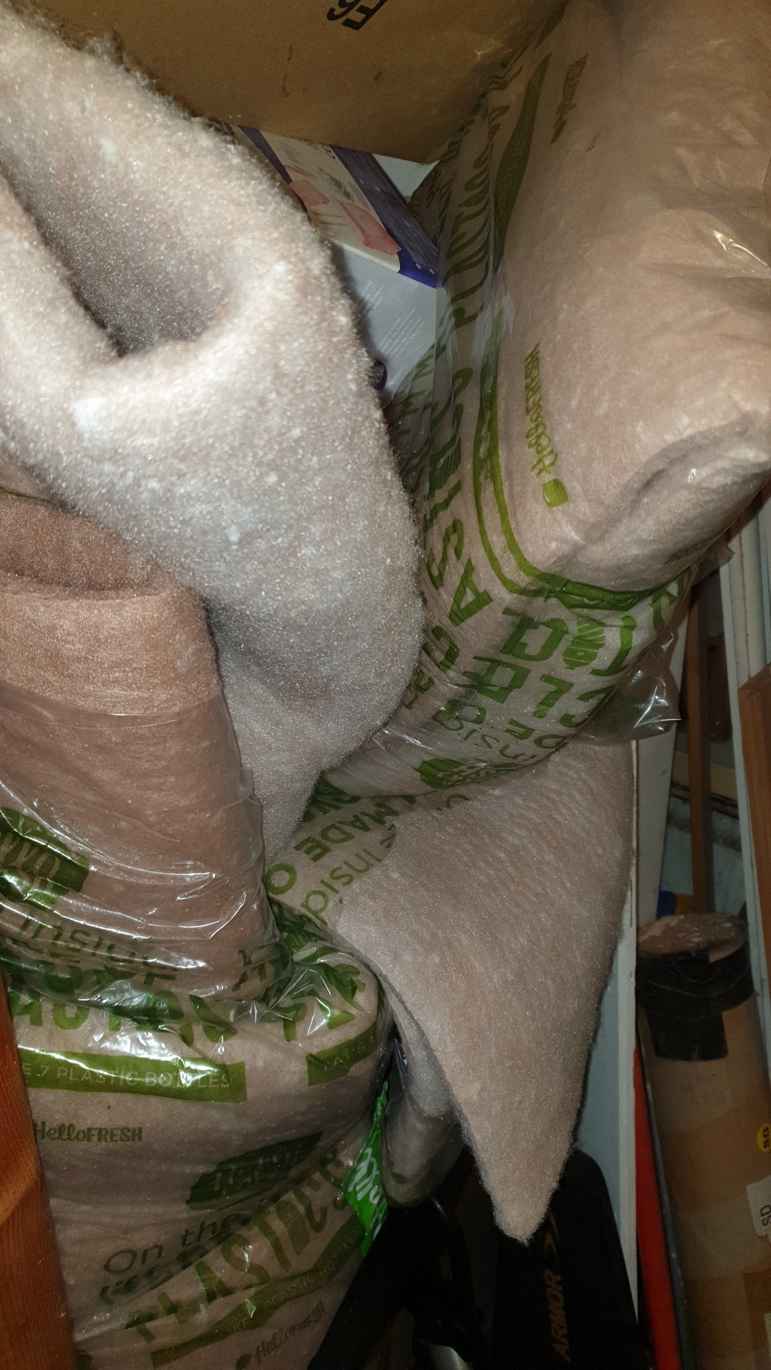

Interesting thread - I have a collection of expanded cell recycled plastic as used by food suppliers to keep fresh food cold, in this case was Hello fresh when we had used them for a month or two. Need to test it see how flammable it may be but was considering using that around the water tank in mine? Thoughts ?
Stick in bucket of water overnight see how much water disappears and how much has been retained in covering or weigh covering first and weigh again following day
