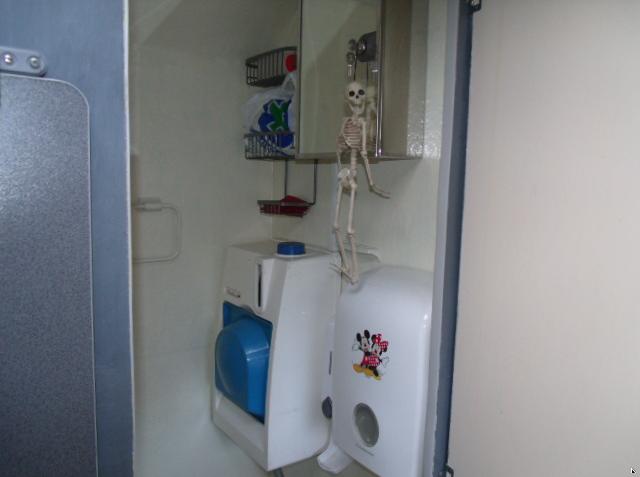

I have one of these 12v units in the loo/washroom, i switch it on from the cockpit when driving, ok of batteries and solar when parked if only lightly used, gas or diesel best if parked up in wintertime.
