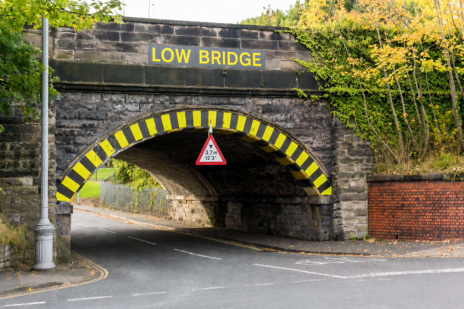

I've not watched the video and have no intention of doing so as these things just bore me. But as an ex-truck driver what I can they you is that in the UK any bridge sign MUST display a height at least 3" below the measured height.
Each authority apply their own minimum "clearance" so the actual height for the same bridge could vary greatly, So a 14' bridge in Cheshire could be signed at 13' and in Hampshire it could be 13'6" and Warwickshire it could be 13'9'
Then things get worse there are 39.37" in a metre, but most authorities use 39" for conversion while some use 39.37" some (to be safe) use 36"
So a discrepancy between feet and meters across the road network is inevitable.
But none of this is generally important in a motorhome or van as the number of bridge restrictions effecting these vehicles is minimum and the signs will always be on the safe side.
This becomes an issue with higher vehicles really, to the point that when running high abnormal loads we used to actually run the route in a van and measure the bridges ourselves in areas we hadn't been before (turning around in STGO Cat3 ain't a joke)
Out of interest the worse County for inaccurate bridge heights was Buckinghamshire by a mile.

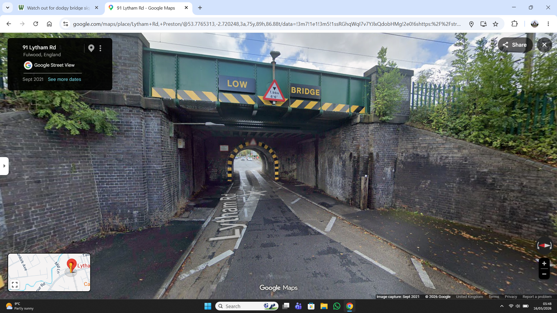

Railway bridge at Cameron toll in Edinburgh gets hit by trucks about 3 times a year . Height is signposted before the roundabout that precedes the bridge .
Not tweaked at all, honest; 😊
No amount of signage can make up for pure stupidity.

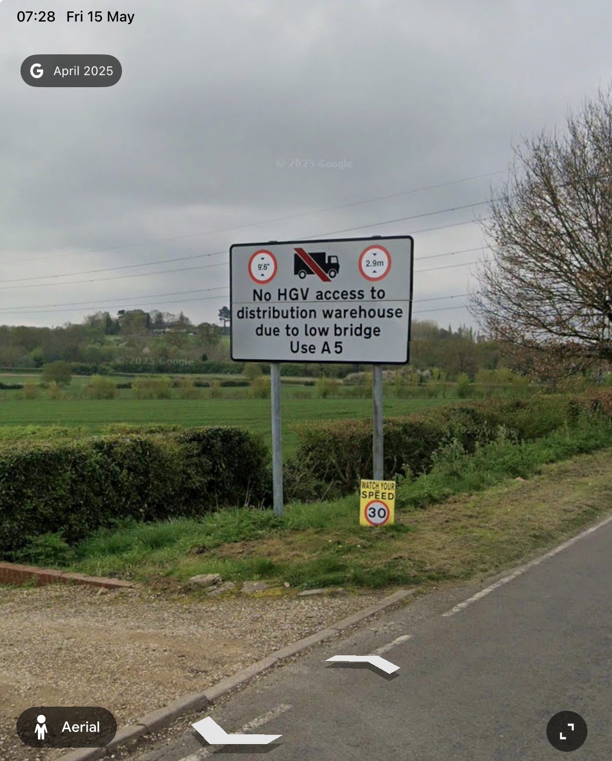

In our village there’s a massive sign telling high vehicles to stop due to a low bridge, then a sign on the bridge, problem is the warehouse past the bridge has been rented by Amazon and their drivers seem to be blind and stupid.

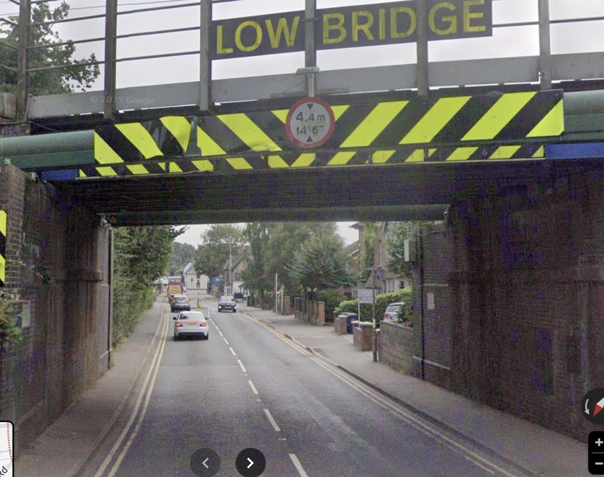

On approach to some low bridges, there are gantries with chains set to the bridge height, seem sensible to put them well before any bridge, so high vehicles have an opportunity to turn around or avoid them, if they put them right in front of a bridge, that seems a bit late, and maybe difficult to see, even, due to the number of bridge strikes.
