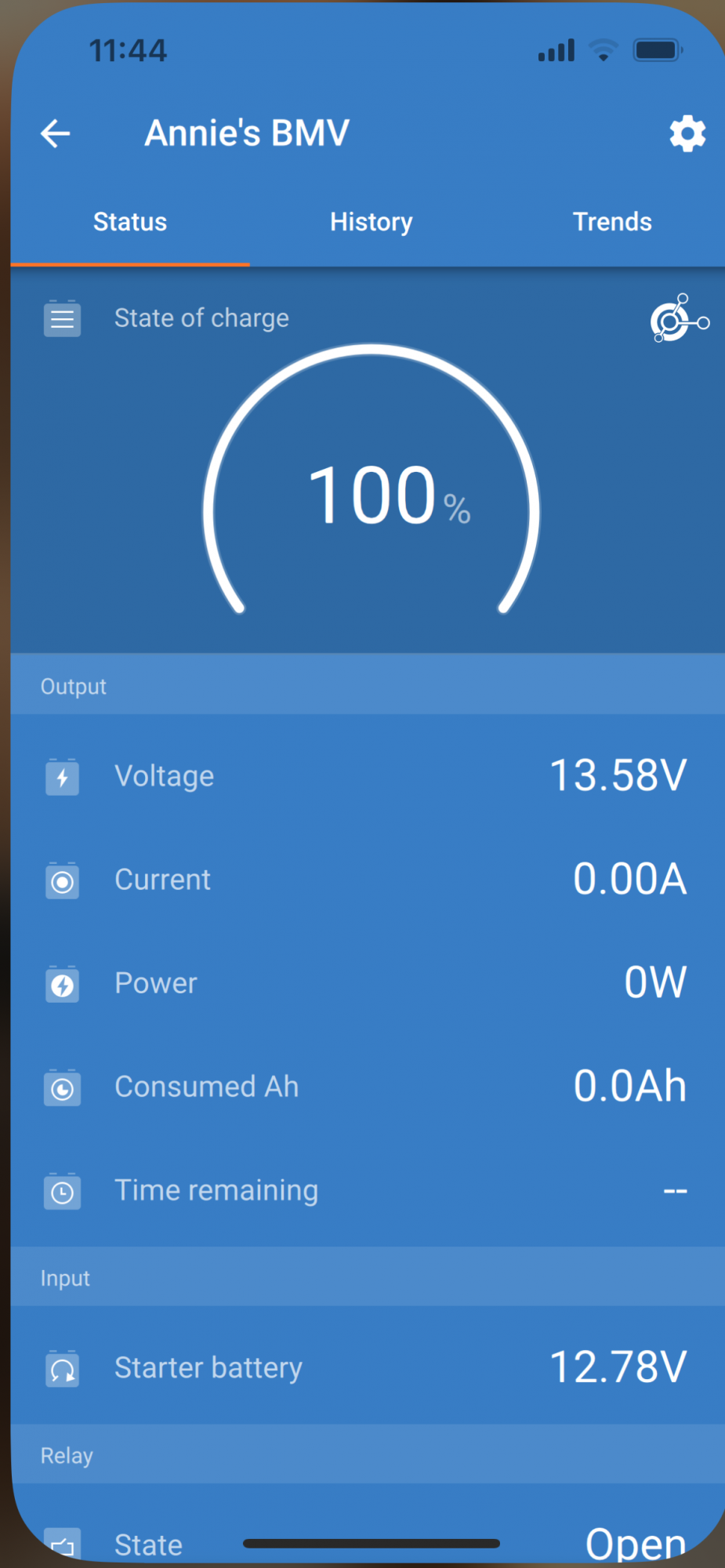

That is very unlikely to be the case.So here’s a thing that has been suggested if the new victron stuff and lithium battery is wired through the vans original system and that system thinks I have gel batteries and so is turning everything off because it thinks my battery is too low would this be possible and is there a solution just putting it out there as it’s all gobbledygook to me.
While driving home the van charged the battery back up to 100%

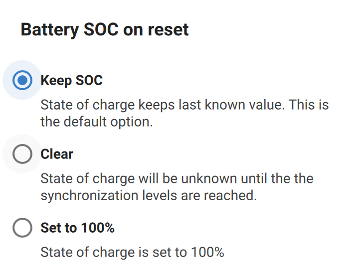

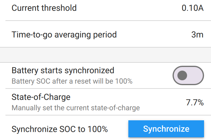

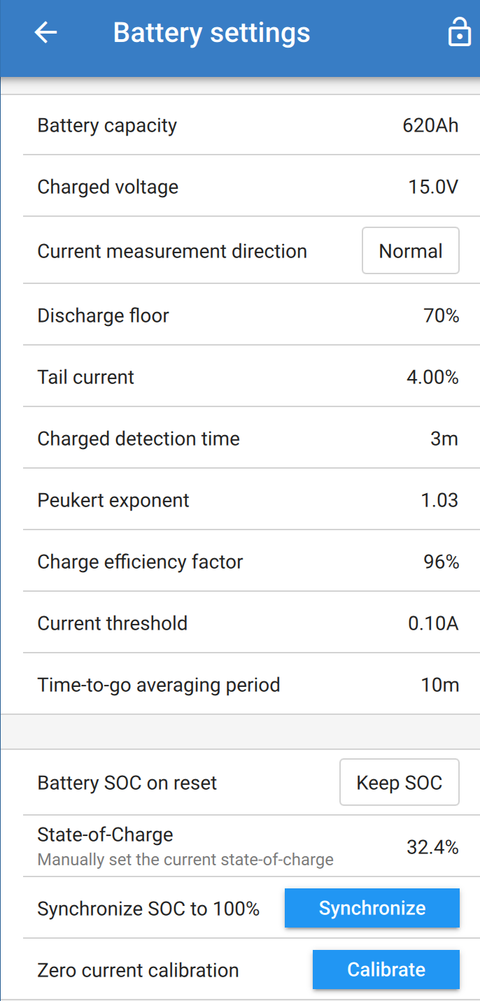

Going back to post #4, did you check the setting for what happens when the Victron BMV-712 Battery Monitor recovers from a power outage?
Below are the three possibilities you will have, and "Keep SOC" is the one you want. If it is on "Set to 100%", then if the battery is turning off, this setting will result in an battery SOC that will be of no use as a guide. Check Post #4 (https://wildcamping.co.uk/threads/victron-lithium-and-12v.101968/#post-1489881) for how to check - and change if neccessary - that setting.

I suspect the Battery Monitor is still set to reset the SOC on 100% on a Power outage and restore - which is resulting in you getting an incorrect and wildly optimistic State of Charge reading - and you are getting to a low battery situation with the running of your non-compressor 12V Fridge.

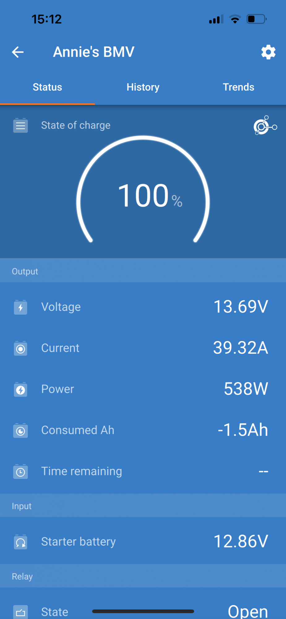

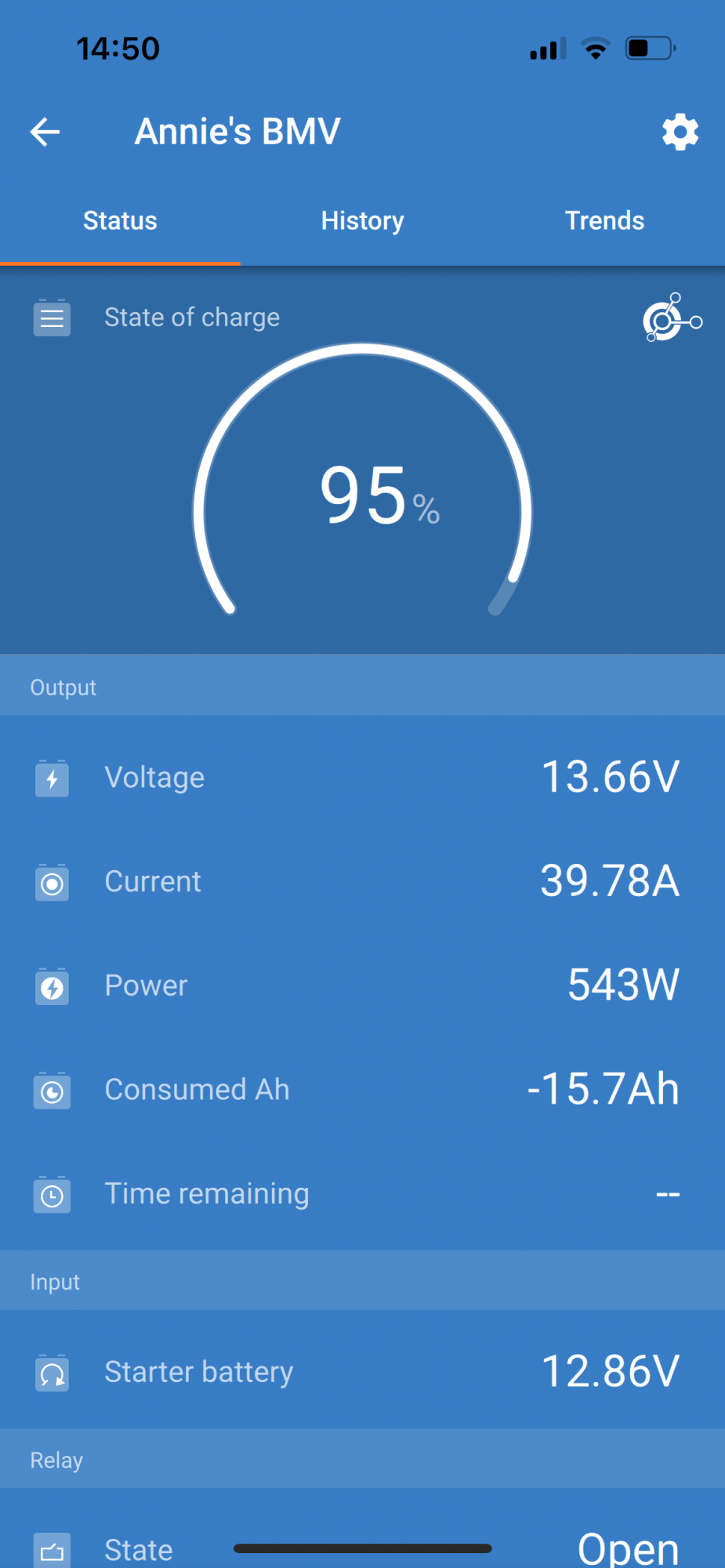

What you could do is unplug the EHU and bring up the BMV Battery Monitor on your phone. Then have a look at the 'Current' value to see how much is being drawn - then turn the fridge on (or off if already on) and look at the difference - this will be the fridge load.
A COMPRESSOR Fridge will be on around 25% of the time at this time of year - maybe less. The 12V simple fridges often run constantly when powered up rather than turn off when at temperature, run at a higher current as well and can kill a battery within hours.
In that same display on the phone, there will be a 'Time Remaining' number in Days and Hours and maybe Minutes. That is the amount of time the battery will last if the current load stays like the number shown.
Turn on the fridge (if off) and then wait a little time (15 minutes ideally for the battery monitor algorithm) and check the 'Time Remaining' entry.
Bearing in mind we think the SOC value is not correct, take that 'time remaining' number, divide it by SOC - so if SOC reads 65%, divide by 65 - and then multiply by 100. That will tell you how long your battery will run the load - including the fridge - IF the battery was full. That will help determine if it is the fridge that is the main culprit to the power loss. (I feel it is most likely, but cannot be positive).

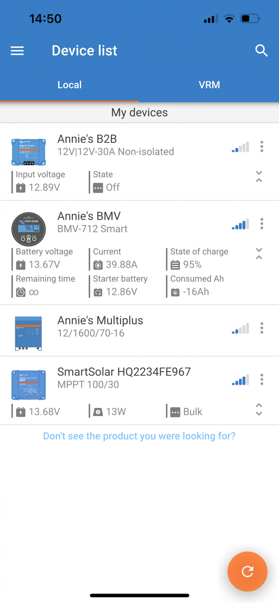

I think you have an iPad, Annie? What you could do if you like is load up the Victron Connect app up on the iPad, then we could have a WhatsApp video call and you could point the phone camera at the iPad screen and we could run through some settings and information if you like? Would want to do this during the daylight hours though in case want to reset any power links or fuses, etc.
