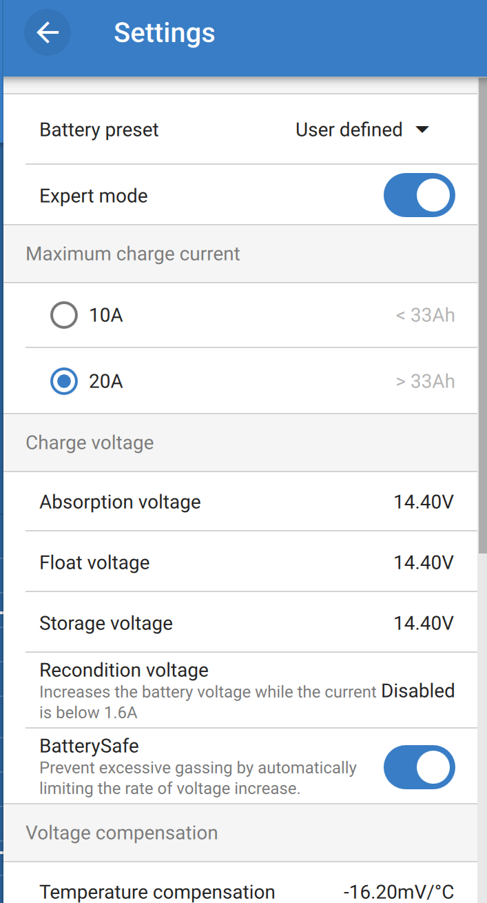

What I would try is instead of using a charge profile, set the voltages for float and storage to the same as the absorption voltage, so around 14.4V. That could be a quick way to get a charge into your batteries from the IP22 before you look into the problem with more investigation later on.
So end up with setting like this ....
To get those settings, go into VictronConnect; click on the gear icon top right.
Then scroll down to 'Advanced Settings' and toggle on.
Then click on the 'Advanced Battery Settings'
In those settings, choose 'User Defined' for Battery Preset.
You can then tap on each of the voltage settings and change to whatever you want.
If you do do as above, I would not leave the charger on overnight or once the battery monitor says 100% or thereabouts. (you haven't said what is telling you the SOC. I am assuming it is accurate, but battery monitor values are at the end of the day just based on maths and not neccessarily a true reflection of the battery SOC).
There can be a conflict between chargers when one is providing an absorption-level voltage (14.4V for example) and so the next charger being switched on doesn't think it needs to do anything so goes into a float mode early. Setting the charger voltages as above could get around that but I would regard that as a temporary workround to get your batteries charged.
