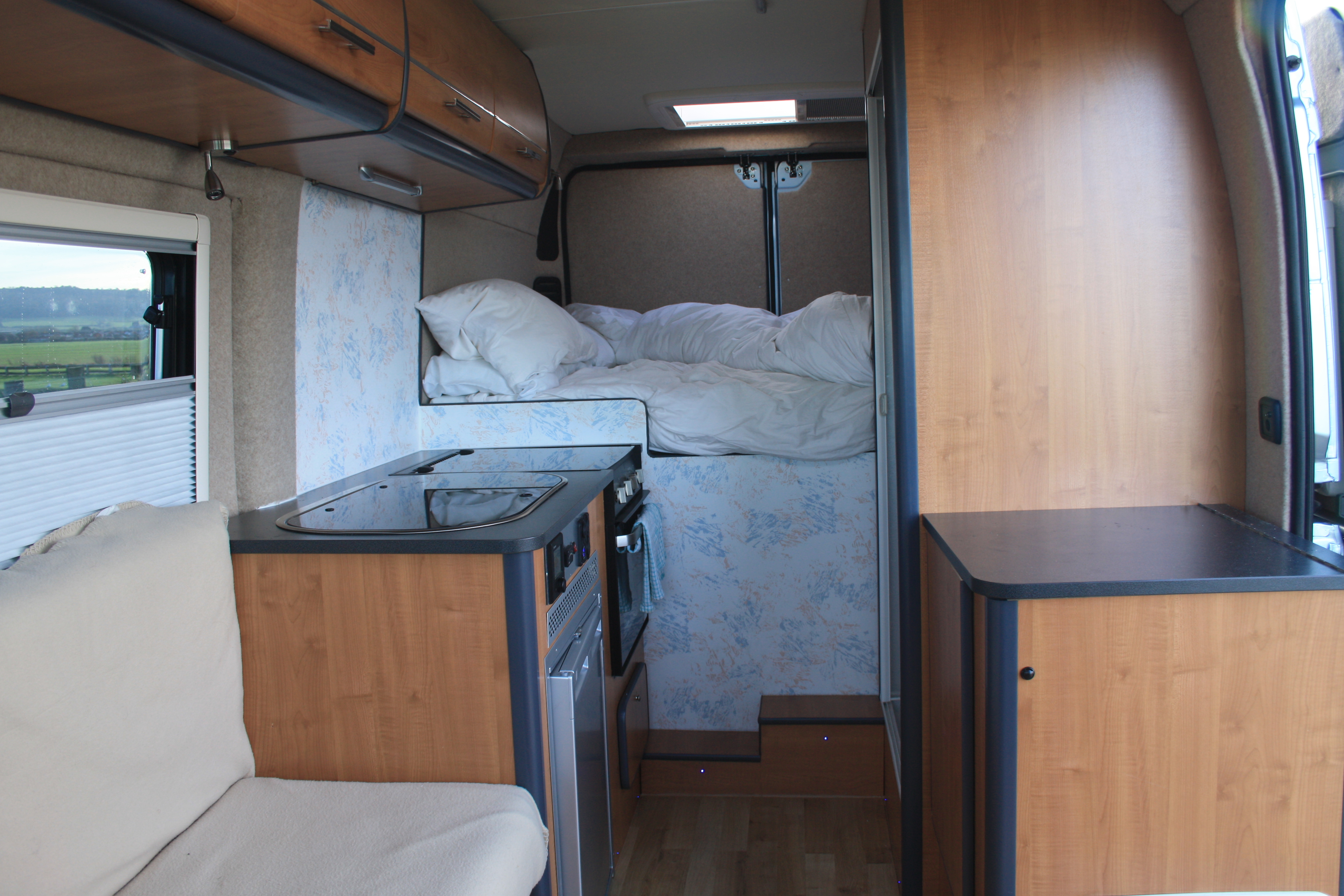

Depends what you want really, best bet is to find the internal dimensions of the vans you like and the equipment you want and do mock up floor plans to see what will fit in and where. If you find a plan you like do a full scale version in the garden using tent pegs and string etc. Also visit a motorhome show to get ideas of what the professionals are doing. Don't forget to take pencil, paper, tape measure and lots of photos.
I chose an L3H2 Sevel because I wanted a fixed double bed, shower, toilet kitchen and seating.
But if I'd combined the bed and seating area I could have got away with an L2H2.
