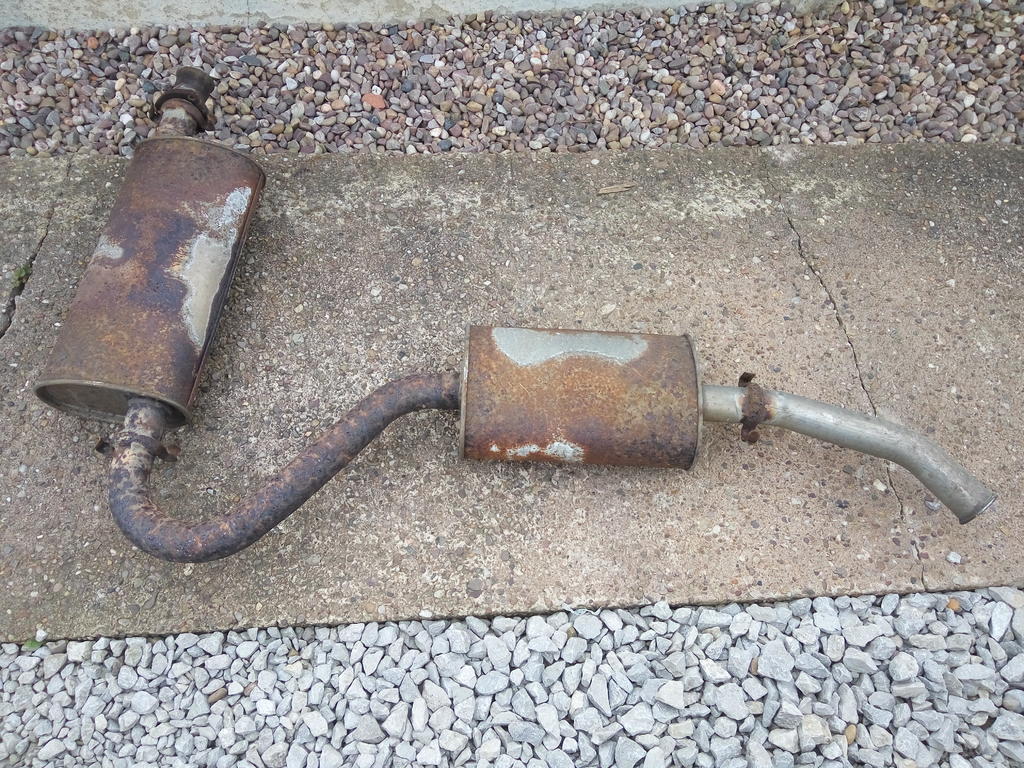

My Hymer is on a 2002 Fiat Ducato 2.8JTD standard chassis, it is LHD so has a continental exhaust exiting on the left, I managed to buy one cheap from Germany but I was told the RHD exhaust was identical apart from the welded on brackets which could be welded on upside down, these are pictures of mine, do yours look similar?
