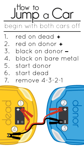

yes i'm sure we all know how to do it , but i bet there's a few who don't 6ZmMfrI.png any how, can't hurt

I would agree.
The initial diagram posted is a great start, but should be used only when also taking into account any specific info for both the car being jumped and the 'donor' car.
(I recall my DS5 had very specific info provided by the battery on where any jump leads can be connected)

The main lesson here is to learn where the connection points are before you need them.
