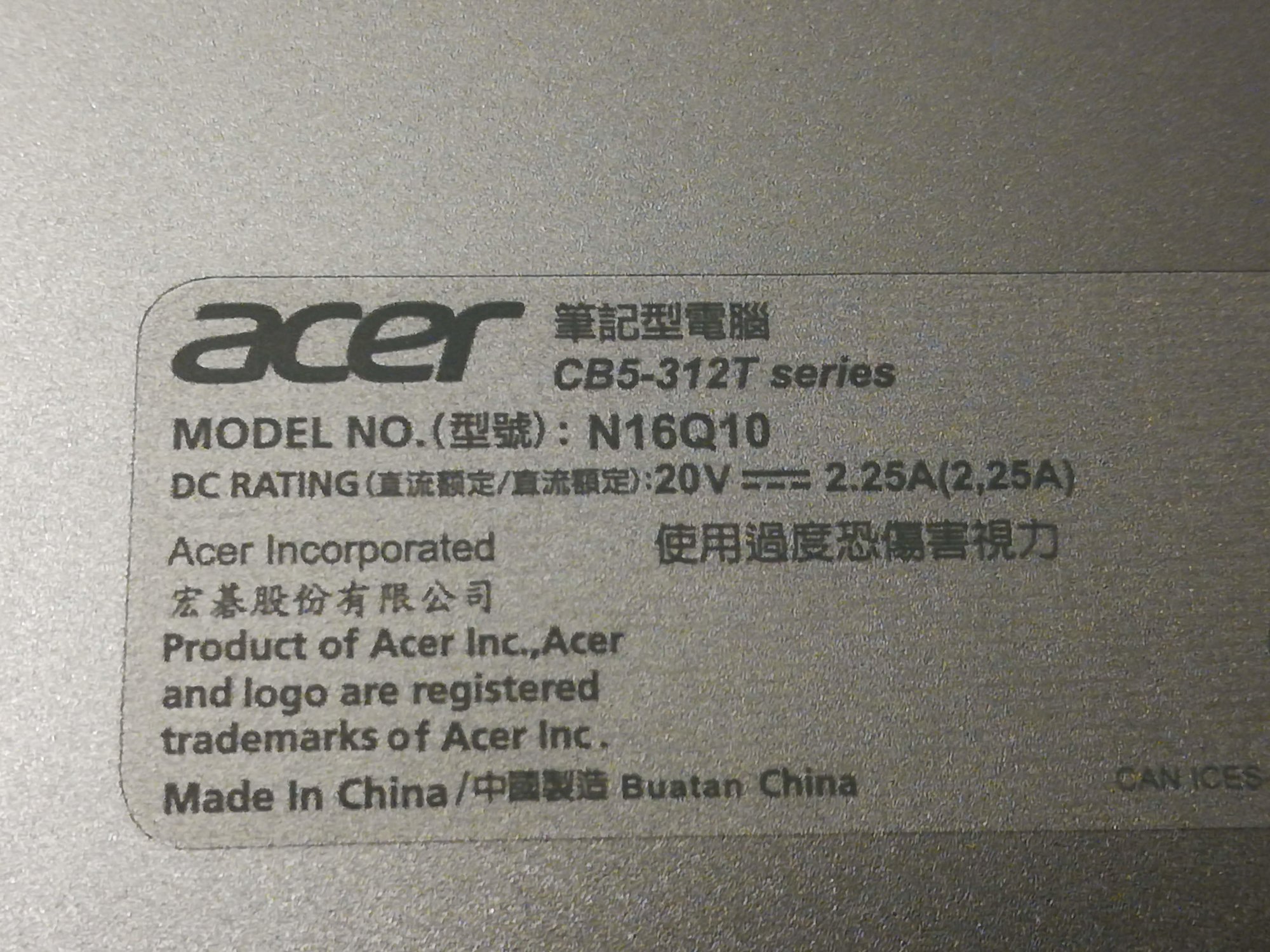

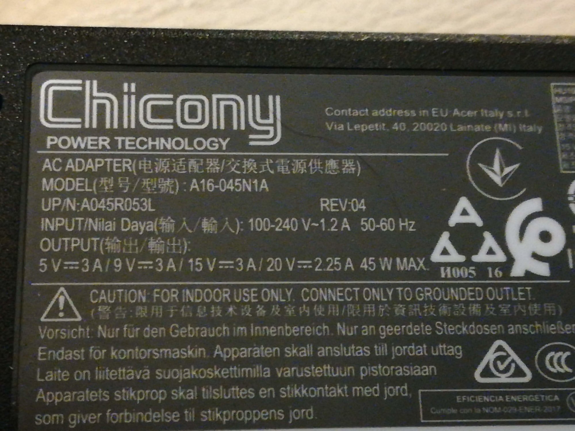

Here's the label from my charger:
And the label from the Chromebook
Guess my Chromebook fulls outside the category of computer. USB-C is a bit modern for me
Does USB-C vary the applied voltage to the device, starting at ~20v to achieve the higher charge current and then reduce the voltage to 5v as full charge is reached?
I think you'll find that the device knows what voltage is required, your adapter provides 3A for 5v, 9v and 15v devices and 2.25A for 20v devices.
Edit: Some devices can work at more than one voltage, my Motorola mobile will work at 5v, 9v and 12v it needs the higher voltage to utilise the fast charge.
