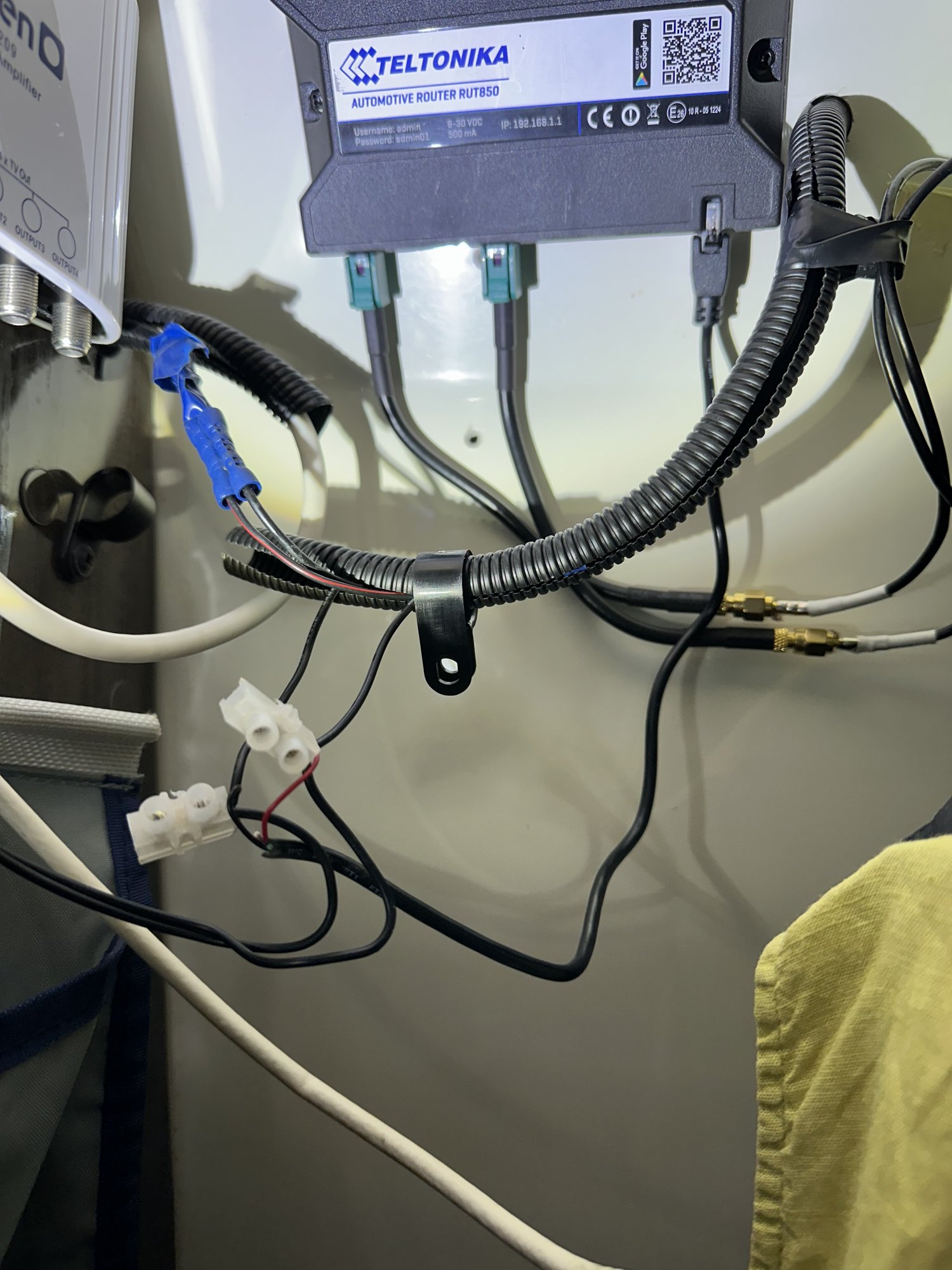

Changing existing modem to one with usb-connection, can I connect as photo and is it easy to distinguish live feed in usb cable?, cheers IMG_0390.jpeg

I cannot make out exactly what you are doing. But remember USBs work on only 5.5v not 12v. If your equipment runs on 5.5v you will require a transformer. The brown cable should be positive. If you wire equipment wrong way round you could damage it, but more likely it just won’t work. If you have a multi meter you can check polarity on it. If the reading has a - in front of it, it’s the wrong way round.

What are we looking at in the photo and which bits are significant?

How was the original modem.powered? What voltage? How was it connected? Was it powered 24/7?
Which connector type was used?
