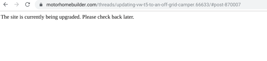

Nice one, was going to write a lengthy reply when this happened....
