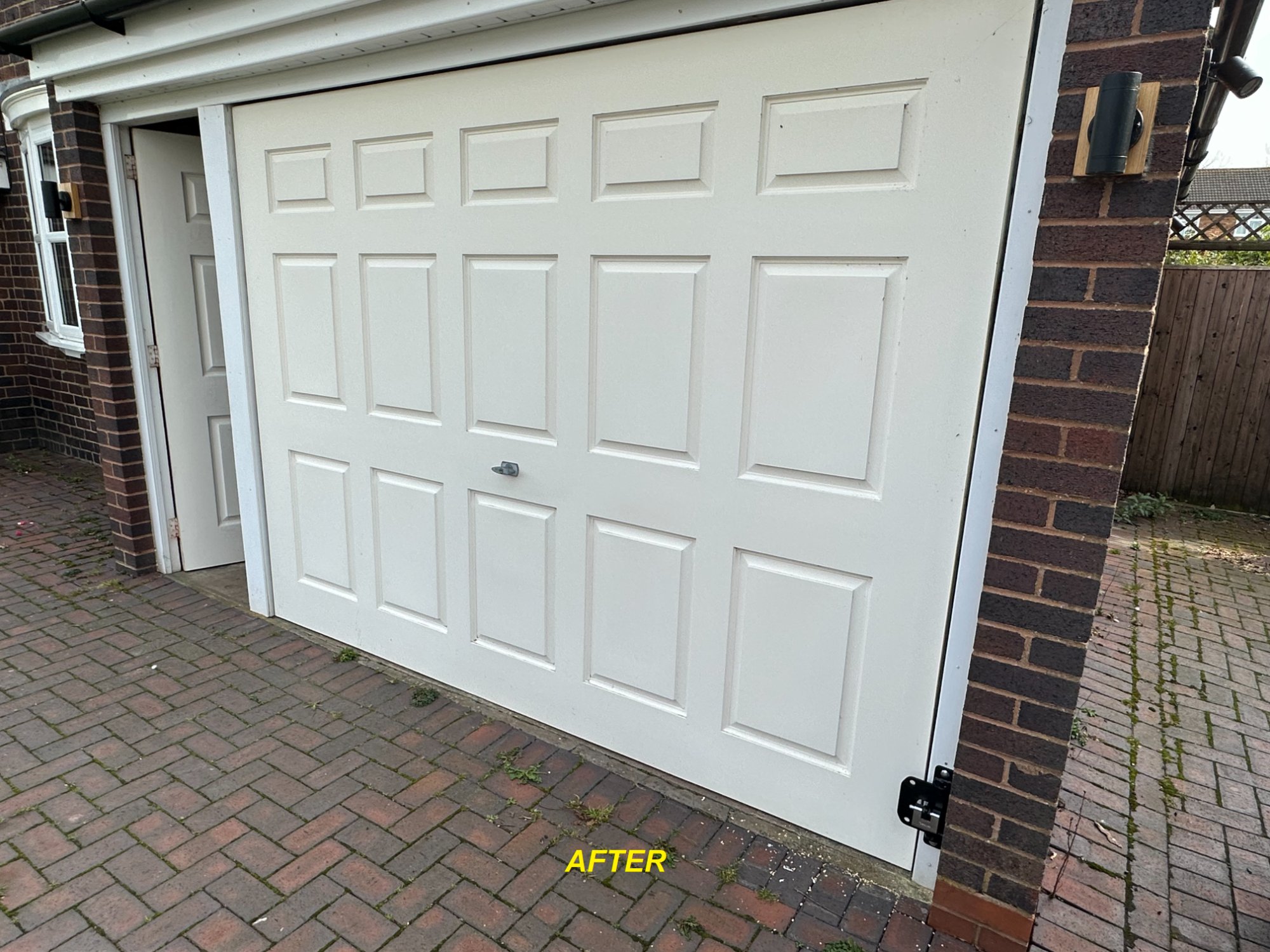

last year following a friends break-in to his garage (the thieves just prized open the up and over door and stole a load of stuff)
So I designed a simple (to fit and use) economical lock to prevent this from happening again
I am selling these on eBay
(if any members want one please message me to arrange a 10% discount)

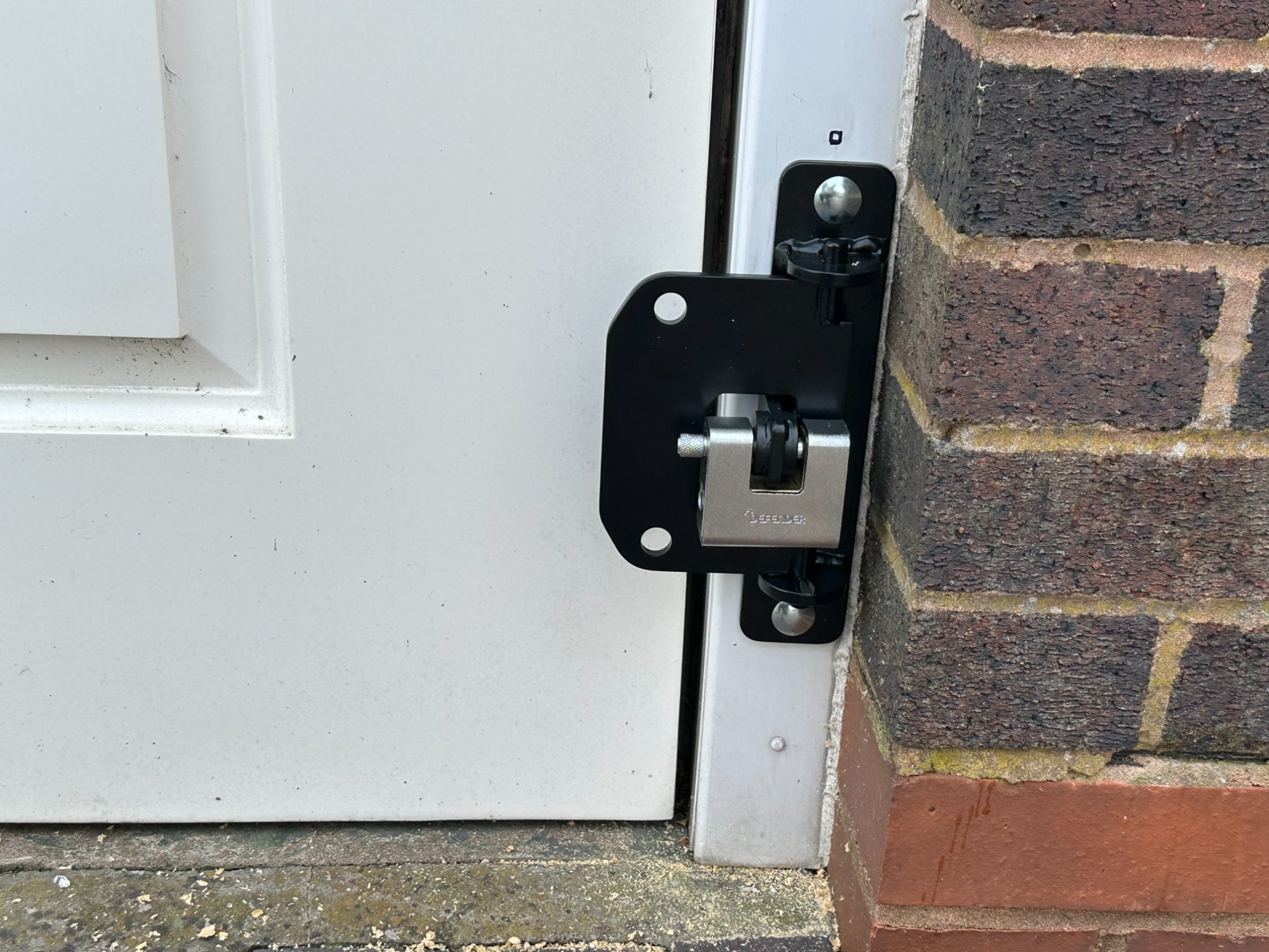

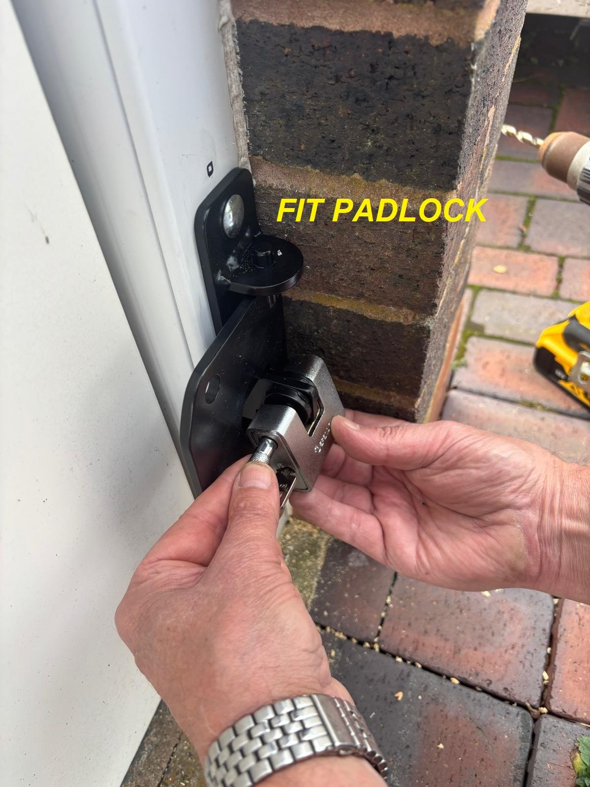

as you know Kev there are many types of security devices for up and over garage doors.
This one is externally fitted to the frame and offers a very robust visible physical deterrent. Which should dissuade the scrotes from having a go at it.. :unsure:
but any security device can be overcome with the benefit of time..
a thief could actually cut through this device, with a cordless angle grinder, but it would take several minutes and also create a helluva lot of noise
a recent customer on Ebay has ordered a pair (for one each side)
he is an electrician and has had scrotes breaking in and stealing his tools
I am looking forward to seeing his feedback

Problem is any kind of security like that is it doesn't matter how strong it is, the padlock is usually the weakest link.
I would be inclined to have the garage door secured internally so it would be impossible to open from outside and concentrate on a secure side door.
Sure, a little less convenient as you first have to go inside to be able to unlock the big door, but what's that? 2 minutes of time?
