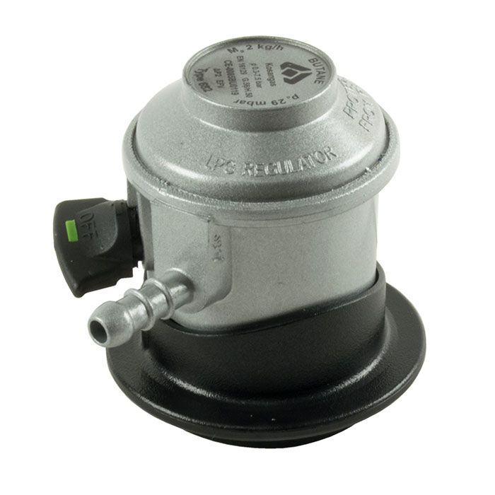

If all that appears to be a regulator is directly connected to your bottle then the hose/pipework disappears into the van it probably is a regulator and then a jubilee clip will do the job as its low pressure after the regulator. But I've one of these which is Only a on Off switch between bottle and regulator Not a Regulator but a lot of people mistake it for one the hose from this is HP and goes to the regulator fixed to the gas cabinet. Your in for a shock if you've never bought english gas after Spanish prices

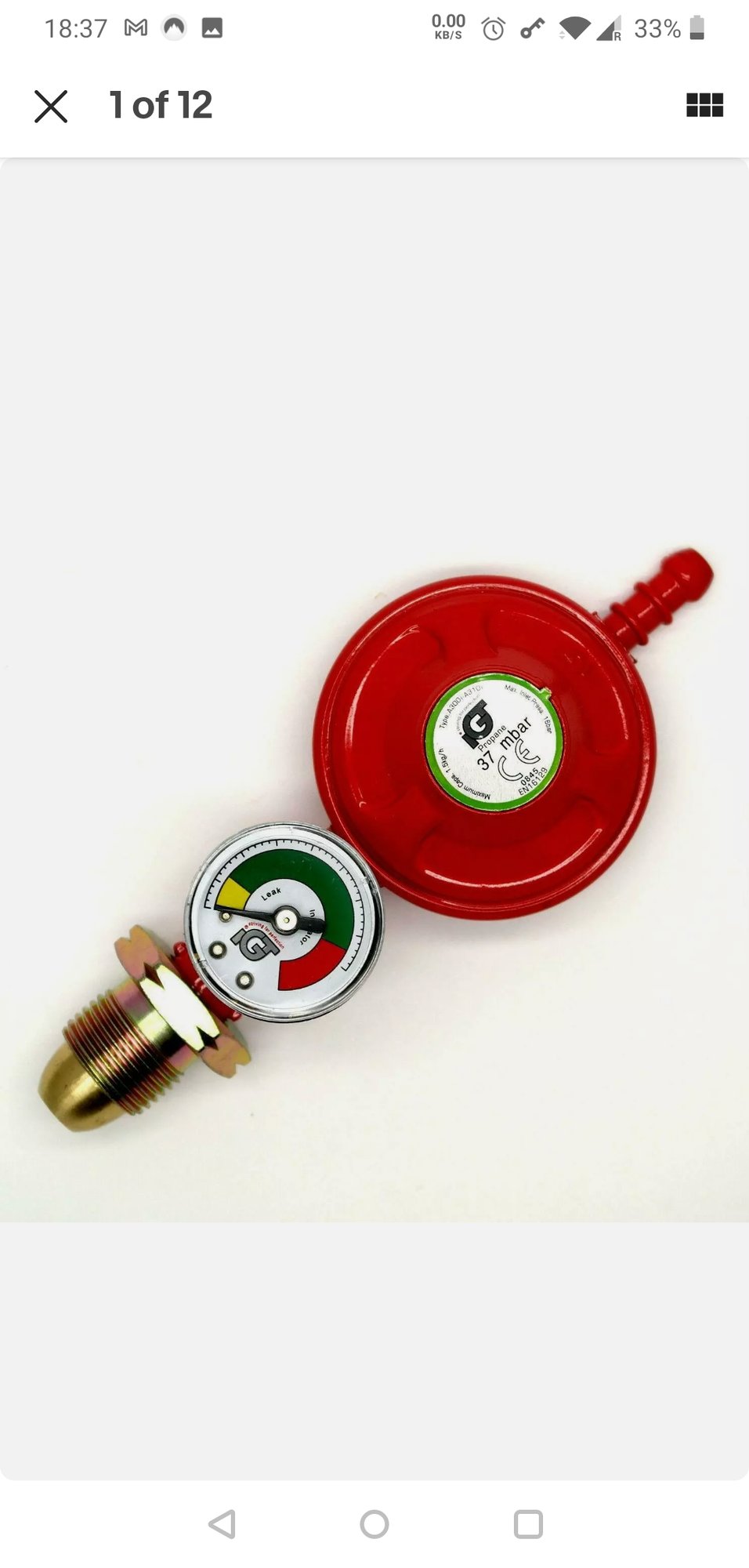

Switch &*************& Regulator

NO not if your Spanish adaptor is just a on / off this would indicate that here is a regulator in line
Before doing any thing you need to be sure what Your Spanish bottle attachment is either a Regulator OR a on / off adaptor as both look very much alike.
can you post a photo of your bottle in position in the van showing hose exiting cabinet I've added picture above that show a regulator now

Currently i have a Spanish bottle with a proper spanish regulator on the bottle (I think its 28 -30mbar IIRC). Low pressure hose in the cabinet without a wall mounted regulator but that's not the issue.

This is what i am thinking i can fit permanently and then when I'm in Spain i can attach the butane on/off adaptor to this
I missed this post on the way through.
Yes this is a propane adaptor so you were ahead of us in choosing the right fuel.
